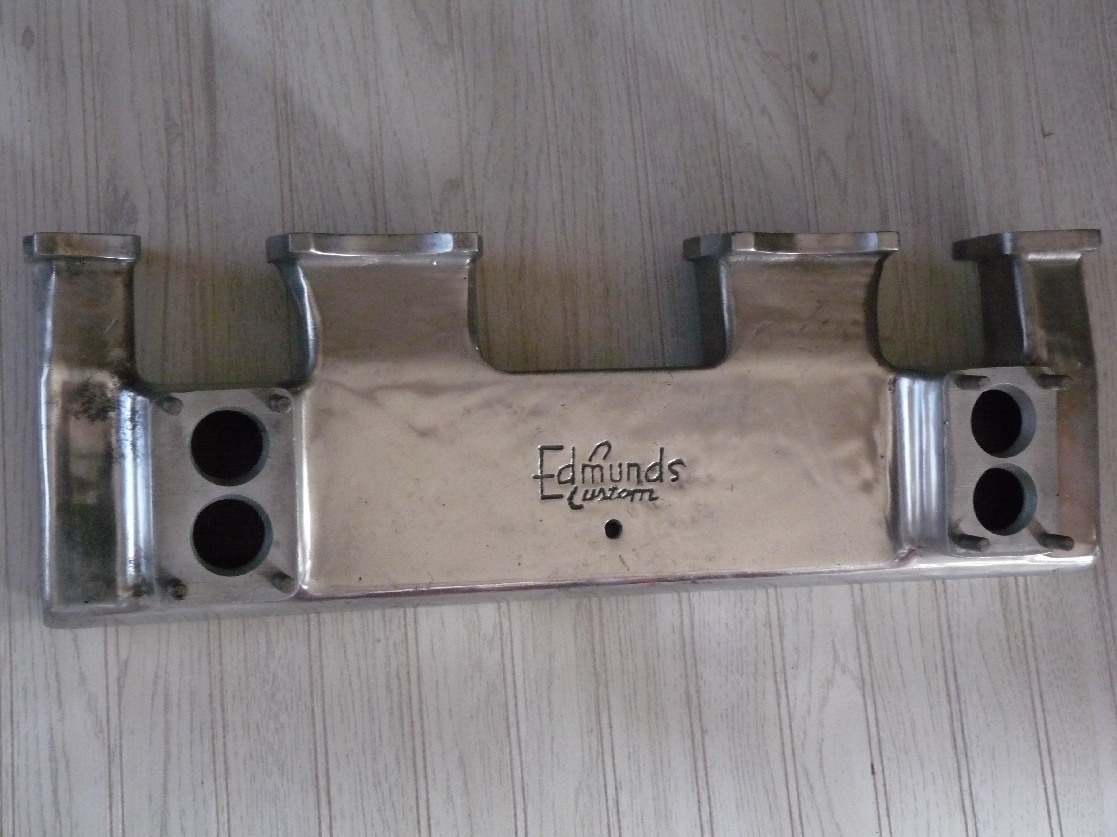

Edmunds aluminum intake
Comments
Ducan,
Thats no problem.. Just go to your local Scrap dealer for a piece of 'weldable' aluminum .125 plate then take the manifold to a Welding Shop to weld a patch over the middle hole(s), but be sure to keep a passage way between the end carbs for equalization. (Maybe your Weld Shop will have a pc of aluminum).
