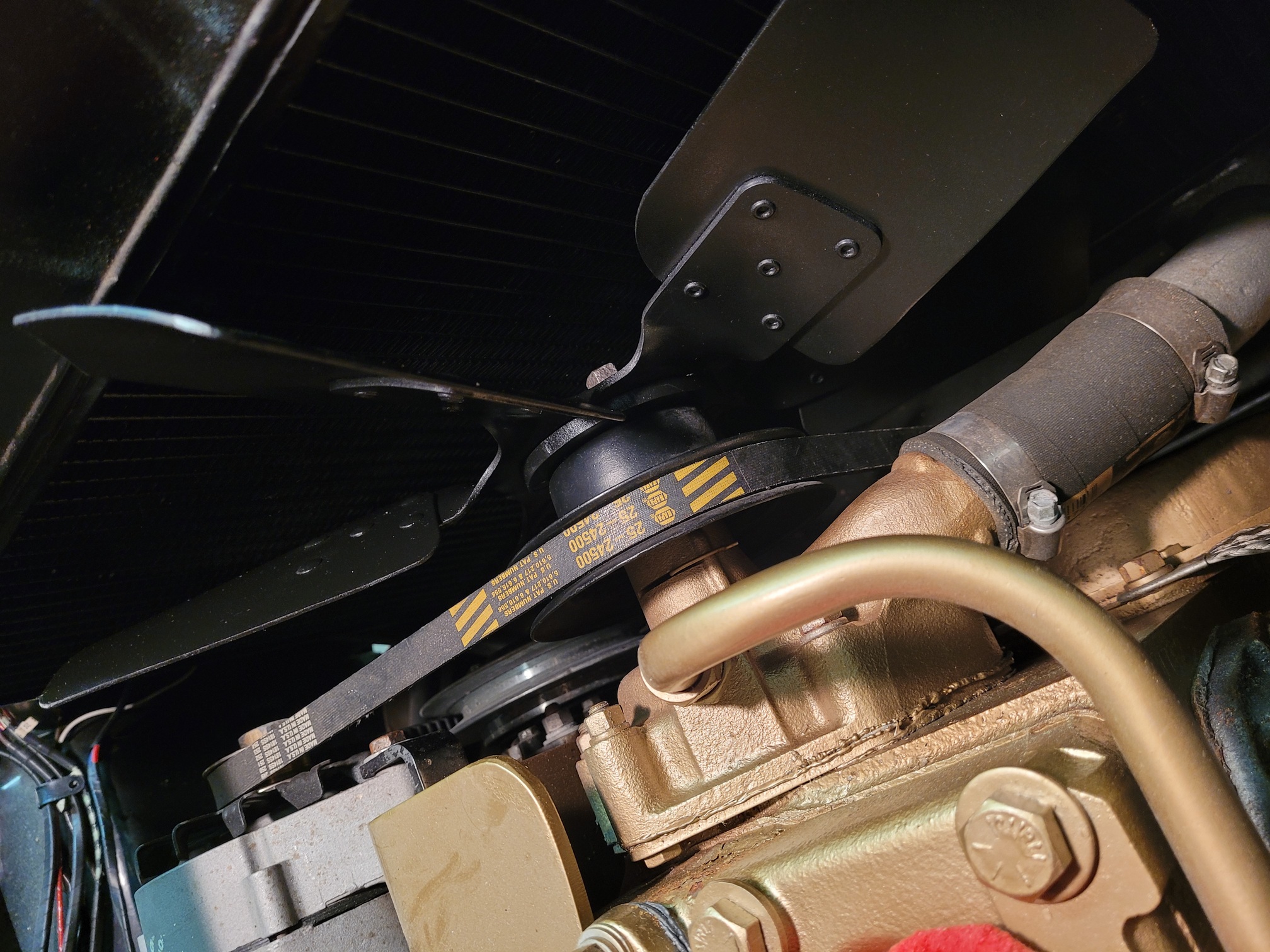

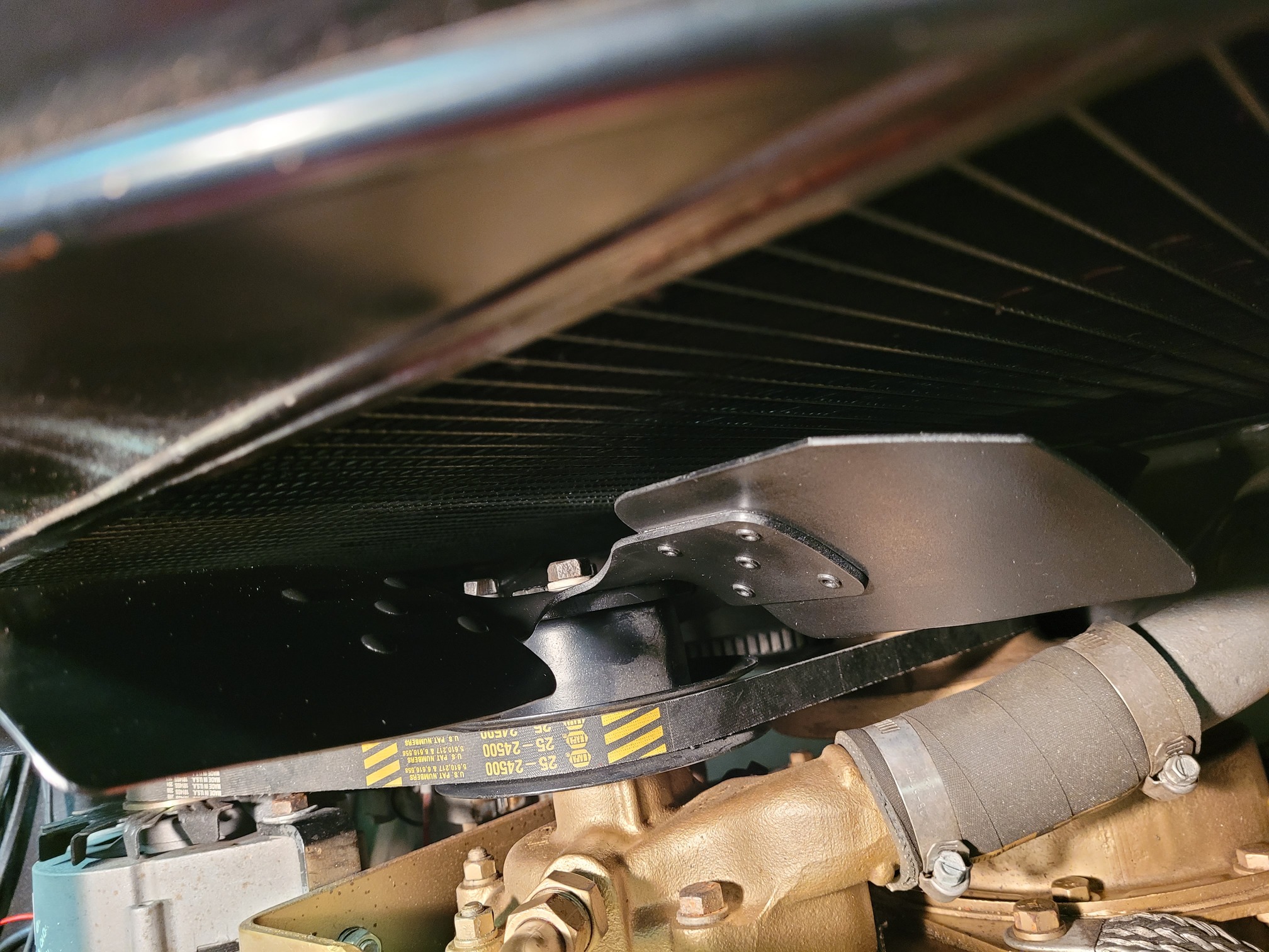

One of the items on my list was actually something I wanted to do initially, a 6-bladed fan as opposed to the 4-bladed stock fan that doesn't move a whole lot of air. I started this project before the restoration was "finished" and got frustrated with it, ran out of time and threw it on the shelf. I figured I would get to it later. Later finally came! It's a universal-type fan and I had to make an adaptor to go from the hole pattern on the fan to the hole pattern on the water pump. You can see the adaptor if you look closely on the back side of the fan. The larger blades were initially going to run into the clutch on the compressor, so I had to back-cut the backside of the blades. After the first blade engineered to clear properly, I made a template to cut all of the other blades to match. Also, after moving the radiator all the way forward, I could still maintain the 7/8" from fan to radiator, so that worked out well. After getting the fan back off of the shelf, it only took me a half a day or so to finish up the engineering. Don't know why I put it off for so long.
Only thing I don't know is how much noise this fan will make. I've been told that 6-bladed fans can be a little noisy. We'll see when she's running, again. I'll make sure to comment on that when the time comes.
