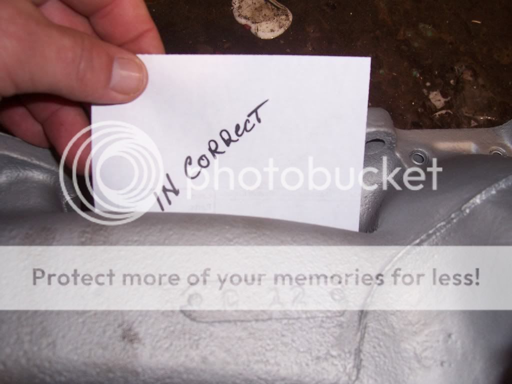

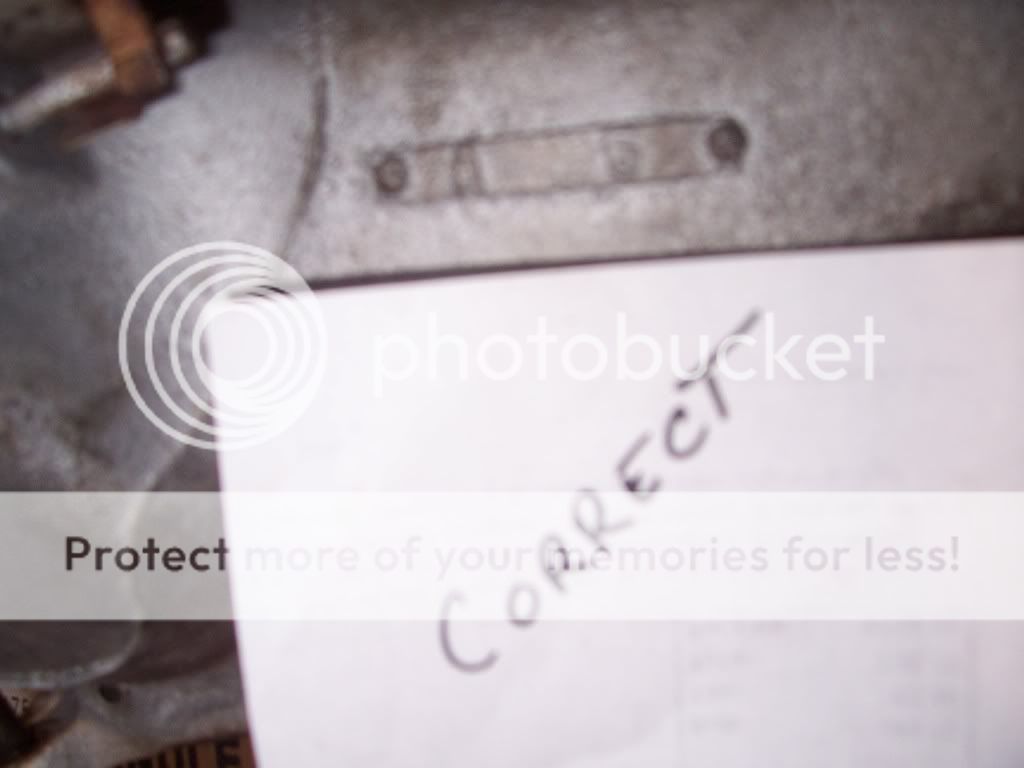

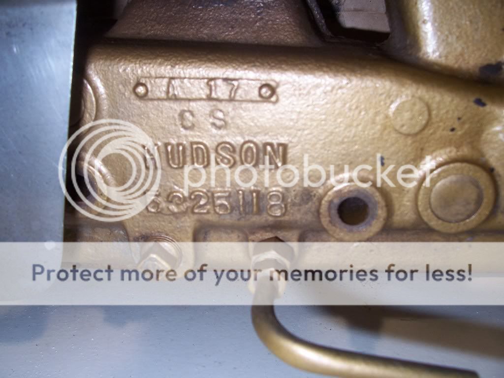

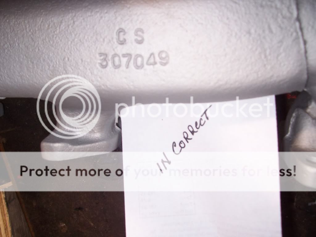

Here are pictures of both manifolds. The correct broken one that he needs to replace and the incorrect one he already powdercoated. To show the difference.
I also have some numbers off of the manifolds etc but the numbers on the original are about impossible to read. If anyone has one of these they could sell me that would be great or like I said at this point this guy will trade his new one for the correct one.

Mike - I think the one you show as incorrect is for the AMC 308, 1955 thru 1957. The one you show as correct is for years 1948 thru 1954 all inclusive (232, 262 & 308). As far as I know, there were no differences in the exhaust manifold for each of the various transmissions.

I think jerry has it backwards, but if he is correct, I'll swap one with him.
the only difference in 52 would be single vs twin H but changing the studs and adding a hole for the choke takes car of it. as they are the same casting0 -
As far as I know, Hudson (AMC) never made a twin exhaust outlet available for the 1955 thru 1957 308 which had 4 bolt patern. The original Hudson 232, 262 & 308 exhaust manifold uses the 3 bolt patern for the exhaust outlet, and the twin exhaust outlet I'm looking at right now has the three bolt patern.
Jerry
53jetman0 -
ok Jerry you're upside down not backwards:D. thats the mating surface to the intake he's showing, not the exhaust outlet.0
Is the intake possibly from a 55-56? It looks like the one pictured has vacuum ports, which I thought were AMC. Does intake have an integrated balance tube?0
nick s wrote:ok Jerry you're upside down not backwards:D. thats the mating surface to the intake he's showing, not the exhaust outlet.
I may be upsider down Nick, but the bolt pattern goes all the way thru, and attaches the outlet to the bottom of the exhaust manifold. It is definately a twin H for the 55-56 & 57 308
Jerry
53jetman0 -

53jetman wrote:
Ok, I went out and looked, I am running the hash manifolds on my 54. There are only three studs to attach to the intake and they do not go all the way through to the outlet. the "incorrect" is definitely not a 55-56 exhaust but that is definitely a 55-56 intake in the first picture.I may be upsider down Nick, but the bolt pattern goes all the way thru, and attaches the outlet to the bottom of the exhaust manifold. It is definately a twin H for the 55-56 & 57 308

Well Fellas there is alot of banter going on ... but here is the real answer: The exhaust manifold the Hudson owner needs in from a Hudson twin H that has the integrated vacume tube... most would immedinately say ... the 55-56 twin H manifold. I would have said the same thing myself. BUT I did some research. The parts books for 52-56 all the individual years and the master parts illustrated books show a 4 bolt exhaust manifold illustration. But for the 55 and up with an integrated tube intake this is correct... dah... look at the pictures. The bottom of the 55-56 manifold will only mate to the three bold varient. The alternative is headers.
See the following pictures: 0
