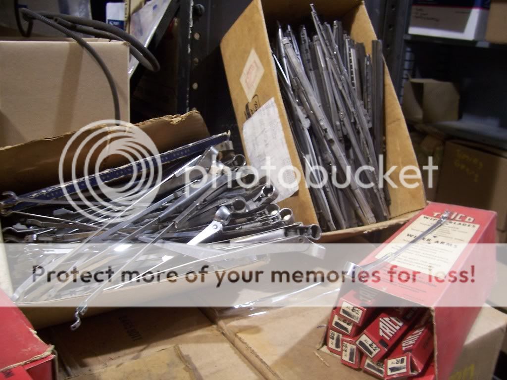

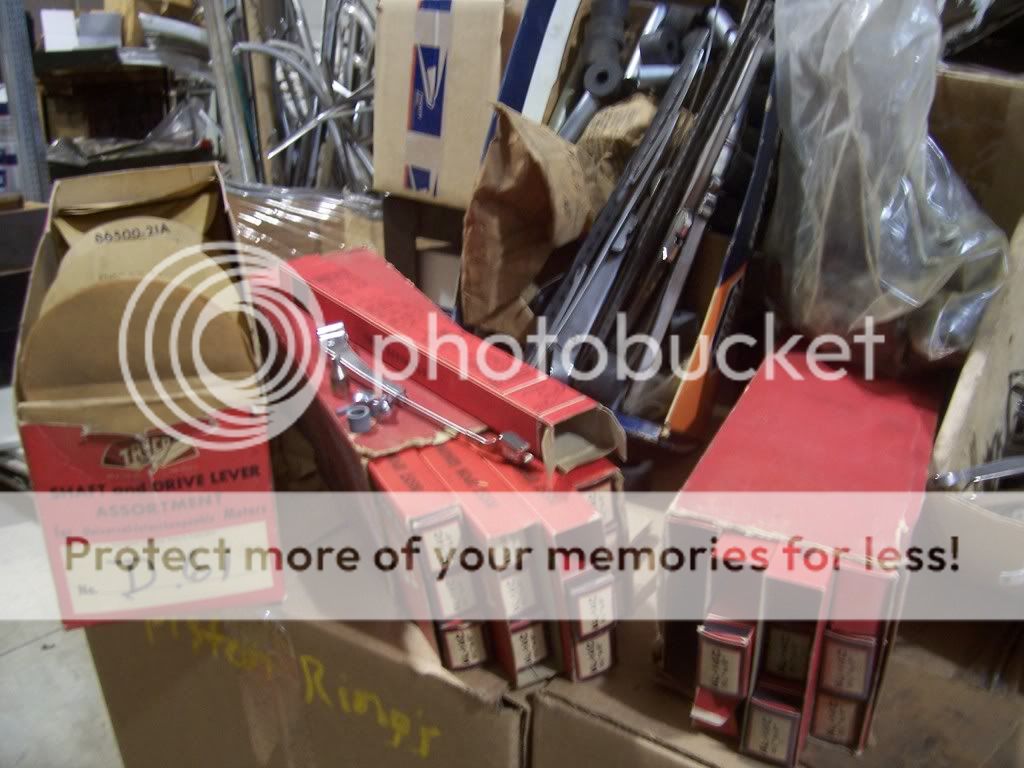

I might know of a vendor.....or kind of a vendor
We have tons of wiper stuff including Trico and Hudson. Problem is most of it isn't in the original box or dosn't have any part numbers etc.
The trico stuff.....I have no info on changeover or crossreference for Hudson.
So the trico numbers mean almost nothing to me.
Same with wiper motors. almost all of them arn't in the box anymore so I can't tell if their new, used or what. Let alone if they work. I really don't have any way to test them.
I do know that we have plenty of refill for wipers altho you probably want new from Napa altho most of the rubber on these seems still good.
But if you need arms and want original Hudson or ones that match send me a picture, or measurments something that I could match up to what I have and you might be pleasantly surprised.
We also have transmissions I guess they call them? the chrome part that you can see outside the car. Some are NOS and perfect but would have to be matched up as well.
Of course the price would be reflective of the situation. For anyone who needs this type stuff or others if your in a position to email pictures of parts like this or others you need I can have the high school kids who help in the afternoons match stuff up.
They don't know part numbers - Hudsons - or parts
But have had some good luck finding stuff for people they never thought they'd find.
Heres just some of the wiper stuff we have here..... If nothing else enjoy the pictures...
