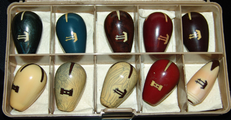

growing up, in the 80's, I used to grab knobs out of the junkyards. I liked saving them, here is my collection of them. Kinda weird, I still got them...0
it's not strange, i would keep them too. looks nice, quite a collection!0
