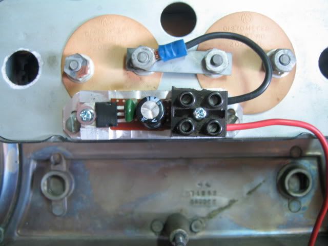

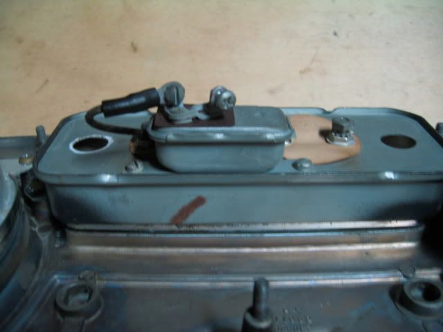

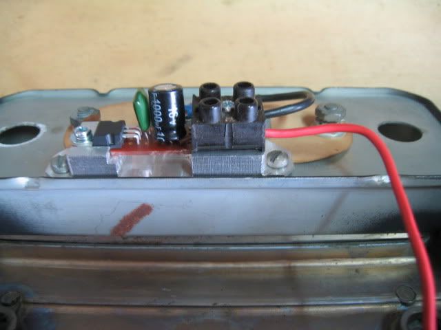

I had the instrument panel out of my 12V 53 recently, and while I was at it I made and installed an electronic 12V to 5V regulator to feed the fuel gauge and temperature gauge as a replacement for the old mechanical 6V regulator.
These devices can be made to handle much larger loads, I'm thinking of fan motors and overdrive solenoids here.
The Hudson regulator
A handful of off the shelf components, plus a small piece of aluminium to act as a mounting block
The new one in place. I made the mounting block to fit the old screw holes
Bob:
Thanks for sending the pictures and showing the how to. How about a wiring schematic and a list of components? That is a really neat way to get the job done. Thanks for sending and sharing with us. Bob P.0 -
