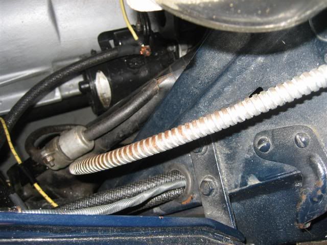

The 1937 Hudson is well on its way to being rewired by Essex4.
Lots of hours in prepration and execution. Note in top of pic the woven black loom covering. The '37s do not have a color code in the wiring diagram so the colors of a stepdown are being used.
On the drivers side of the car , below the speedo cable, we used a hole saw to enlarge a place for the wiring to go thru the cowl support. By running thru here it is neater for the two wire looms and the armored headlight cables.

Just wish to report the rewiring is completed. Essex4 can do the job!
The lights, horn , turn signals, dash lights , fog lights, everything works.
There were seveal fires waiting to happen in the old wiring and one serious melted light harness. If you car has old wires it should be on your soon to do list.
