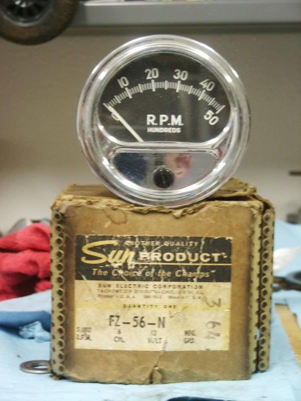

Here's the one I picked up at a local swap meet for my 308 powered 49 C8.
Haven't installed it yet and hope it plays well with the Crane ignition.0
