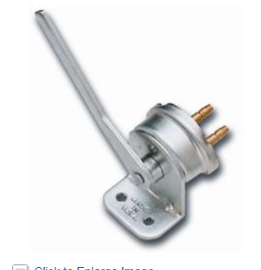

It is a lever switch that is below the brake arm ; you can see it if you look under the hood behind the steering column. I bought a new one from Summit # RFW-SW62 for $19.55. You definitely don't this not to work correctly.
THANKS! I love advice that includes a part # !!I have no switch at all on this project build so I couldnt picture it.0

That is the one I am targeting.How about a picture on a car guys?greedy?0
Richard, that switch looks like one for backup lights.0
definitely called a brake light switch on several sites but could also activate a backup circuit if near a shift linkage.0

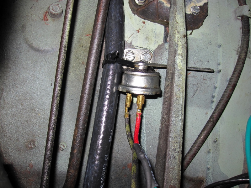

The Brake light switch in its location on my '53 Hornet. Speedometer cable on right; the hose that is fastened to the switch is the line going to the remote brake fluid reservoir on the firewall to the master cylinder.0
Nice switch installation for a stepdown and it eliminates the failure of the pressure switch with the silicon fluids.0
Great picture, THANKS. Now I can see how the lever interacts with the pedal. Without the swirch in my hand I couldnt "see" that.0
Also have splice wire (with applicable diodes) in the brake '+' wire that goes to the front parking lights allowing the front parking lights to be daytime running lights. That is the shrink wrap shown in photo.
