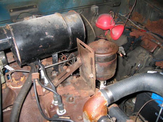

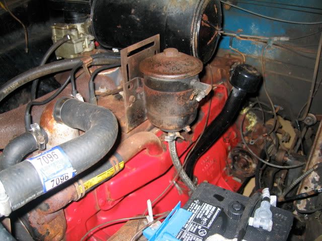

Here are 2 photos of an oil filter mounted on my recently arrived Super 8, the mounting brackets look like an aftermarket one size fits all system.
Like some other posters I have my doubts about the efficacy and even the wisdom of fitting an oil filter to a low pressure oiling system such as the Hudson splashers.
Looking at the oil pump plumbing on this engine it all seems stock, so whatever connections were made to the filter have been got rid of at some time in the past, but this is how I reckon it was supposed to work.
There is a fitting with 2 connections on the input side of the filter. Oil from the pump would have gone in one connection and straight back out the other to the big end troughs. Excess oil, if there can be such a thing in a low pressure system, would have accumulated in the filter. The output, after low pressure and/or gravity filtering drains from the base of the canister back into the sump via a fitting in the filler tube boss. You can only imagine that the volume of the filtered throughput would be absolutely minimal.
The engine oiling system will keep working as long as there is enough restriction in the filter element to ensure most of the oil from the pump goes straight back to the big end troughs. Not having a filter element in the canister would be fatal of course.
One drawback in the scheme is that whenever the engine stops, the oil filter is going to drain, and on start up the initial output from the oil pump will have to refill the filter before oil starts flowing to the big end troughs.
