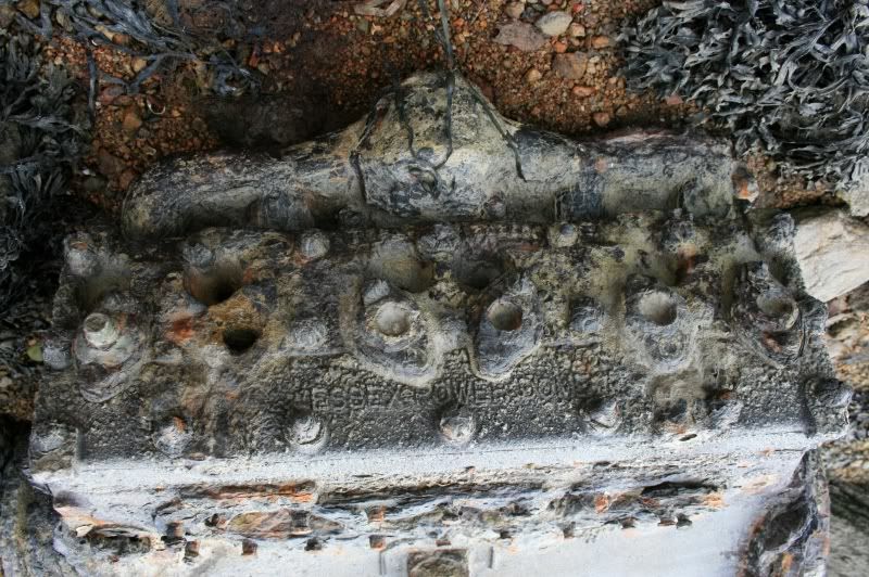

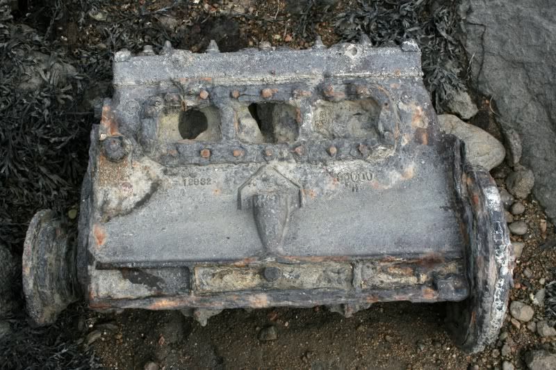

While exploring an island on the coast of CT, I found this old engine block. I was wondering if anyone can help provide more information about it.
On it is written:
Essex Power Dome
12932
37000 H
I don't know much about older cars or engines, but I think it was made by Hudson. Any insight is appreciated.

That's not an engine that's a fossil! Some of the Essex guys on here can tell you more about it than I but I would like to hear a little more about where & how you found it. Clearly it's been underwater for a while.0
What a wonderful yard ornament! I'll make a WAG at 32 Essex.. I bet there is an expert in New Zealand that will nail it..0
Just a little WD-40 in some key places should loosen things up.0
I'm with Dave,guessing that the 12932 is a casting date:Jan. 29th, 1932.
You can see some pics of my 1929,and 1930 engines at the end of this
thread... http://classiccar.com/index.php?option=com_jfusion&Itemid=62&jfile=showthread.php&t=20973&page=2
Nice find! Were's the rest of it???0 -
You guys would be correct in your estimation of 1932. The '31 motor was the first with the reinforcing rib along the bottom of the crankcase (similar to the later 308 motors), but I don't think '31 had "Essex" on the top of the head like this one. What a challenge to get this one running!0
O.k., that's about the most awful engine I've ever seen. Fossil is right . . . looks like it's been underwater for 50 years. It totally shocks me that the writing is still legible.:eek:0
Thanks for the replies. I found it washed up in some rocks on a small island that's not far off the coast of Niantic, CT. No telling how long it had been there. Perhaps it was used as a boat anchor at some point.0
RL Chilton wrote:O.k., that's about the most awful engine I've ever seen. Fossil is right . . . looks like it's been underwater for 50 years. It totally shocks me that the writing is still legible.:eek:
Shame on you Russell, for being shocked by the writing - What??? You never heard the term "Hudson engineering built to last!!!" LOL
Alex Burr
Memphis, TN0 -
Ah heck, clean off those barnicles and you have a good engine! Hudson made them THAT good! LOL0
