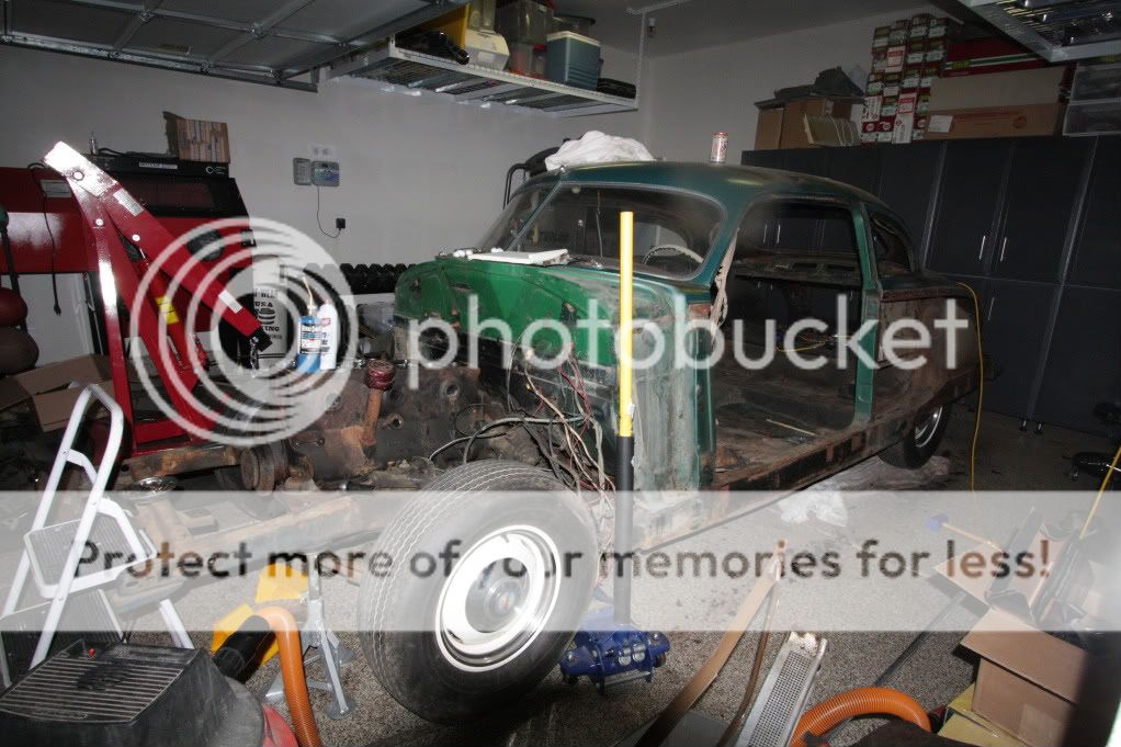

I'm continuing to get deeper and deeper into my first restoration
I am currently stuck in separating the brake and clutch pedals from the lever arms on the engine side. Any ideas are greatly appreciated.
