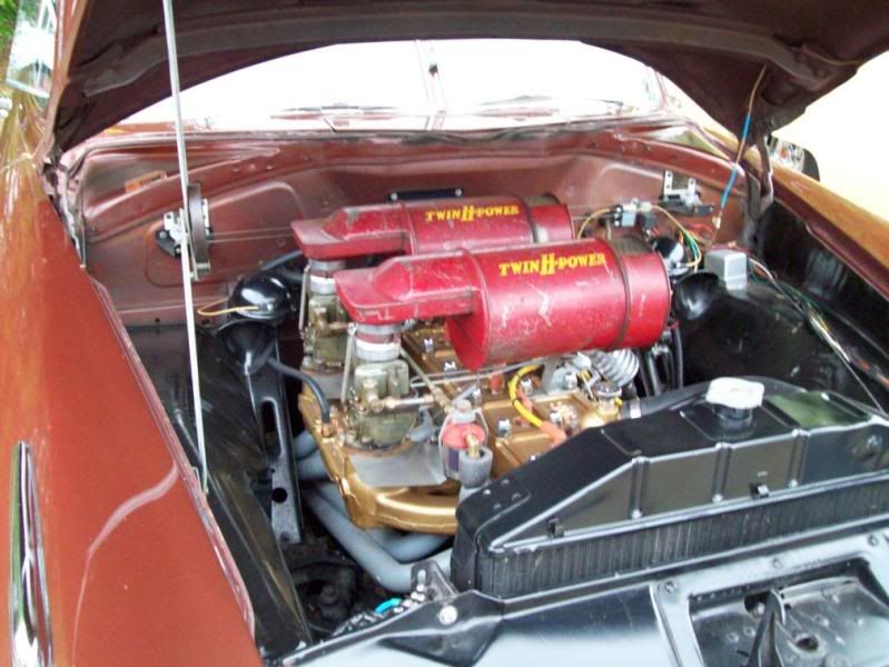

Only downside I can see is an aesthetic one. Acorn nuts, which are really attractive on flatheads could not be utilized, unless someone makes an acorn "cap" to fit onto the bolt head.0
Isn't that pretty!
What finish did you do your intake with ?0 -
Hudson308 wrote:
Yep!! Just like that.0 -
