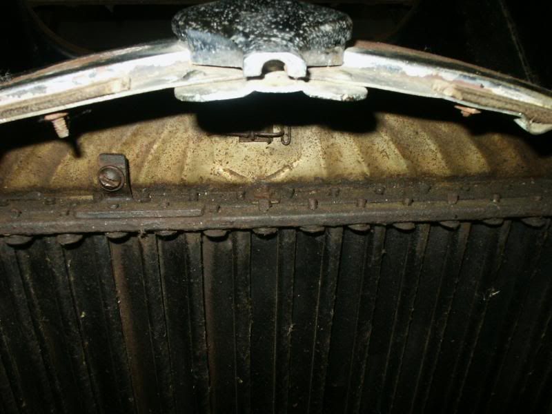

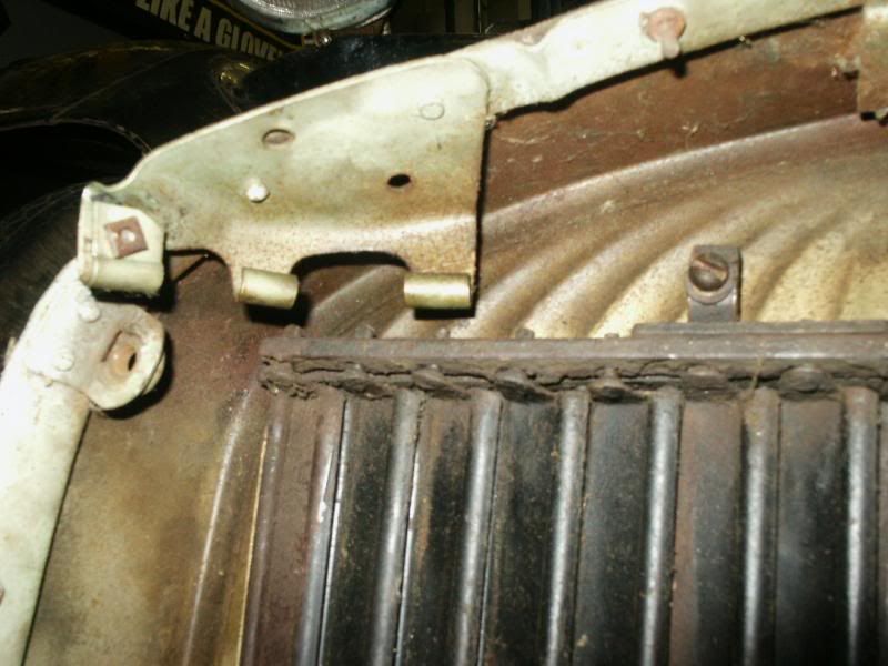

Here's a couple pics of my 30 if that helps any.

This is my 28 Essex in the louvres open position, I think the 29 is the same mechanism.
Get back to me if you want more.0 -
Thanks for the pics of the 28 louvers' operator pieces' this make it a lot easier' tried making the 30-31 mechanism' it could work but needs mods, appreciate the 30-31 pics also, it gave me a starting point. Just need some measurements, width, depth, and length for bracket and measurements of the operating cam, this would be must appreciated.I could take an educated guess from the pics, will try this first, if you could post the mearurement, or email them, please to ptraxler@cogeco.ca

Here's a couple of a 29 Essex recently made available from a member.
