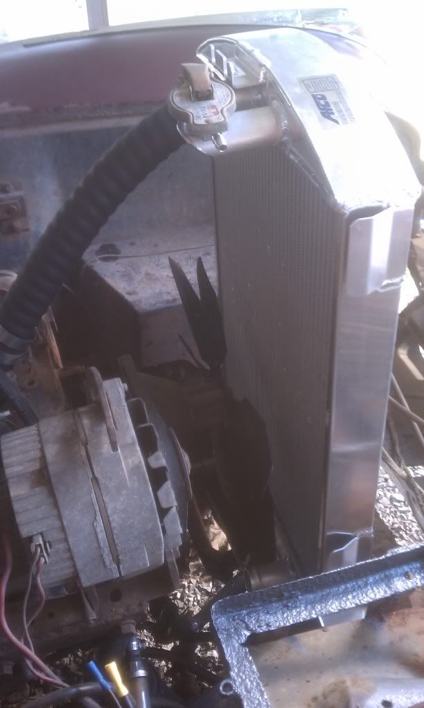

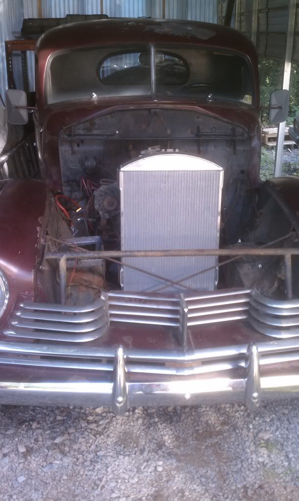

I ended up with Afco unit, it fits like a glove. Who'da thunk? A 32 Chevy radiator fits in the Hudson.
I need to finish the plumbing and give it a try.
