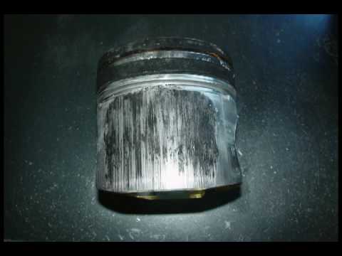

http://www.youtube.com/watch?v=6cLjdr2GSwUEven tho this is not a Hudson but a diesel Cummins 5.9, I thought it might be of interest to some on this forum as it pertains to machine work.
I have been aware of the use of plates when honeing but the demo showing how eaasily the bore is distorted by use of his hands!! good grief. Who woulda thunk?
