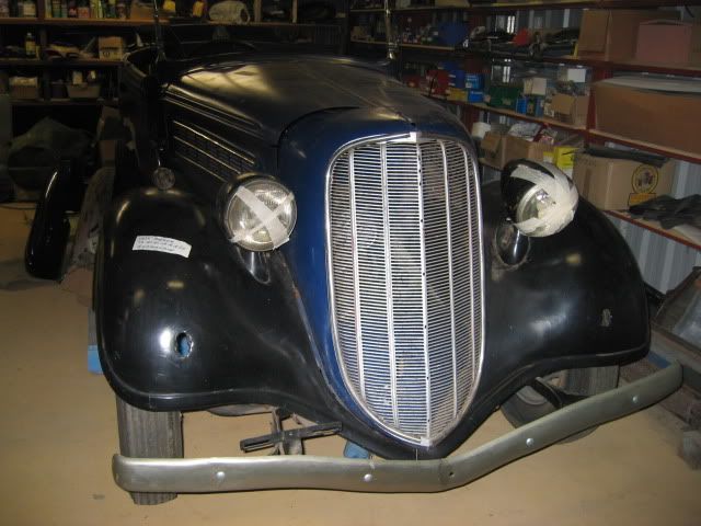

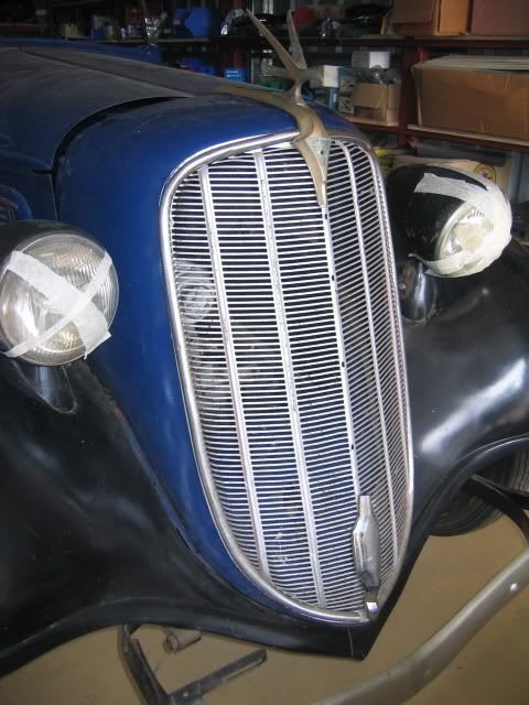

Thanks for the info guys. It looks as though we have another of Hudson's little mysteries here. This is the grille of my recently purchased 35 Hudson 8, but without the expected crank handle hole. I've checked the grille and it is definitely factory, it hasn't been modified.
I wonder if your grille had been damaged at some time in the past, and that a former owner had had someone repair it? Possibly the damage was so great that the entire lower portion was beyond recognition and the person who repaired it did not include the crank hole. Either because he was unaware it was there, or because he was unable to obtain a crank hole cover (the original one having been damaged beyond repair) and just figured that no one would notice the difference.
I can't think of any other explanation, unless this was some sort of Hudson prototype (where the factory was considering doing away with the crank hole)0 -
That is very strange. Do you suppose the grill is an aftermarket replacment? The very top is also a little different..As it has holes for the center strip, that would mean it had a longer center strip also,,,,,hhhmmmm0

hello, what are the holes in the front of the fenders for? is that where the snowplow arms attached?
all joking aside has the front bumper been repaired? perhaps just camera angle.regards, tom0 -

tigermoth wrote:hello, what are the holes in the front of the fenders for? is that where the snowplow arms attached?
The holes in the front fenders are where someone in the past has (crudely) mounted turn signals. The front bumper hasn't been repaired, it does curve down below where the crank handle would normally go.
I like JonB's suggestion that it was some sort of Hudson prototype or maybe a styling exercise, and it has ended up in a kit of export parts when the factory was done with it. That's a much classier story than a mundane incorrectly repaired story.

Had a look through some of the buts and pieces that came with the car, and I'm missing the piece of stainless up the middle of the grille. If anyone has one they can spare, and are going to the OKC National I'll catch up with you there. Please PM me or email r-j-wardATbigpond.com
Just for interest, the hood emblem and bird are very nice brass repros.
