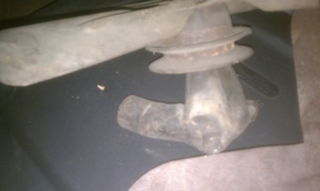

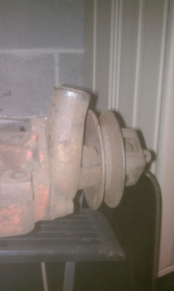

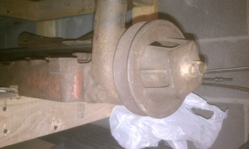

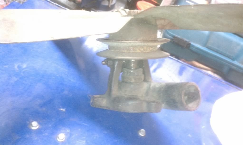

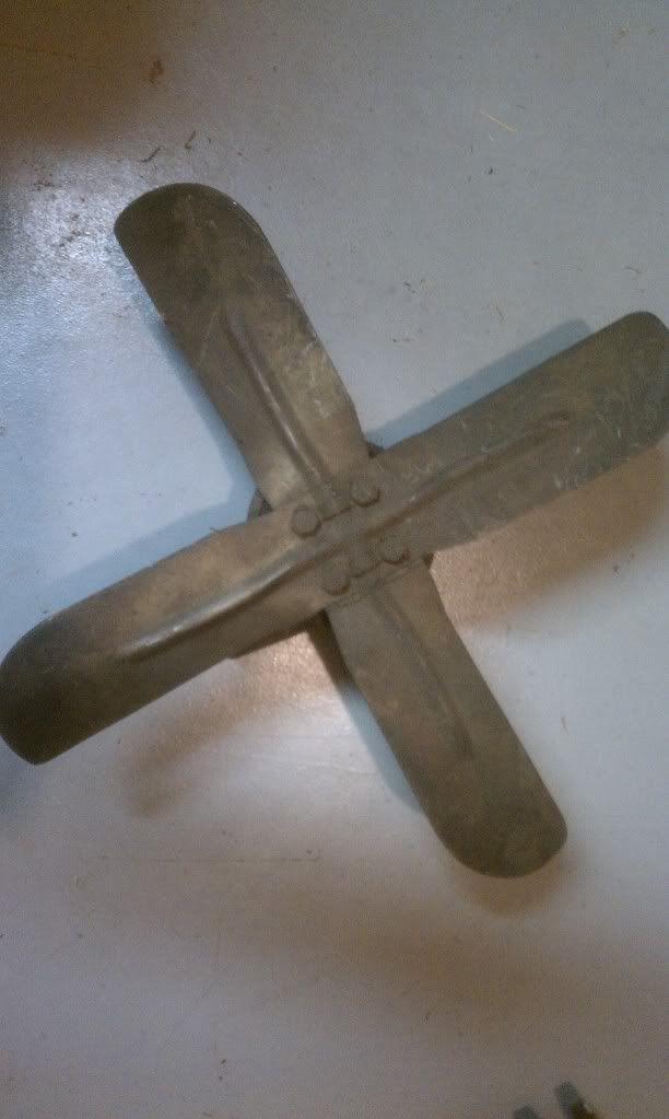

The only missing part to run is the original water pump, pulley and fan.0 -
I have two pumps with my dads engine, not sure which one is correct. The one mounted to the head has been on the engine a long time, so I assume it is original.
