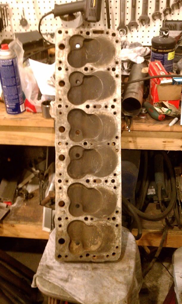

After getting my '53 Hornet back up and running, I have been scavenging through all my fathers old Hudson stuff (a lot of stuff!) and I came across an original 308 aluminum head, looks pretty clean, I know I would need 1/2" head studs, but I wonder if it would be worth it to put on???
Can the block be tapped for 1/2" studs while it is in the car or does it have to be disassembled? I also found what looks like a 262 iron head in his stuff.

Are the 1/2" studs an absolute must have? and what gaskets do you use?0
Hudson308 wrote:zombiescustoms wrote:Are the 1/2" studs an absolute must have? and what gaskets do you use?
The factory went to 1/2" bolts in '55, after using 1/2" studs for a couple years in 7x engines. 51-54 308s can still use 7/16" bolts if you're not going to pound on it. The bolts thread into the block water jacket, so theoretically you could tap it in the car. I wouldn't do that for two reasons; it's tough to keep your tap straight, and you end up with metal shavings in your water jacket. Best to do this on a (BIG!) drill press while doing other machine work to the bare block during a rebuild. Guys here might be getting tired of my preaching the benefits of the "Best" brand head gasket, but it's the only way I've been able to cure head gasket dribbles when using an aluminum or 262 head on a 308.

Yes, BEST head gaskets are available on ebay, about $80 plus ship (not cheap). What do you have for an engine? If it is a '53 then it takes the 7/16 bolt, which your head should fit (assuming it's a pre-55). Regarding 1/2" ARP GM big block studs, there is one length (about 3.5") that approximates the length of the Hudson stud, however, these do not seat all the way on the block, that is there is thread exposed when screwed in to the right height and water will seep by regardless of sealant. I tried these and I got water everywhere. Also, you will need to torque the head down 10-15 more lbs than recommended by factory, a shakey issue with 7/16" bolts. Regarding Hudson 1/2" studs, there were apparently two lengths (I've used both).0
It is a '53 that is .100 over. Does anyone have the exact length and pitch of what the 7/16s bolts should be? Also the length of the threaded portion. I'm thinking of checking with ARP to see if they have a stud that could be used, studs are much stronger as they only stretch on the vertical axis.0
