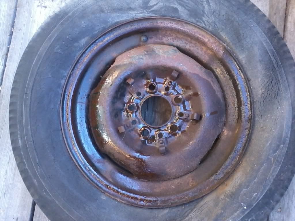

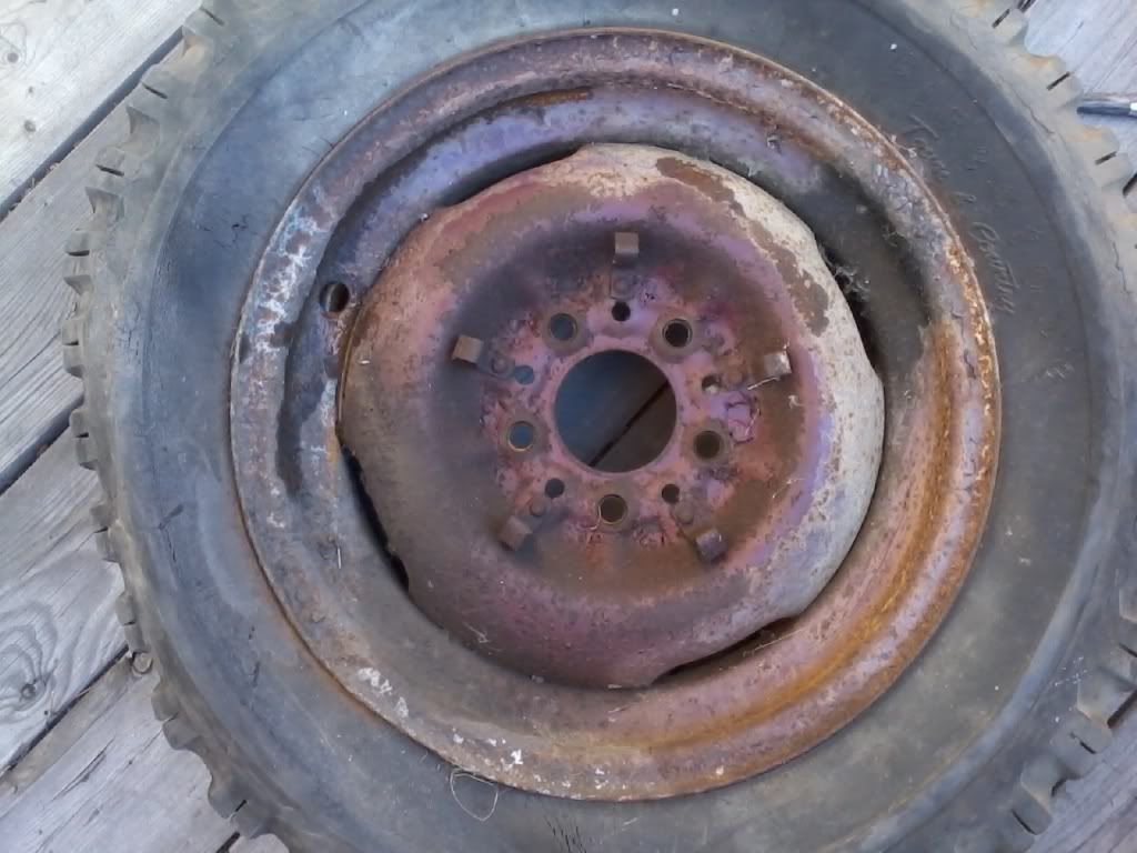

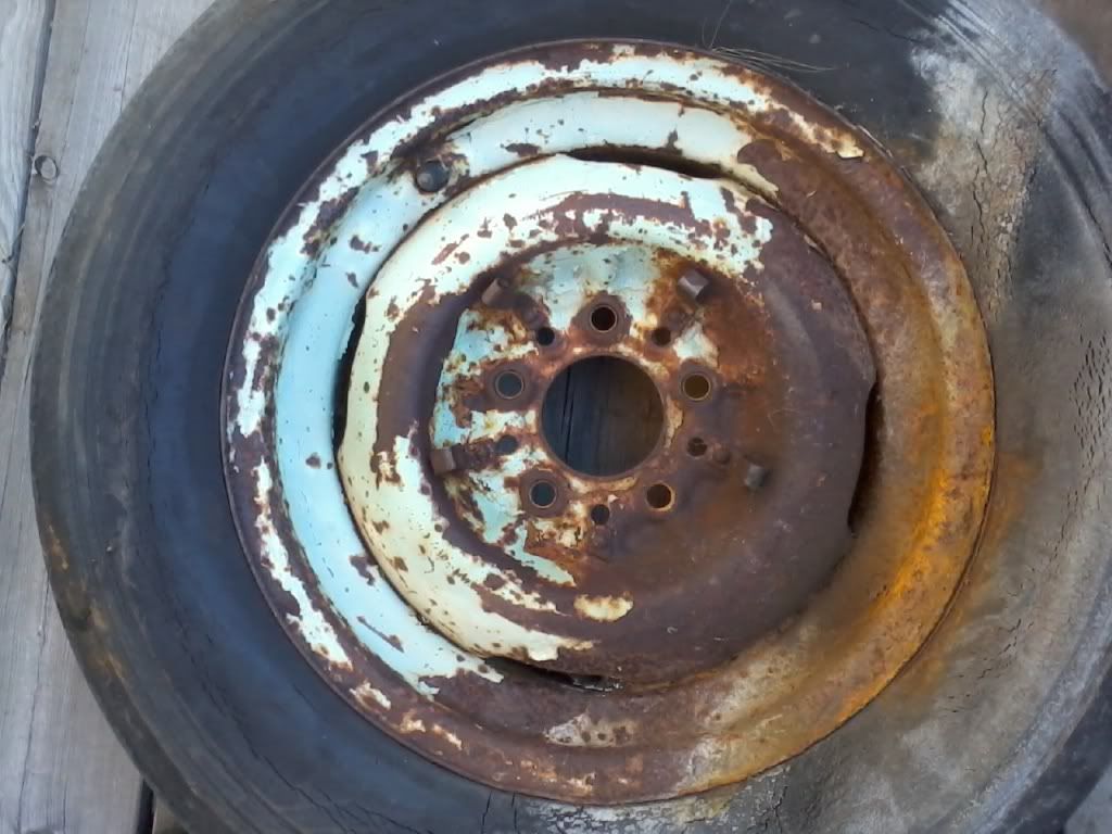

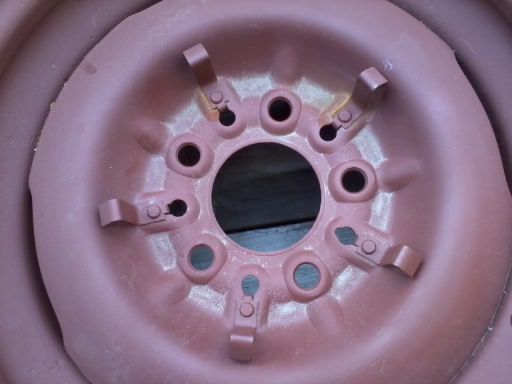

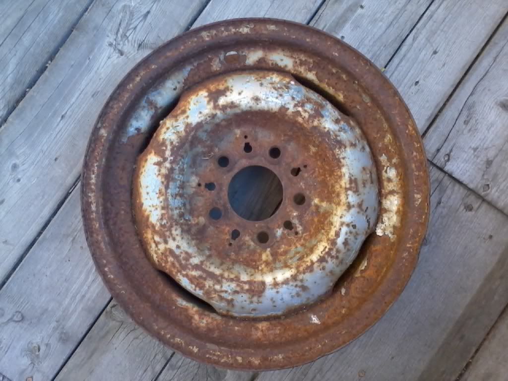

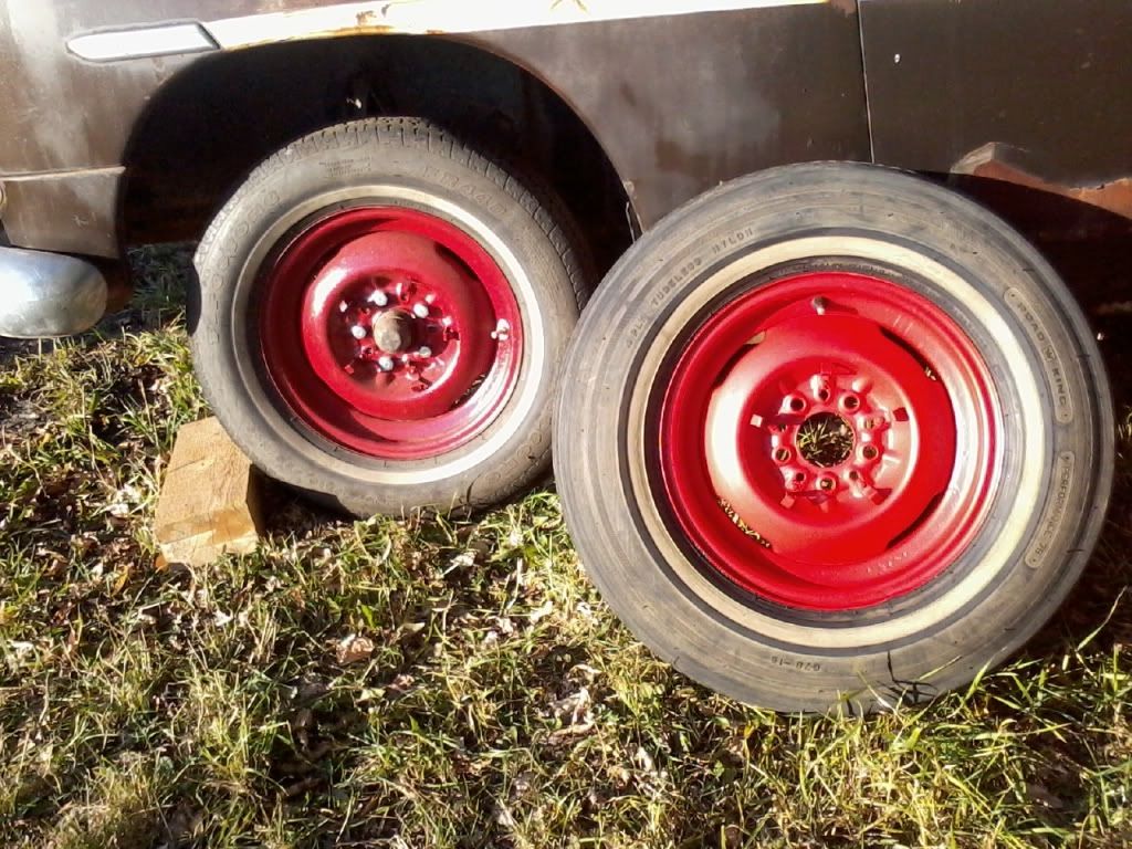

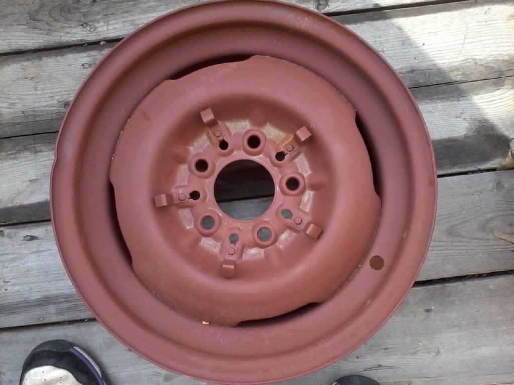

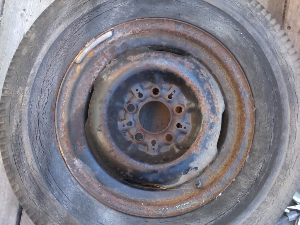

So, This is what I came up with.
Notice how the last one has a different profile on the disc of the rim. whereas the rest have an umbroken curve.
There are a couple that don't have Hubcap clips. Now I'm not a Hubcap guy, so I'm not concerned about them. If you want rims with the clips in tact I can send you the ones I already have blasted and painted.
