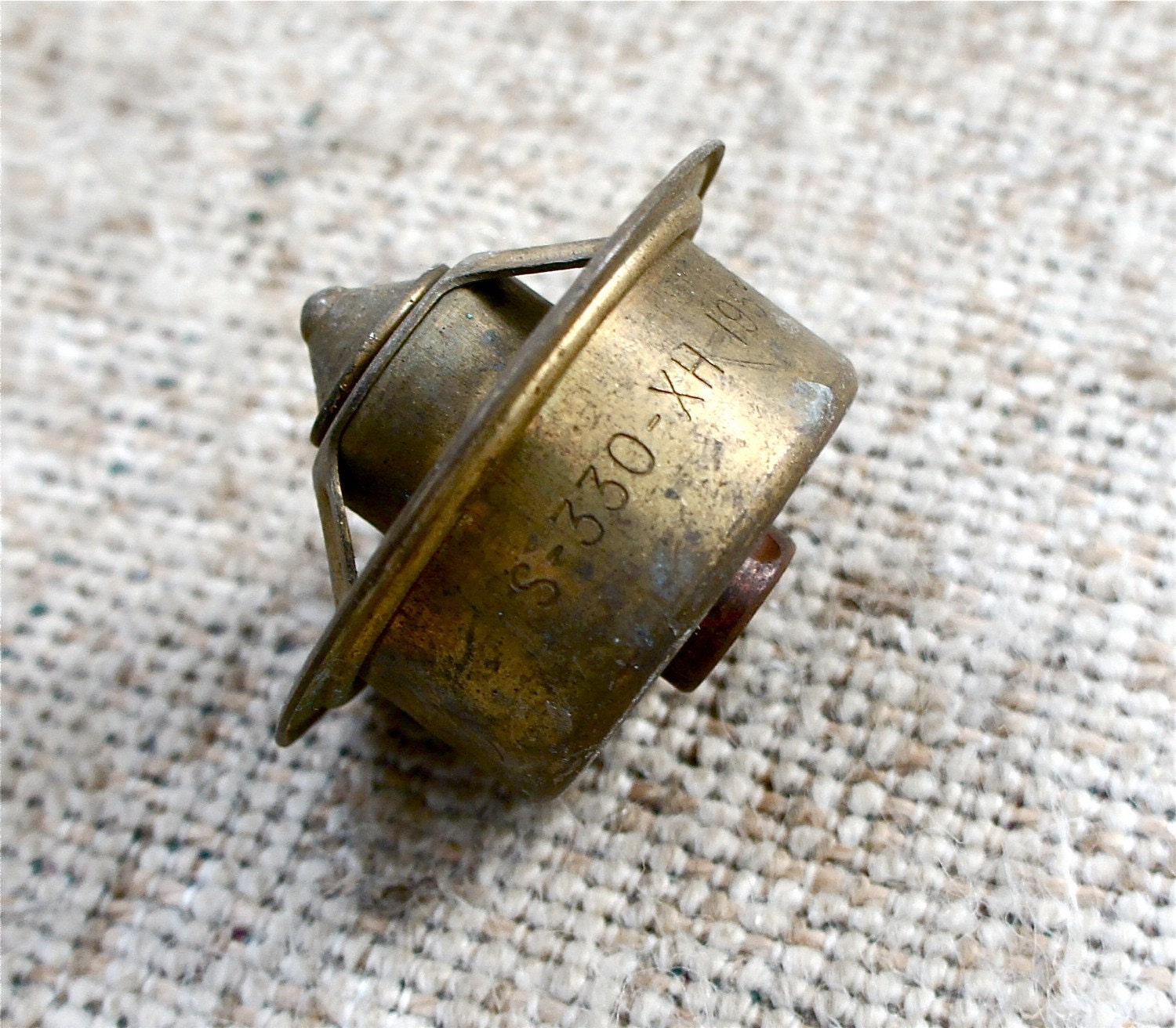

Up until fairly recently I could find the "regular" thermostat for my '37 at my local auto parts place, and you still might be able to. The trick would be to take your old one to the parts house and compare it to the ones hanging from the display panel. Or, if you have a parts house where someone behind the counter actually has any brains, you could hand it to them and they might be able to come up with a replacement. Ebay is a good source as well.
First, do you have the regular or the by-pass thermostat?
The regular one will look like this:
This is the type I'd see at parts houses and they would fit many brands and years of cars. There were a couple of different types and the only difference was the diameter of the round plate. Check yours.
The bypass type will look like this:
these won't be as readily available at your parts house but I have found them at Hudson meets, street rod parts flea markets in the 99 cent box, and amongst Hudson parts vendors, so if you snoop around you'll find one.
Here's what I believe is a Hudson bypass type, now on Ebay, though I think it's a bit pricey: http://www.ebay.com/itm/Harrison-Thermostat-3121276-153-deg-Hud-36-38-Super-6-8-39-42-/220946274425?pt=Motors_Car_Truck_Parts_Accessories&vxp=mtr&hash=item33716c98790 -
