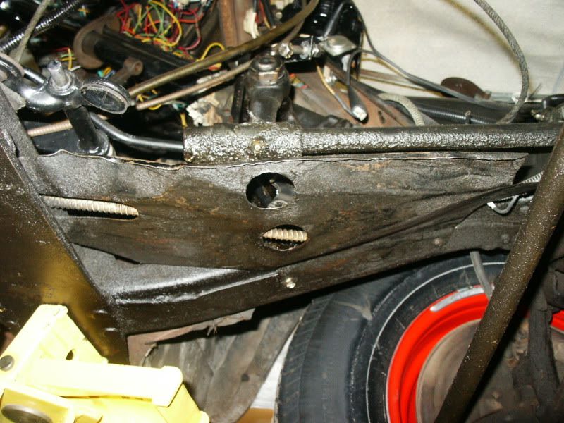

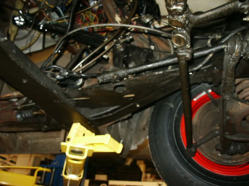

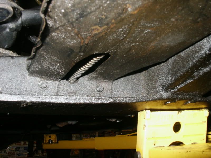

Piece-o-cake, my 49's on the lift...
Great pics Twin H, wish I had a lift.0
Voila!! Thanks for the pics, TwinH!!:blink:
It's purpose was to keep rocks from getting caught in the brake linkage on gravel roads.. which were many in the 40-50's..:blink:0
Well, I can pretty much guarantee I won't be on any gravel roads, but I still think it's pretty cool that I have the original one that came with the car.0
