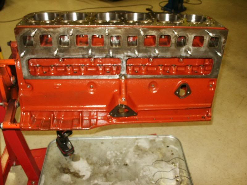

My current favorite stand is this chiwanese folding deal with a geared head. Has no problem
handling the heavy Hud and the geared head makes rotation a breeze, centered approx 3" above
the crankshaft centerline. No problem handling the plate and flywheel too. Just a matter of
moving the washer stack from behind the bolt head to the engine side(taking the alignment dowels into account). No sag at all noted with this stand,the deck stays level. The folding deal
frees up precious space in the shop too when not in use. The splayed folding legs also make a
nice surface for a drip pan to lay on.

Of those two I like the Summit one better. To me the splayed legs will provide more torsional rigidity,plus the straps from the post to the back of the legs is a nice redundant feature. Also you'll be much happier with the Summit deals all swiveling casters compared with the other that seems to have smaller wheels(harder to move) and stationary back wheels. To those who asked about my full flow oil filter setup I'll do a separate thread on that as soon as I get it fired up on the test stand.
