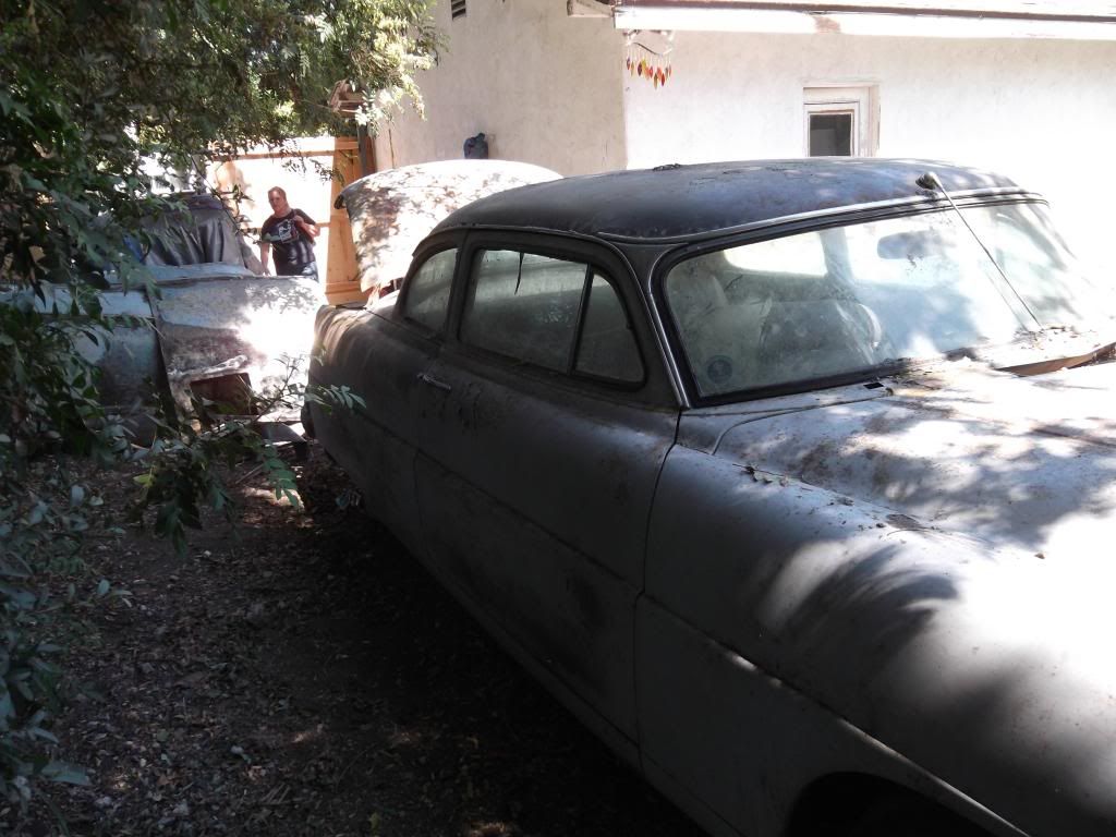

Let me quess Chris. Since the trunk is open are clues there? Could it be the oil cans and coil springs.? Funning aside, how is the restoration progressing?
Lee O'Dell0 -
Lee, Kelly won't let me touch the new one until I get my original 54 on the road. She gives me grief if I even gaze at it too long. You know the drill, happy wife happy life0
HA HA HA thats funny, but true Chris. See you at the Christmas party. Lee0

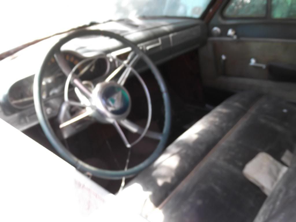

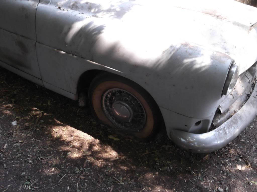

Sweet Car... I guess George was big into custom plates? What did you see under the hood? Are we talking racing stuff like the plates say? Love the Chrome wires shown in the trunk, I would guess that you have them all around? Too early to say anymore about mine because I have a lot to do before I fire her up. I have been collecting some parts locally (Glen Johnson is always a great resource. I'll let you know when I fire it up.0
It does have five motorwheel lip lace wires. Under the hood is a no kidding real factory 7x engine with all the proper pieces in place. Nothing aftermarket that I see. The twin exhaust pipes are a clue in the picture. 232 studded head and the block number indicates that it was made on the custom assembly line. No dents and only surface rust from cheap primer paint. If I can believe it, the odometer says 30k. It looks like the guy parked it 30 years ago, pulled off most of the trim, primer painted it and let it set to slowly sink into the ground. I found all of the unobtainium trim parts so Im good to go when ready. I plan on pulling the pan and cleaning it out then rebuilding the carburetors and cleaning the gas tank before I think about starting it.
