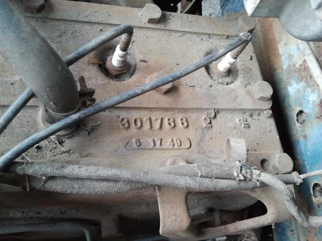

Hi all,
Today I had a chance to look at my engine with some friends for a little bit and we uncovered the engine block number under a good amount of dirt. I would have taken a picture, but it was too dark outside.
My VIN: 492XXXXXX
Engine Block number: 301766_2 (there is a number worn away) with 75 17 49\ below it.
My VIN: 492XXXXXX
The 301766 appears to be the casting (part) number for the head- at least, that's what you're showing in the picture. 5 17 49 sure sounds like the date the head was cast, which would make it a /49. The block number should be stamped on a machined flat spot on the front of the block (not the head), can't remember if it on the left or right side of the front of the block.0
Thank you Ken and Mike! When I pull the engine (hopefully tomorrow) I'll see if I can find another number stamped onto the front of the block.0
Engine number is on the side of the block at the top front, just ahead of the front end of the exhaust manifold.0
There usually is a casting number on the drivers side of the block above the pan flange that will give the casting date. For example : 11 4 48 which would be Nov 4th of 1948. Then you can figure a time lag between casting and then further machine work and assembly into a car.. In this case definitely a 1949 model car. That will not tell you if that engine came in your car from the factory, but will give you the manufacture date. This with the vin number stamped on the right front where Park shows you, will give you confirmation. By the way, the eight cylinder number is stamped on the top block surface in the same right front corner.0
Ken,
I checked by the first exhaust port and it is 492XXXXXX which matches my vin.0 -
