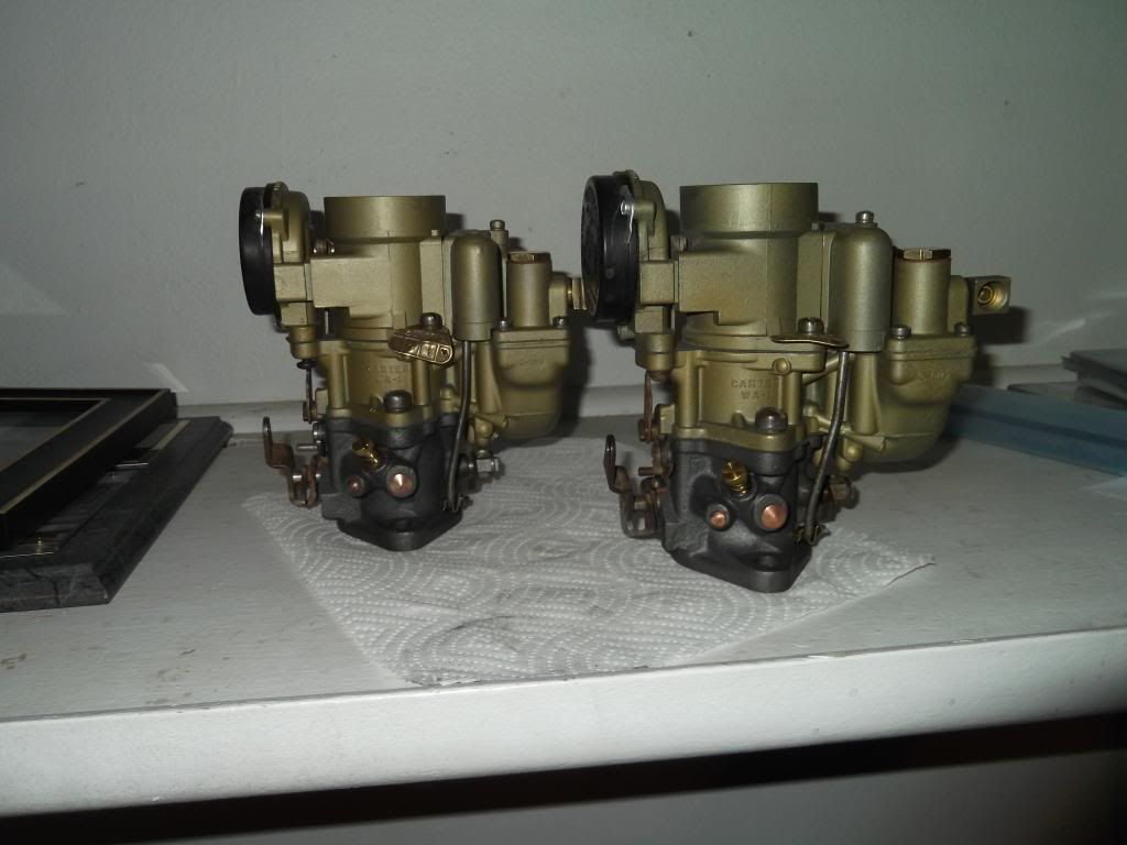

I just completed a rebuild of my Carter carburetors for my 54 Hornet. I hope they work as good as they look. I used carburetor kits from Daytona, substituted the float needle and seats with Craig valves, and painted them with Eastwood carburetor paint and exhaust manifold coating on the cast iron base. It was interesting finding errors that a prior rebuider had done. Luckily I had the hudson shop manuals to refer from.
Thanks for sharing. I too hope your efforts are rewarded with successful operation. Great satisfaction comes from doing your own rebuilds.0

They look great. Let us know how well they work, I'm sure it will be very good.0

THEY LOOK GREAT NOW JUST HAVE THEM RUN AS GOOD AS THEY LOOK MAKE SURE YOU TIME THEM WITH A VACUUM GAUGE WHEN YOU PUT THEM ON ADJUST THE LINKAGE SO IT JUST SLIPS RIGHT IN THE HOLE NO PULL ON THE LINKAGE WHEN INSTALLING THE LINKAGE THEN BALLANCE WITH GAUGE GOOD LUCK0
Very nice looking, that's how mine looked when they went on. It's too bad it's so hard to keep them that nice looking after you start driving the car.0
Are they #2114S carbs?0
Thanks for the kind words and advice guys. The tags say 2113s I bought the Craig valves because I had experienced the sticking needle and seat and fuel leak they caused.0
