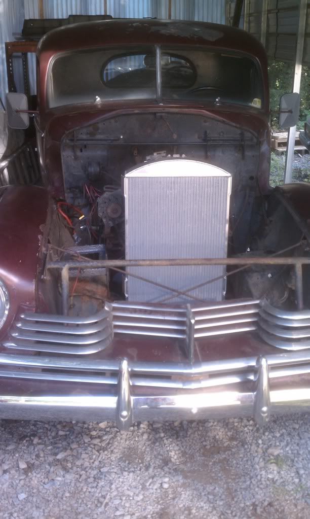

I had the same issue with my 47 truck. I bought a new Afco aluminum unit from Speedway for about $500. It is their 32 Chevy model. It has holes on the top, I made a small plate to use the original rod that connects to the firewall. I was very happy with the fit and quality of the unit. I'll look for a pic.

Afco #80145 for 32 Ford. I figure if it can cool a sbc it can cool a 308. Figures I didn't take pictures of the finished product...

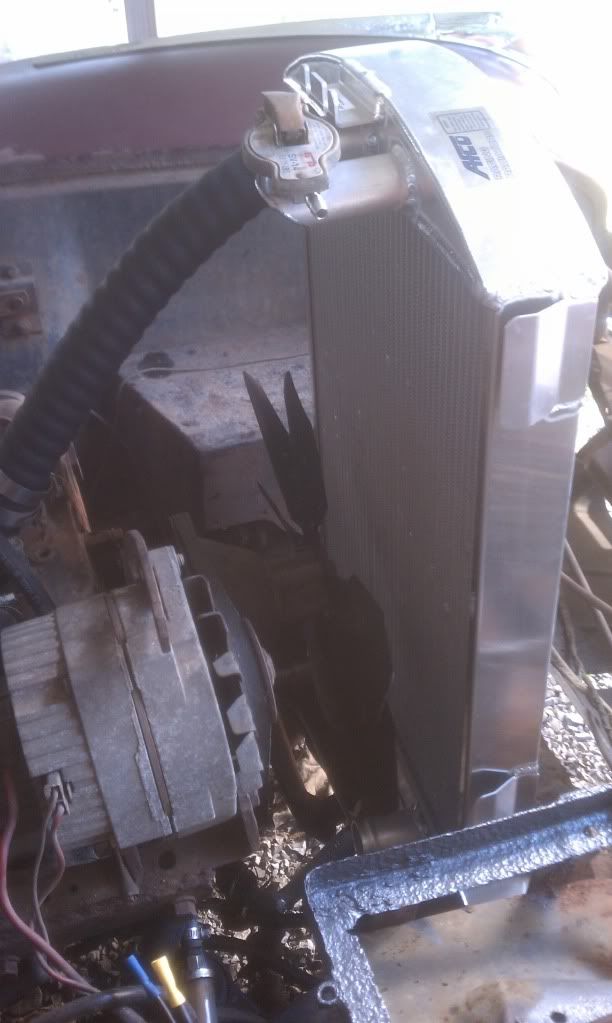

In the second picture you can see two slots on the top of the radiator. I made a simple plate to pick up the support rod from the firewall.
This truck has a sbc, so I'm not sure how the lower radiator outlet lines up for a 308.
