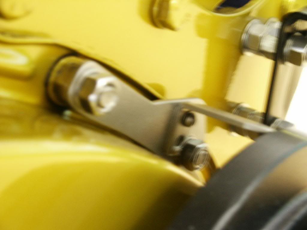

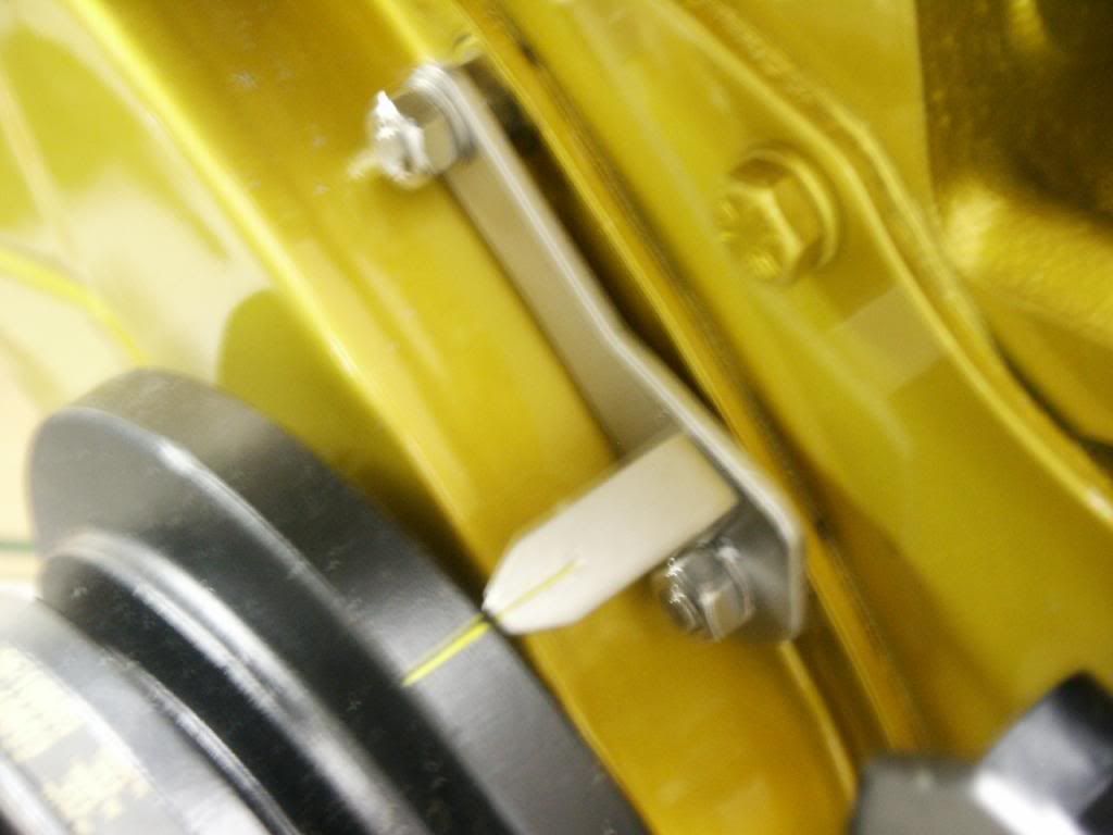

Nice reminder. I was planning a timing mark up front on the dampener, my custom mini starter is a bit in the way of the flywheel window. It's nice to keep things lined up properly though.0
Here's a couple pics of a timing tab that the previous owner fabbed for the 308 in my 49.
Neat little addition
Roger
Good Job
Randy0 -
