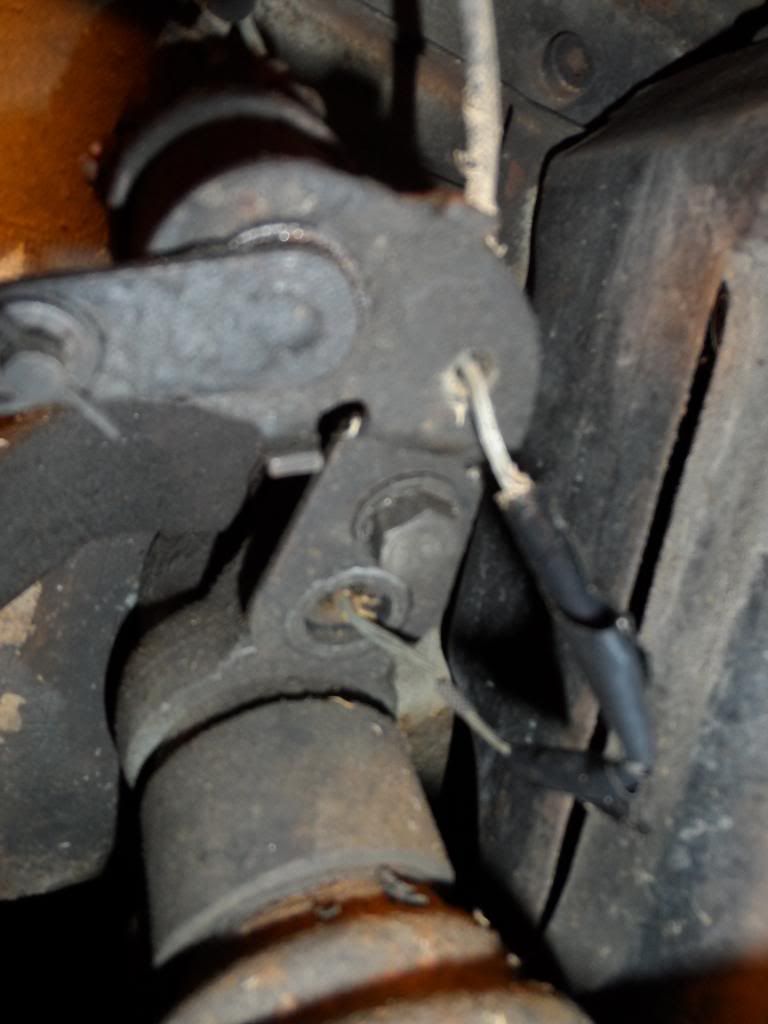

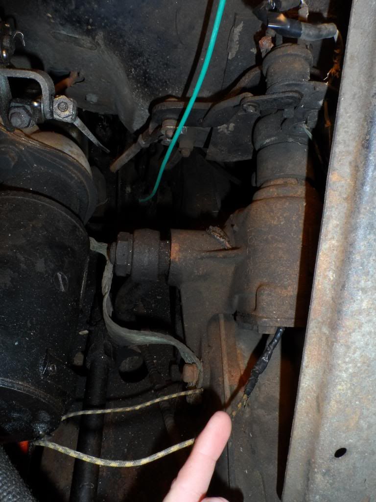

Hello all, I'm trying to ID these two wires in the photos below, one is coming out of the main column tube in the steering gear area which I believe is the horn wire(where my finger is pointing)? The other wire that is just above the column tube in the first photo (hard to see)... I have no idea, but a clearer photo in the second picture. I'm planning to splice in new wires into these old ones. I'm just trying to figure out what goes where. Thanks guys.

As far as replacing the wire in the column. Take it loose at one end and solder a new wire to the old . Put a small amount of tape on the joint to make it smooth. And take other end loose and pull new wire in.0
^Great idea... Thanks!0
