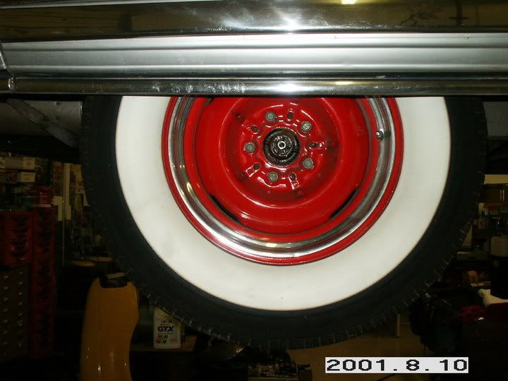

I'm running 215-75 R 15s on the 49 Commadore which are the replacement size for the original 710s They look and handle great.
I even used take-off blackwalls and painted them with Latex house paint. People don't know unless I tell em, and I saved a bundle.
http://groups.msn.com/HudsonEssexTerraplaneBulletinBoard/unclejoshshudsons.msnw?action=ShowPhoto&PhotoID=2644
