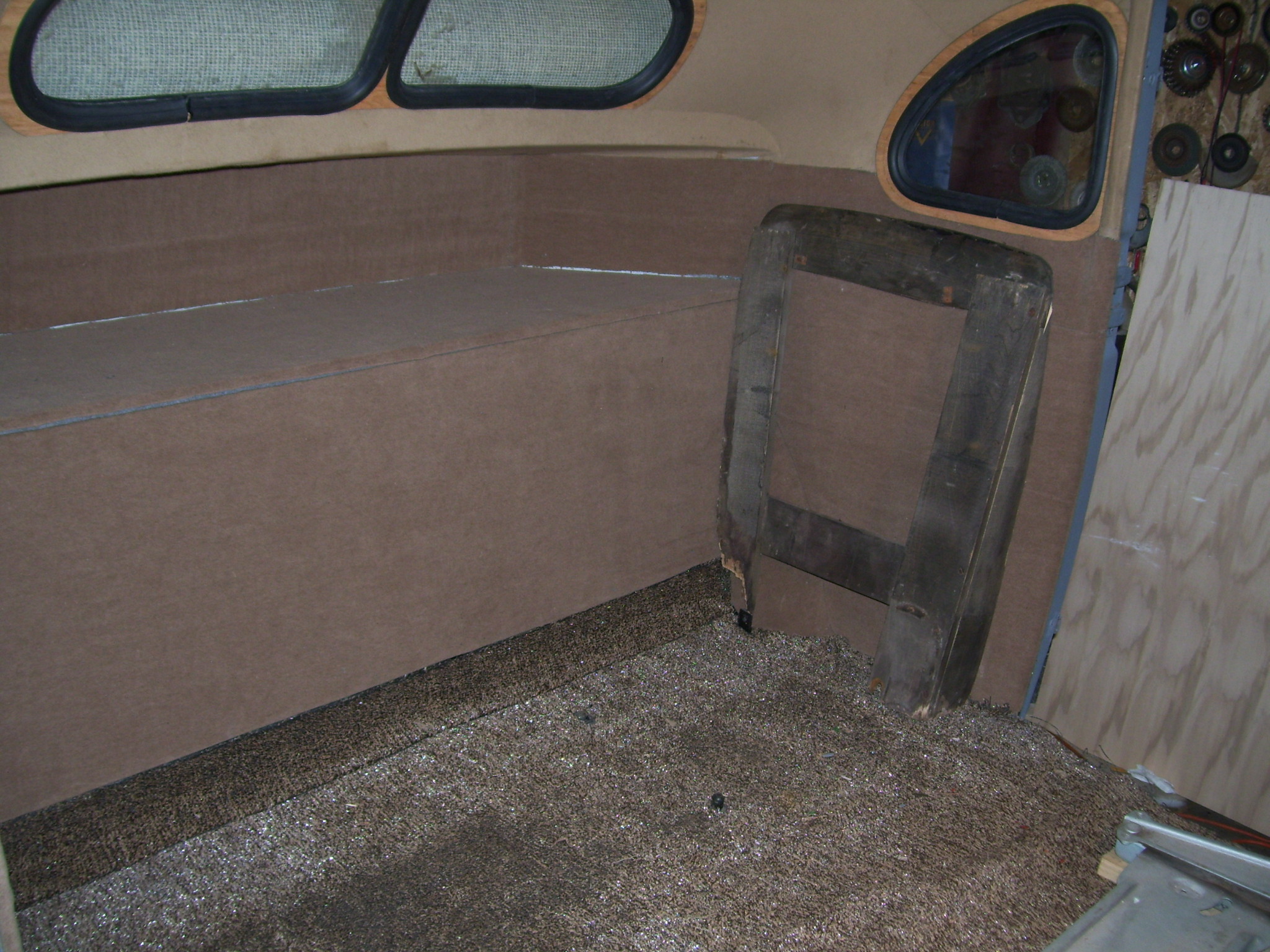

  • Thanks to the people who fixed this, we're back to easy pics. Here's the latest pic. Still need some piping to cover raw edges, but GM assures me it's available. Jon, this is the frame for the jump seat you got from Ed. Needs some woodwork, and upholstery but fits like a glove. The bottom wood, such as it is, has a hole that matches the nub on the floor. Anybody know what should be behind this for the brackets to hook/rest on? And which way is it supposed to jump?

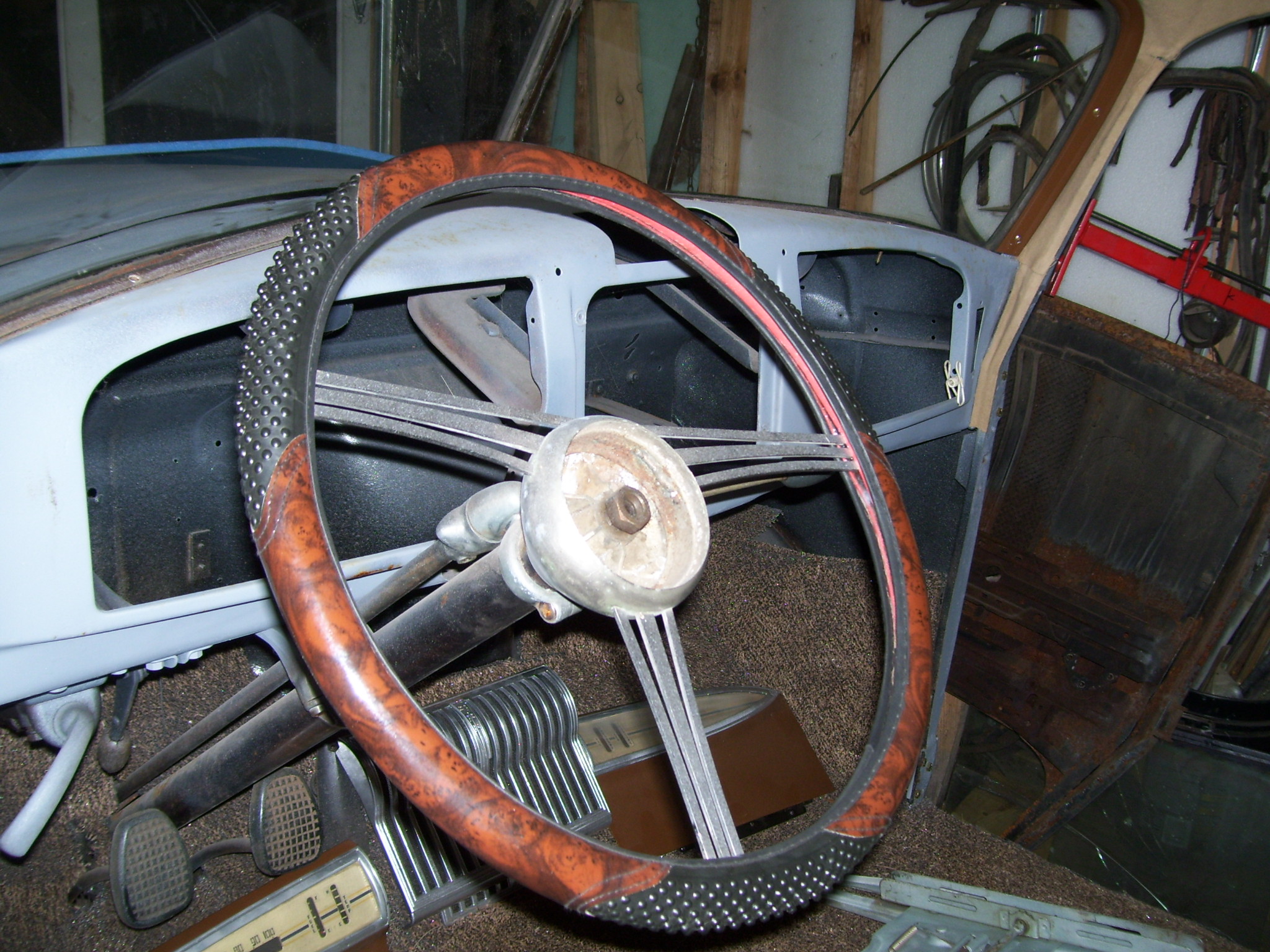

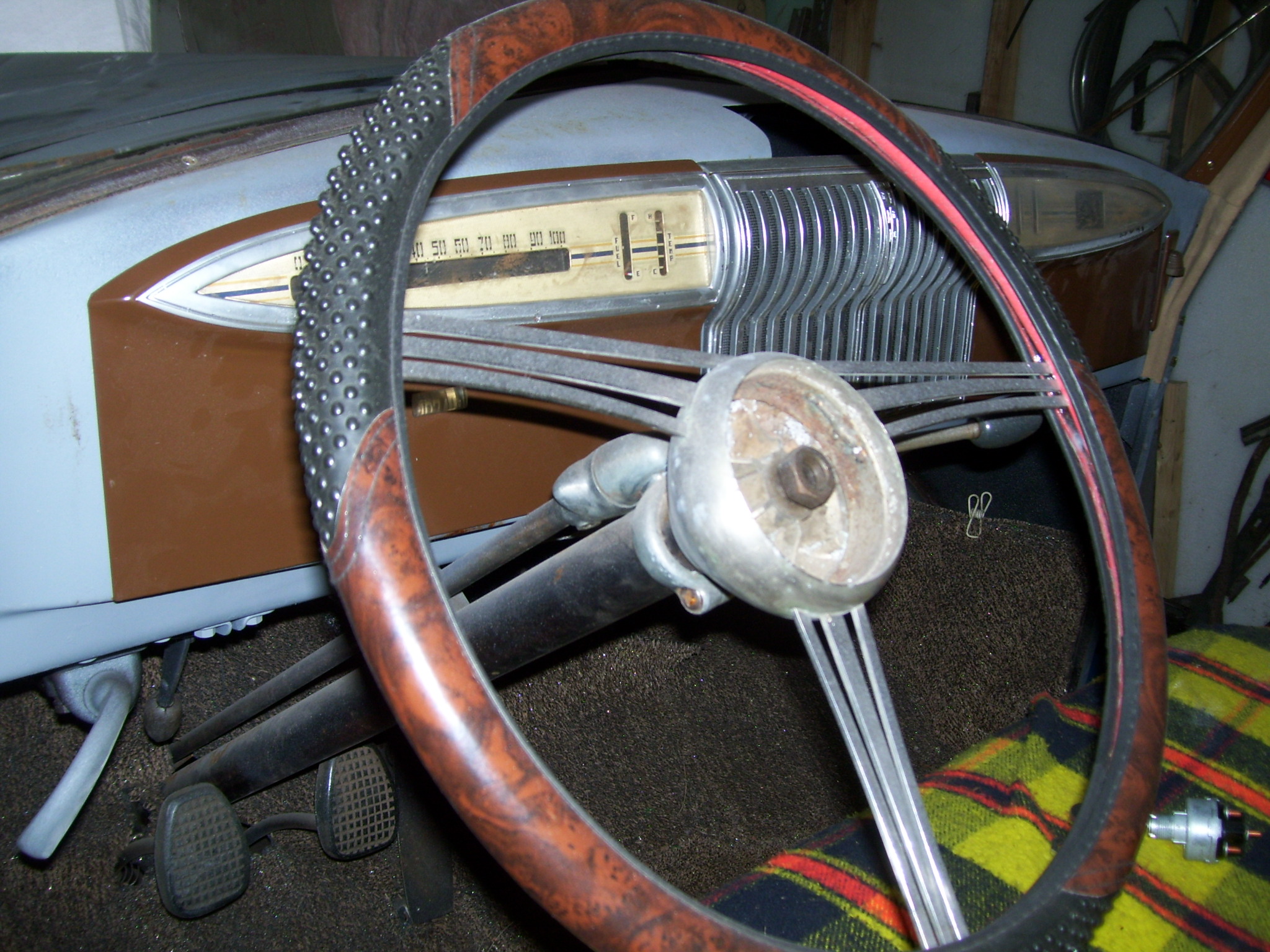

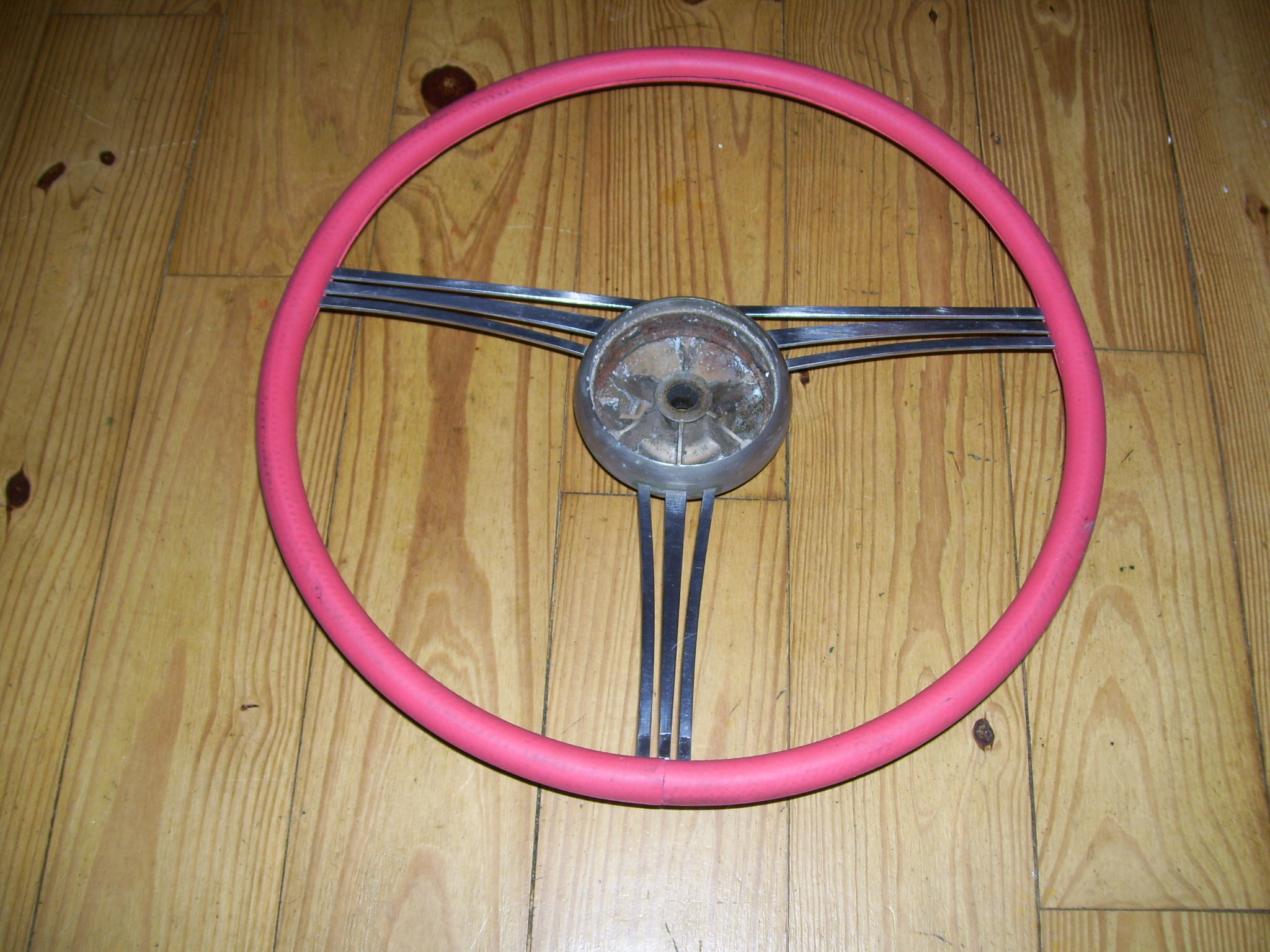

  • Got the steering wheel cover on today.  Heater hose $5, cover $22.  Not bad.
  • Uncle Josh, I believe the jump seat was on the passenger side of the rear compartment to ease entry for the passengers, and a similar stationery seat mounted on the drivers side.  Was looking for a plate in a master catalogFound one on page 295  (Plate 23) of the 1930 thru 1939 Master Catalog, but my scanner would not do the job.  This plate will back up my statement above

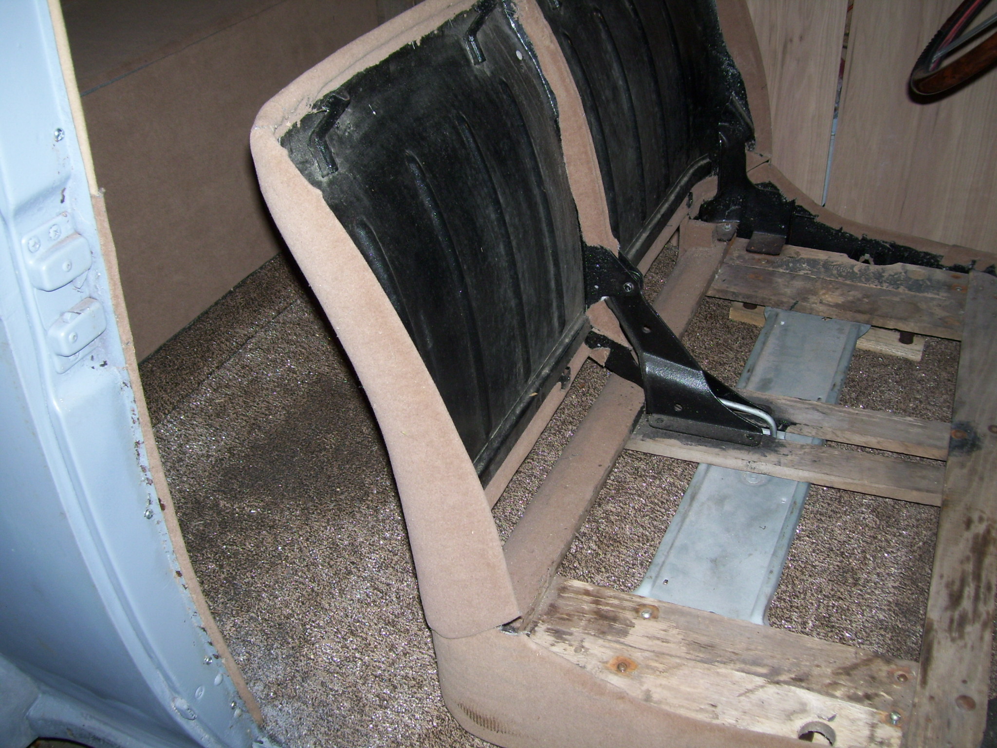

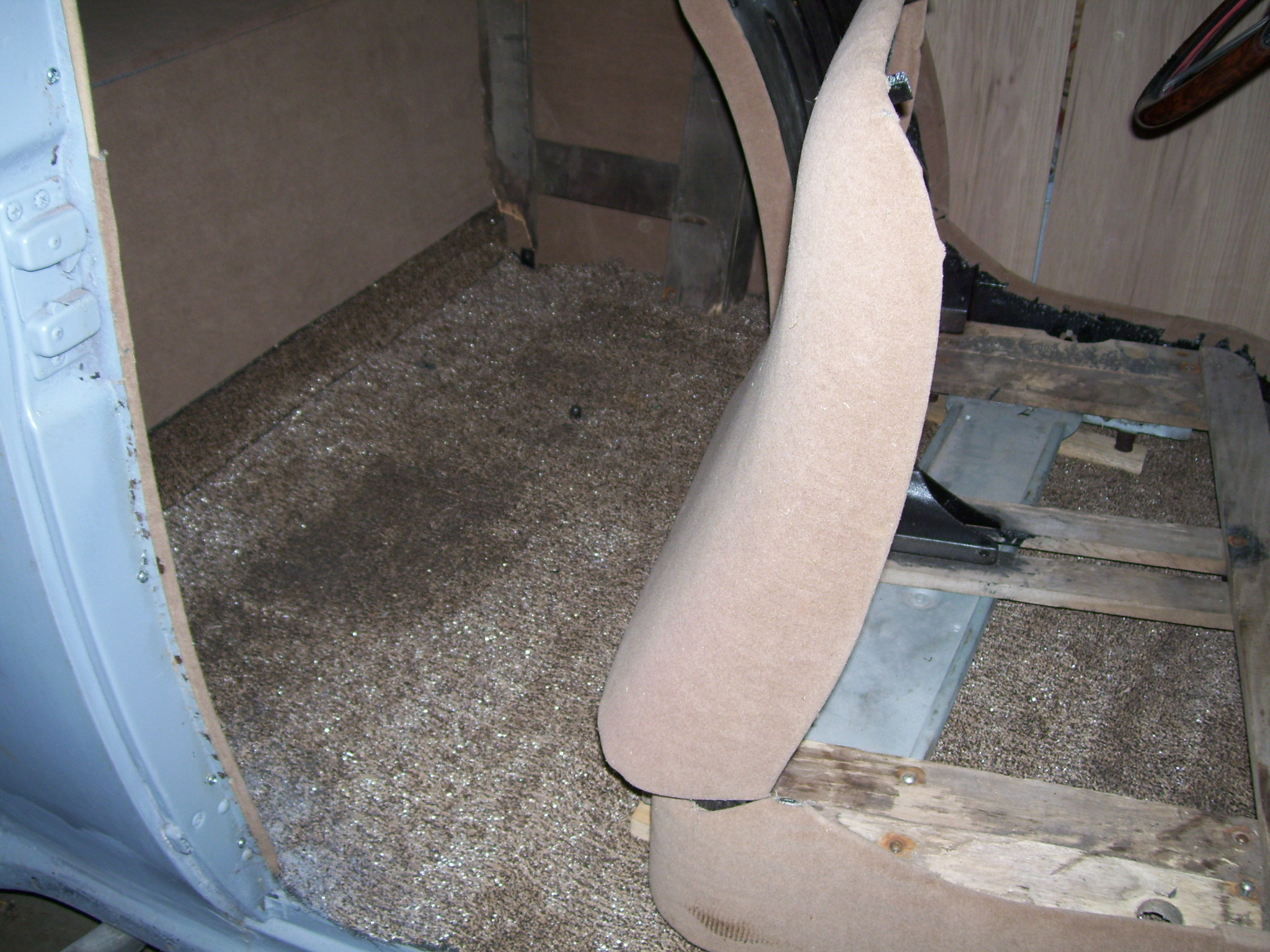

  • Got the seat frame in today.  The original was pretty bad so I sold it to a guy with a 46 who didn't have any.  This one came from the 46 Brougham donor.
    This mechanism that swings the passenger side of the seat forward when the seat is pulled forward to allow granny to enter the back is quite ingenious.

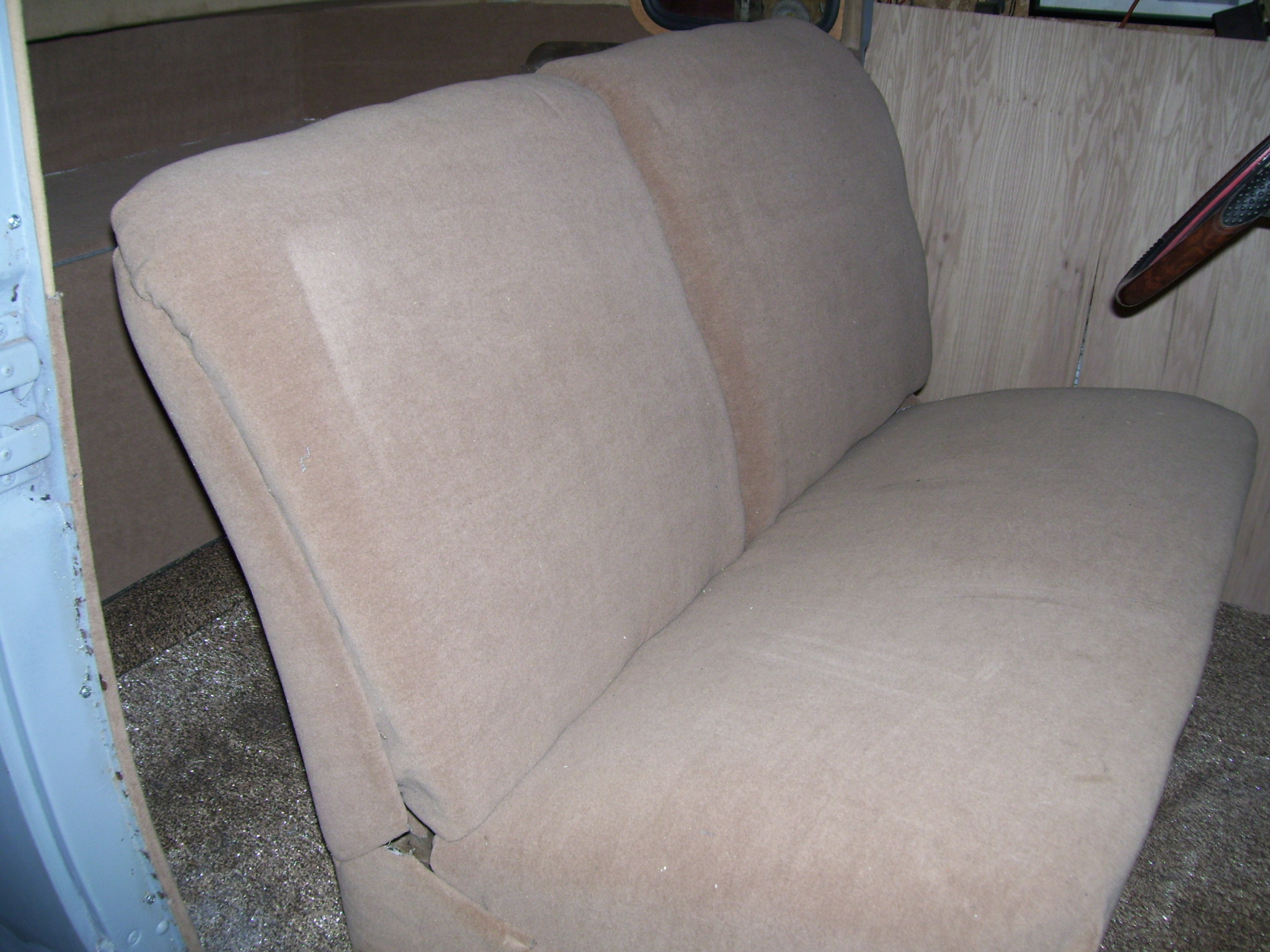

  • Seats are in.  Not bad for an amatuer if I do say so.  Material was donated by grandgirl who bought a bolt and didn't like it.  Works for me.

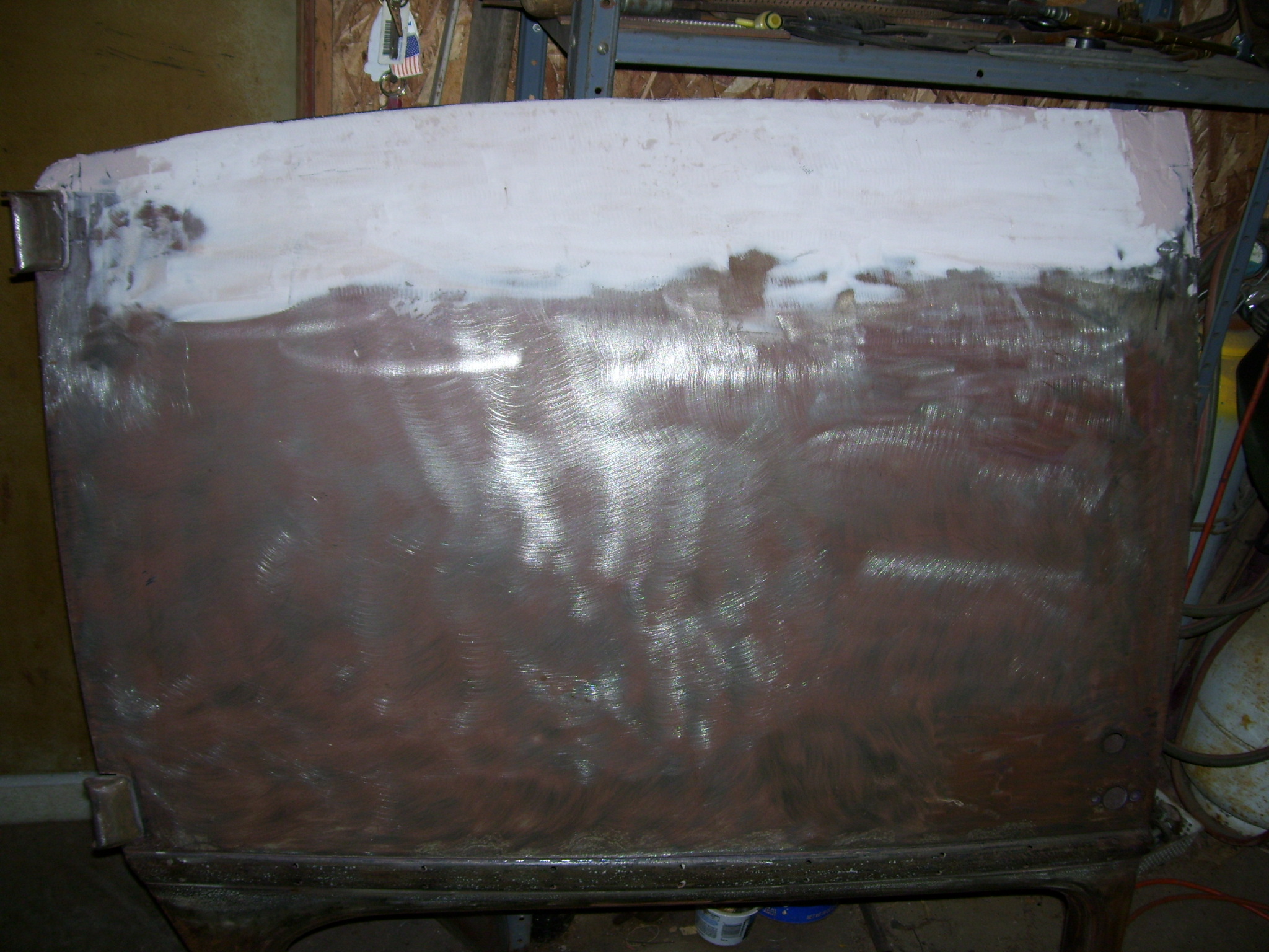

  • Got the dash in.  Kinda tricky drilling and tapping for the broken screws on the center grill holder without breaking thru.

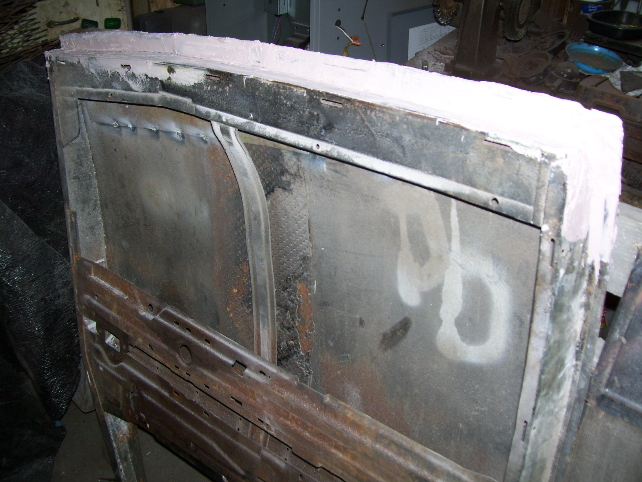

    Doors were an inch or so short compliments of the tin worms.  Back corners gone.  Built them up with tin and bondo.
    Got the 'new' hinges aligned with the doors compliments of my big monkey wrench with pipe extension, and the cutoff wheel on the angle grinder.  Guy that made them was a butcher.  They should have paid me to take them.
