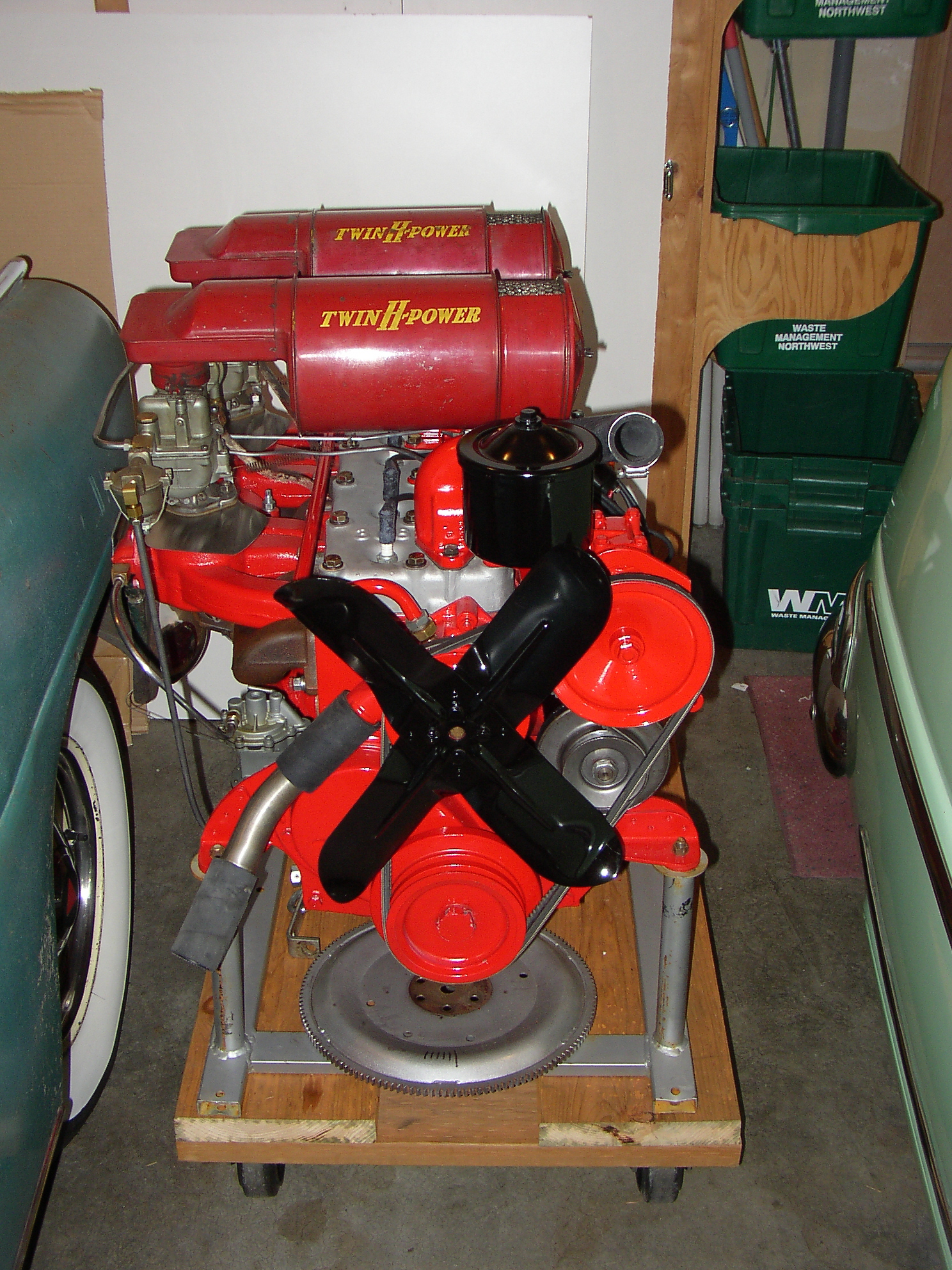

Im about ready to start the restoration on my twin h air cleaner housings. I've painted the engine t-bird red and its a good match for the original 54 Hudson color. I don't think its dark enough for the air cleaner housings. Am I wrong? What are you guys using color wise? Rattle can or spray gun?

Thanks for posting the picture onerare39.0
