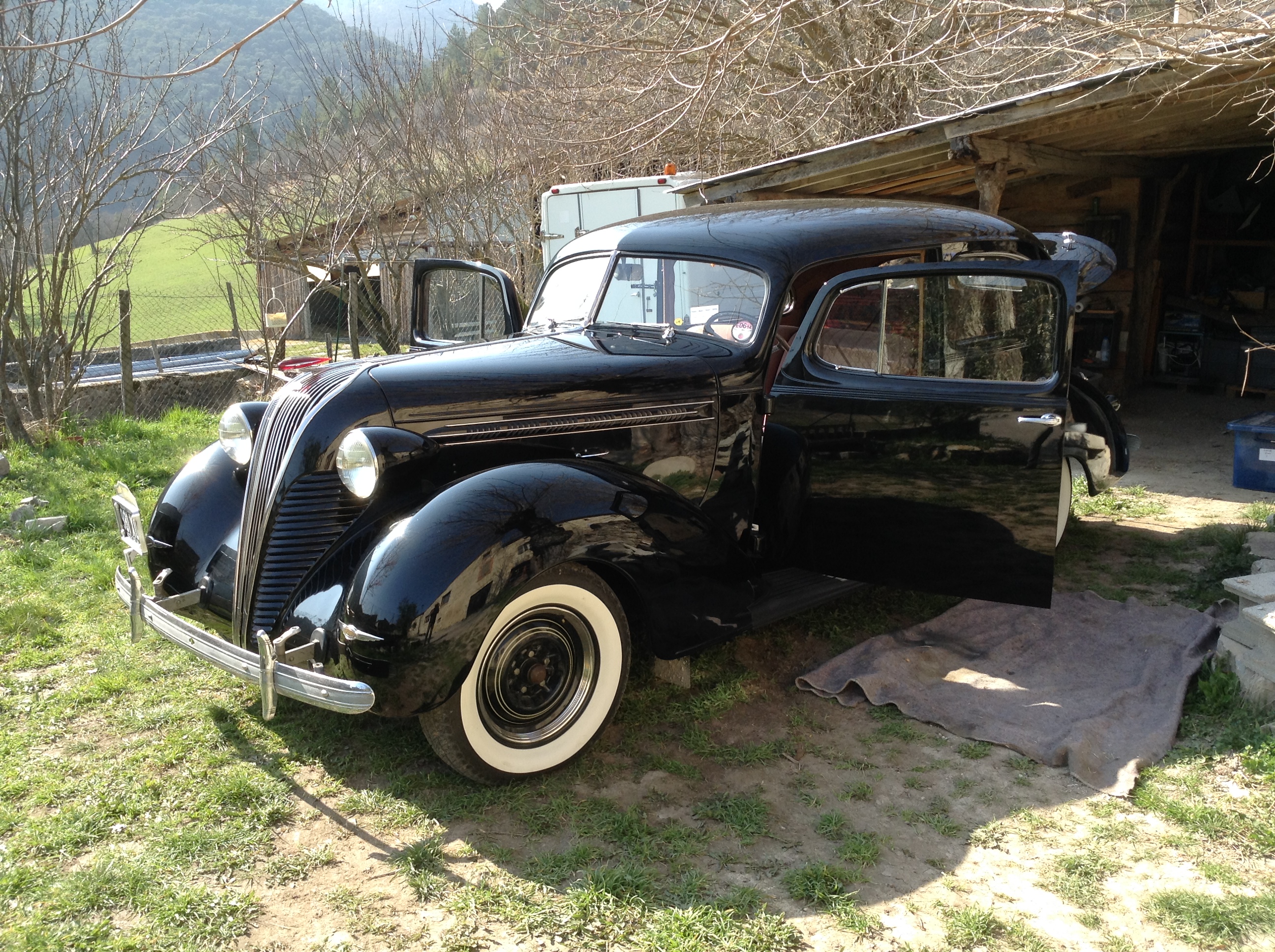

Thanks Jon - this is actually 'my bad', and a development of me trying to undo the wrong seat bolt. I thought the bracket on the floor was the seat bracket, whereas it is actually welded to the floor. And as a consequence of that misunderstanding I thought the front mat went UNDERNEATH it (it did on my Kaiser). And so I thought I needed to remove the seat. However, as the shaped brackets are just part of the floor I don't need to remove the seat at all, but removing the cushions as you suggest is a really good idea, because I will be able to see better.
So - thanks! And here she is this afternoon while I was trying to get the seat out!

Very nice , share more photos after you get the mat in.0
