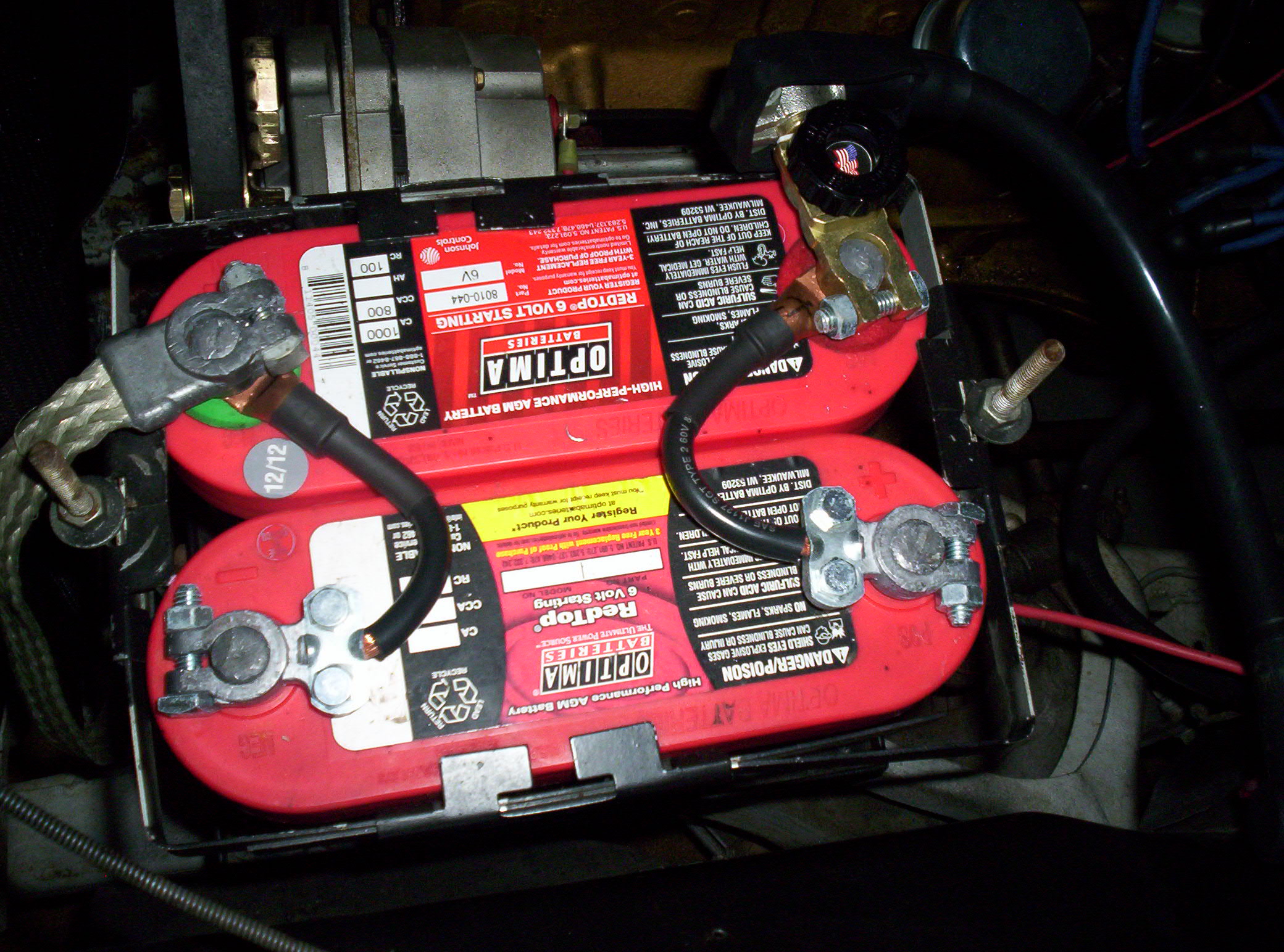

Well as long as we are talking batteries I thought I'd put my lightbulb out for discussion.0
Took the same approach with our 54 Hornet, our Optima's are hooked up in series for 12 volts. Works great.0
I also took the same approach, but hooked them in parallel for more cranking power but still remains 6 volts.
Works like a charm!
