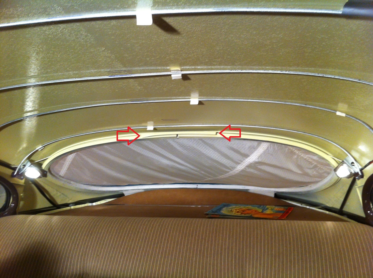

Mysterious sheet detail in rear window
Maybe an additional bow support?? HMMM.....
Jeff
I've never had a set of the optional venetian blinds. Did they have an upper hanger like this?
To jjbubaboy! Thanks for your tip which could have been right. I tried to place the roof bow into that "support" but it was impossible. The bow is too high and will rather stay in contact with the roof. I also checked a Headlining instruction which I have but nothing is mentioned in there about that mysterious sheet detail on inside top of the window. My own guess is that on some models it is used for mounting a courtesy light as you cannot really mount it directly onto the roof. But I am not sure.
Grateful for further tips!

I have a 49 Super brougham with no head liner. The rear window "frame' is a one piece stamping.. No joint at the top like yours. I just junked a 50 pacemaker brougham body and it had a one piece frame like my 49. I can only guess that they added that piece to yours to fill in a gap in the frame? but why? Maybe something to help ease assembly of the rear glass? I didn't see anything like that on a 51 Hornet I just junked, but that is a larger window.
The courtesy lights were only on the Commodores in 48-50. They were on the sides between the side and rear windows. The pieces of metal that they were mounted on are not welded into the Super or Pacemaker. I cut a pair off a 51 Hornet and welded them in so I will have the rear lights.
Does the window opening on the opposite side have the same piece installed and is the opening also cut?0

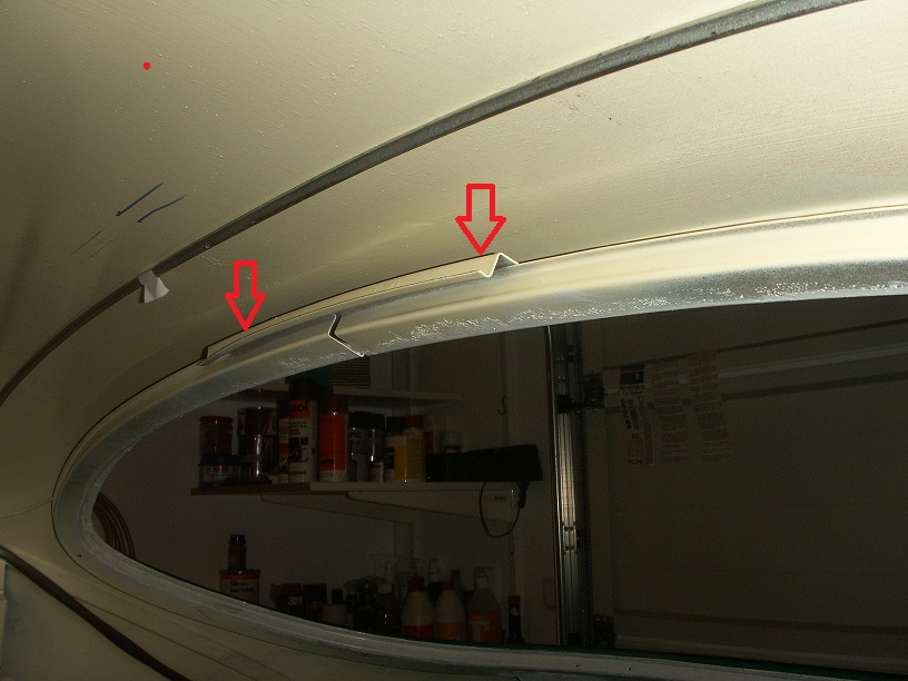

To Oldfarmer 1947 gmailcom! The piece is in the center of the rear window, see enclosed picture.0
Thanks for the updated picture. I failed to view the original post headline. The initial picture's perspective tricked me into thinking it was the side window of a Brougham. The comments previously made about 1951 Hudson cars having a similar window opening split with a piece welded above are consistent with my experience with 51 models. I have no idea why the extra piece is there.0 -
That's what I like about this club and this forum - learn something new every day. Thanks Ken, for your input.

Thanks to all of you for clearing up this mysterious sheet metal piece.I am convinced that it was intended as a reinforcement. I can now make my headliner installation without being anxious. Michael (micki) Henze, Sweden0
