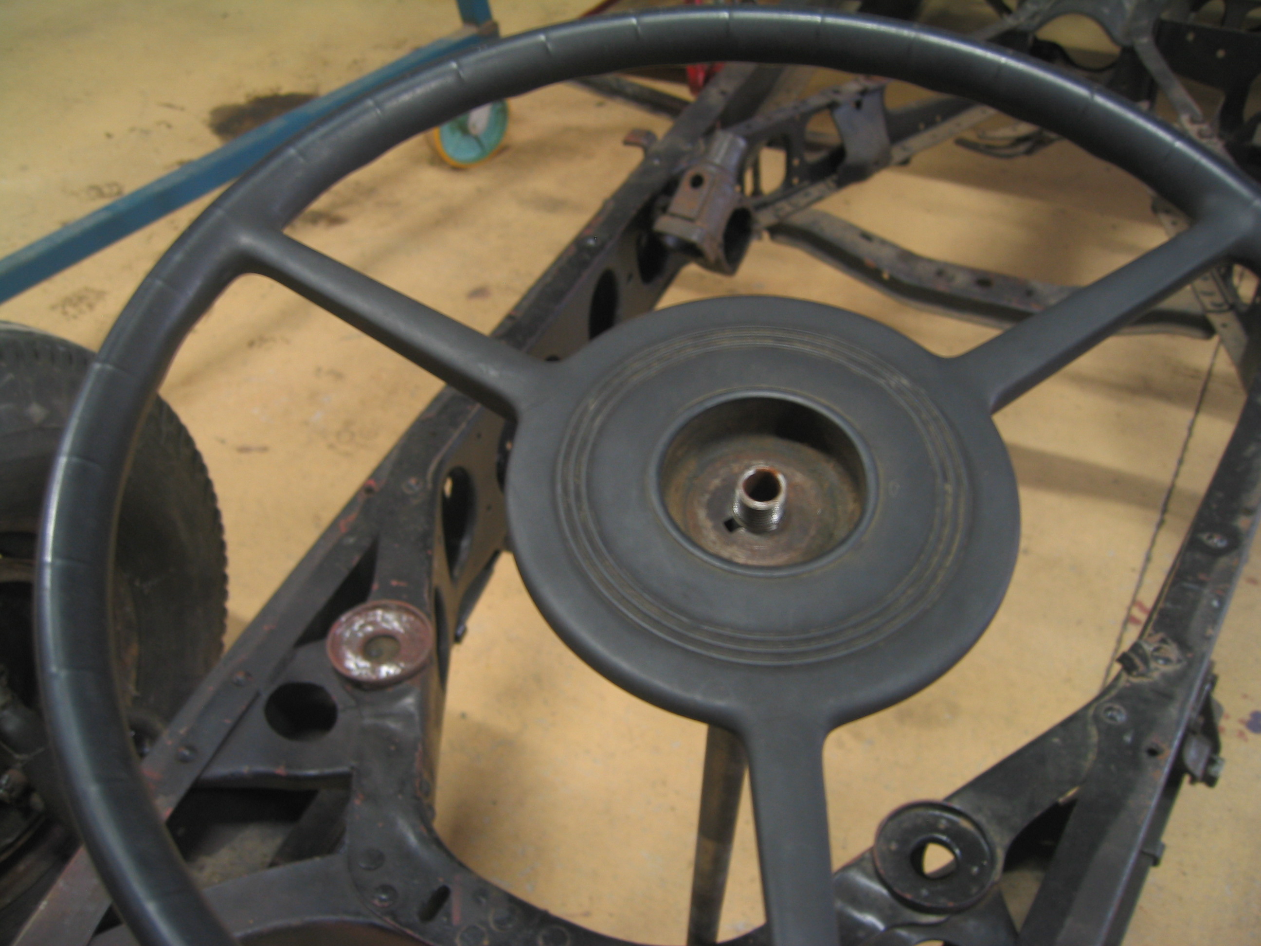

35 H8 horn button & innards
I have a good steering wheel but no horn button or horn contact mechanism. What am I missing here?
Presumably the shaft nut secures some sort of electrical contact arrangement and the horn button attaches to the contact mechanism?
Anyone have any spares they can part with?
the horn wire comes up the center of the shaft so what we need to know is if your horn button for a 1935 is the same as one on a 1936 8 I should have all the parts for a 36.
Are there differences between LHD & RHD horn parts & wiring in 1935 as there were in the earlier cars?
Thanks Rocket. The recess in the 35H steering wheel is 2.4" dia x .750" deep. The shaft is .750" dia which is the same from at least 34 to 39.If the 36 horn button and contact system look as though they fit that size recess I'm interested. They may or may not be correct for a 35 but they will at least give me something to work with for the moment.0
