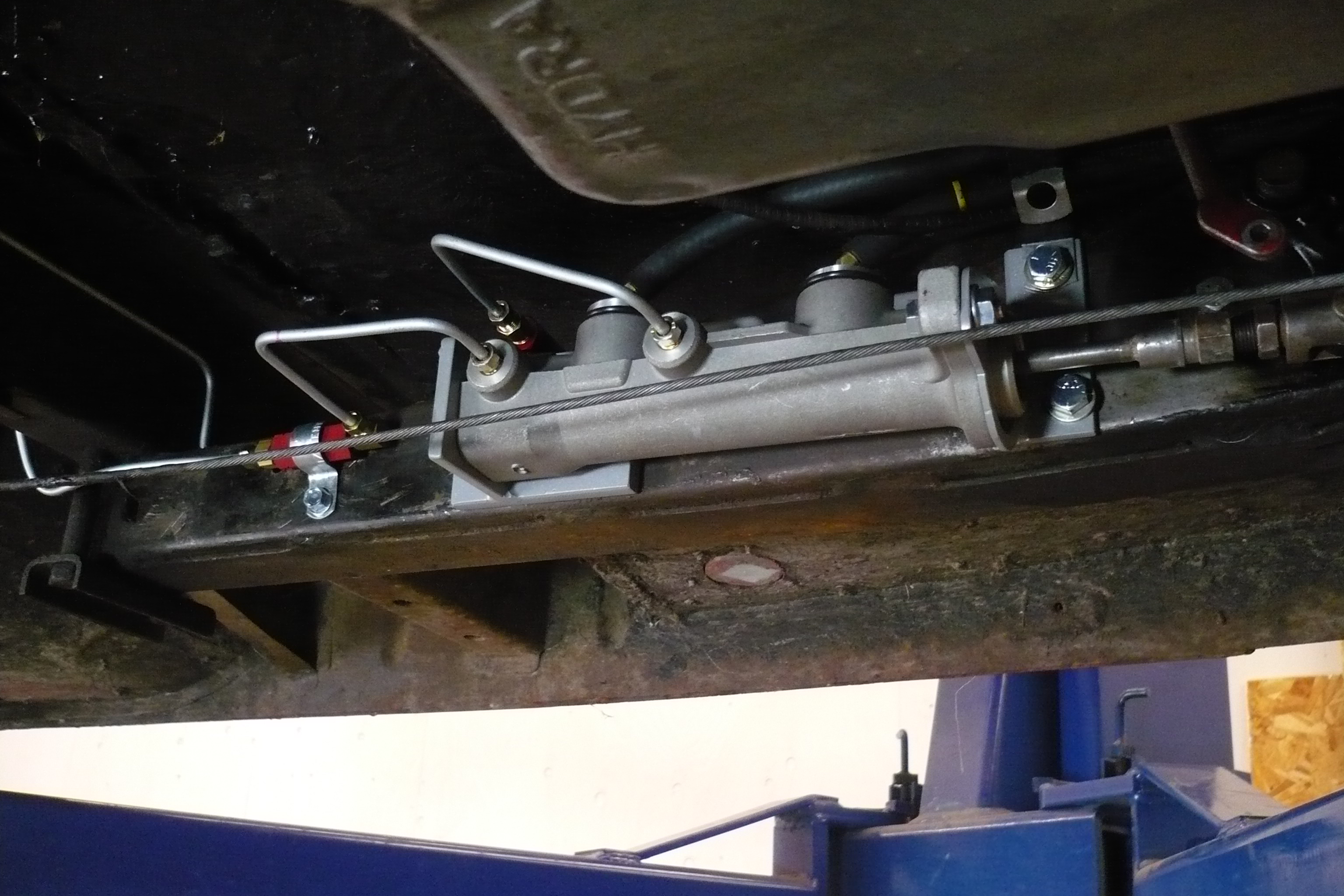

There is a way to do it (isn't there always?) but it's a sizeable project involving fabrication and machining of some custom parts but it does work fine and uses a common Chrysler MC. Although I'm sure Ken meant it as a general example, the kit shown in Ken's post poses a real danger of interference with the ground, i.e., snagging those bottom-outlet bosses and the attached lines on a lump in the road. I used the Chrysler as it has two 3/8-24 side outlets. Note that the dust boot wasn't yet installed in the photo. The push-rod is the original Jet part in the same position. Of course, the reservoir is on the firewall where God intended.

Frank, do you happen to have a part number or more info for the Chrysler mc? Your set-up looks very, very nice!
