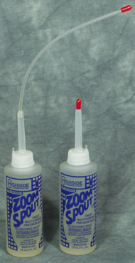

Jim,Look to see if there is a place to oil the speedometer. It would be where the cable attaches to the back of the speedometer. It might be a small hole or a piece of felt that gets oil. The Zoom Spout works great for getting oil up there.John Forkner0
