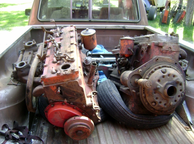

I recently picked up a couple 308 cores.
Both are the wide blocks.
But after that I'm having some difficulty in determining exactly what I got.
The more I read a research, the more I get confused. I've been thru the maint manuals, the parts manuals and the serial number guides and google search.
It doesn't help when there's 50+ yrs of previous owners parts swaps and engine rebuilds.
So here's what I'm working with.
Please chime in on any correct/additional info.

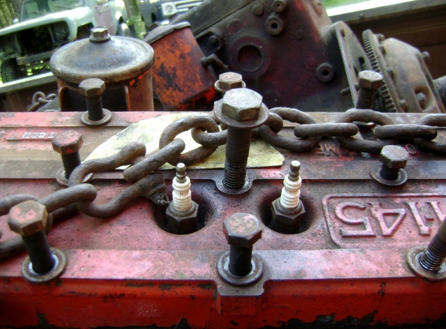

Engine 1

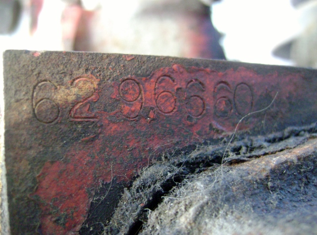

Appears to be a 1954 Hornet 6
Serial number is 6296660 yep, just my luck, and engine with a 666 serial number!

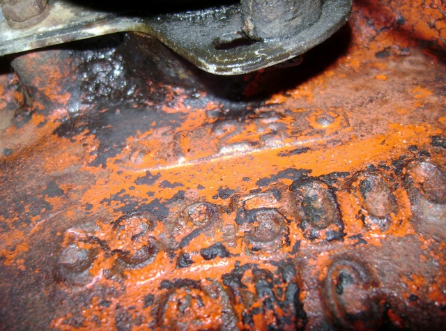

The casting number is 310411

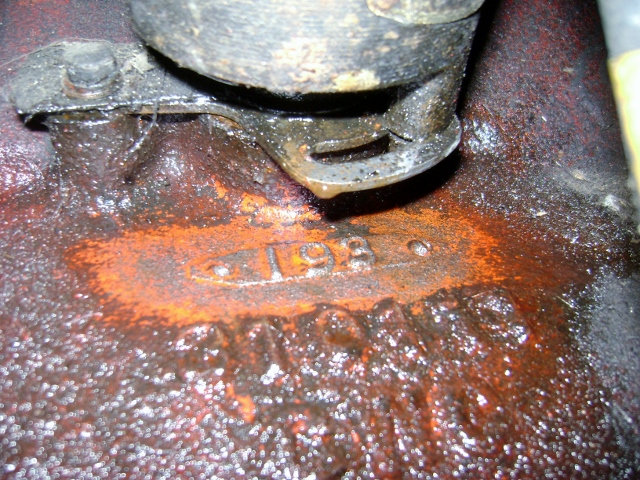

Build date looks like 193. Which I think is 9Jan53.

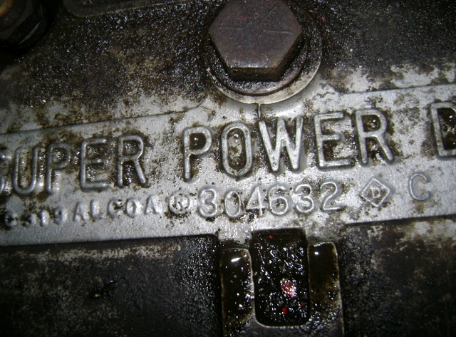

Head is a aluminum H145.
And the 2bbl manifold.

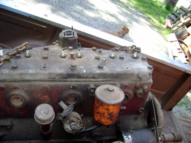

Engine 2
This one gets a little interesting.

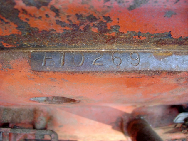

I thought by the serial number it was a 56 Hornet 6, but.....

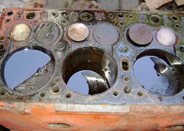

Serial number F10269

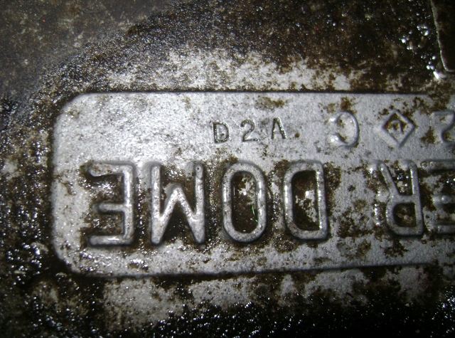

Cast number 5325000
Date 125
It has the steel H145 head.
And the early Twin H manifold

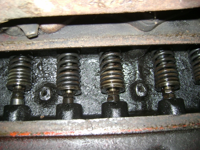

But it has the mechanical lifters which doesn't prove anything since I also found the valve springs were replaced upside down, so it's had a rebuild and a valve job.

Hi Bill,
Thanks for your detailed narrative and pictures!
You are close on the engines. I93 translates as Sept. 9th 53 as the "pour" date.
This casting number is a 1954 model only. Head, Al H145 is the head usually found on 1951 and 52
The second engine, casting # 532500 is a 1956 with a "pour" date of Sept. 2nd, 1955.
Hope this helps,

OK, thanks. So the first digit of the cast date is always a letter. So it's a lower case L. That is so odd compared to most stampings the skip or avoid Ii, lL and 1 due to them looking so close.

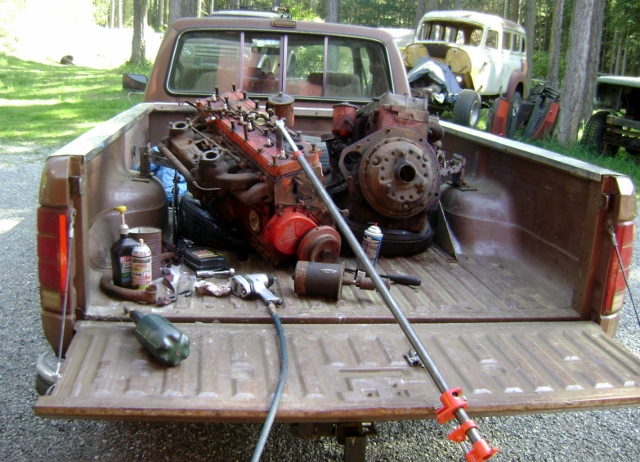

I started to prep them to get them to rotate so I could evaluate each. As with most old engines that are removed from vehicles, you start to find out "why" they were removed.

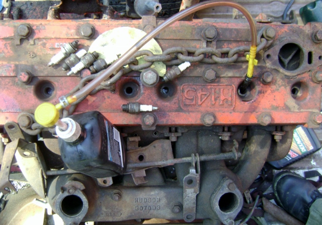

The 54 engine was supposed to be a runner and we actually moved the crank by hand with the flywheel. That was a good thing. So I was able to persuade all the plugs to come out without pulling any of the alum threads with them!
Then I added about 10 squirts of trans fluid/mineral spirits into each cylinder.Then just moved on to the 56.
I did the same on the 56.
I removed the plugs and shot some fluid in each cylinder.

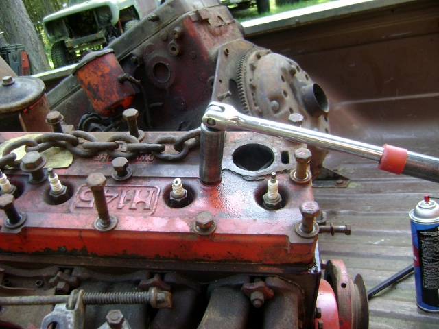

I started to remove the head bolts.
whew, that was fun.

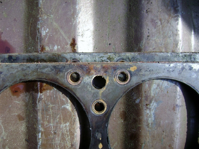

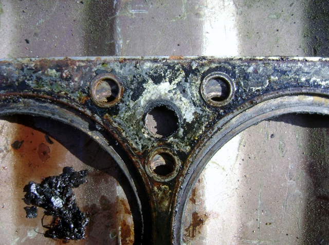

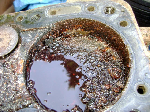

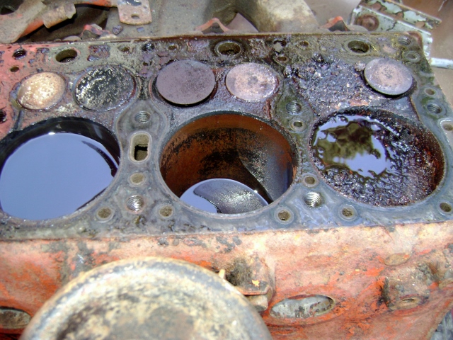

I found the 1956 only, center bolt modification to cure the blown head gasket problem! They upgraded to 5/8"
Got the head off.

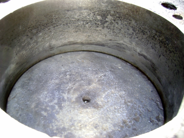

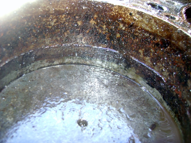

Front 3 cylinders, not too bad.
Back 3, things get a little ugly. Looks like the 5/8 bolt upgrade in the center worked but they needed to add it to the back of the head too.
I got all the corrosion cleaned out and wire wheeled the cylinder and then stuck a chunk of wood in the cylinder and beat it with a 2lb maul. I have actually got the piston to move so there may be hope!
I also measured the cylinders to compare with the manual.
That really confused me. It list the 308 as having a smaller bore than the 262. But it's supposed to be a wider block for a bigger bore.
So I assumed the manual was wrong and the bore of 3 3/16 is actually 3 13/16. Which means these bores are already .020 over. and now have rust pits to bore out.
So how big can you bore? Or do you sleeve since these are the softer blocks already?

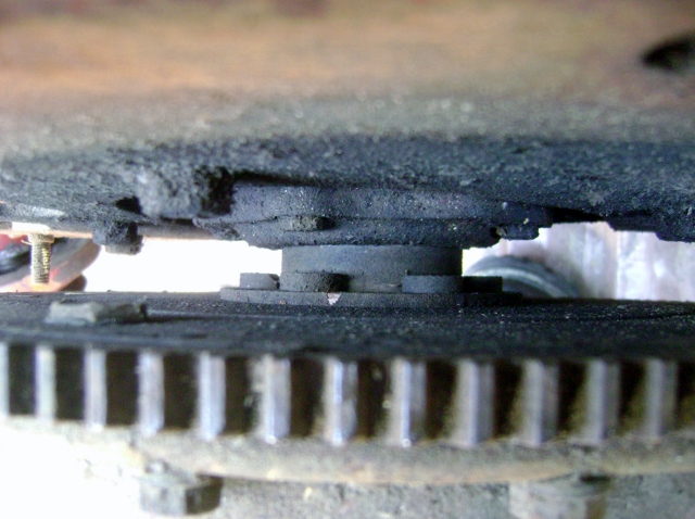

Interesting Bill. For comparison my F8697 , D145 , 532500 engine came to me as a spare for a 308 powered 49 sedan I bought from an estate on Ebay. It was seemingly a NOS engine but came to me without intake and exhaust manifolds and timing chain and cover missing. It had an iron head held on loosely with a few bolts.

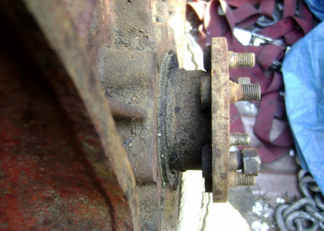

Yours seems to have an earlier long crank in it too which makes it easier to mate up with the earlier trans. Mine had the short crank as did the engine in the 49 which took a special "adapter" flywheel to mate with my 49's single lever trans. Mine also had the hydraulic lifters so it seems sure yours has been rebuilt/modified along the way. Thanks for sharing and look forward to seeing your build come together. Jeff
The 1954 engine is a 1954 engine - the serial number indicates the engine was bolted to a 1954 Model 6D built sometime in March 1954.
The other engine is a 1956 308 - but we don't have a monthly break-down for 55-57. Starting number for 1956 308 engines was F-8601.

Thanks for the great pics and the crank confirmation. I had not read anywhere about a early/long crank fitting the later rear main seal block. That was going to be one of my questions and the reason I was considering the 56 block. I had read the rear main was an improvement over the early rear main seal.

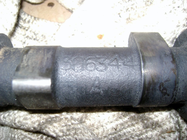

Speaking of cams, I got the 308 cam out and it's the 306344A. So I did more searching and it seems that is basically the everyday stock cam. No one claims to have found any difference from the original 306344 cam.

I set it up on the ground and connected a starter, what a pain that turned out to be! Had the bendix stuck toward the flywheel and it took an hour to figure that out while trying to figure out how to get the starter out of the hole when the bendix won't clear the flywheel.
Would have been so much easier if the starter had thru bolts and not those special studs that just spin as you try to unscrew the nuts!!! What a pain.

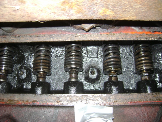

I popped the side covers and snapped the valves open and closed with the cylinder on TDC. I worked them all till they returned closed.
I was surprised at how clean it was under the covers of this engine.

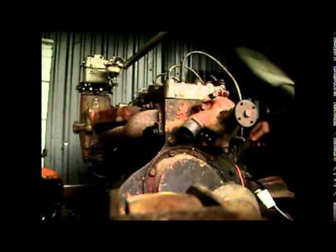

Once they were all good I installed a distr, hooked up a battery and jumper wire and filled the carb with gas then fired it up. Once I got all the trans fluid out of the cylinders it started to run better and better.
So I grabbed the camera and took a short video of the restart.
http://youtu.be/VV-kAn4LSU0
Then I did another compression check and while still not perfect is a lot better ranging from 115 for the low and about 135 for the high.
