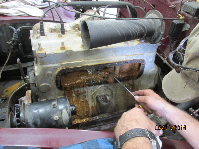

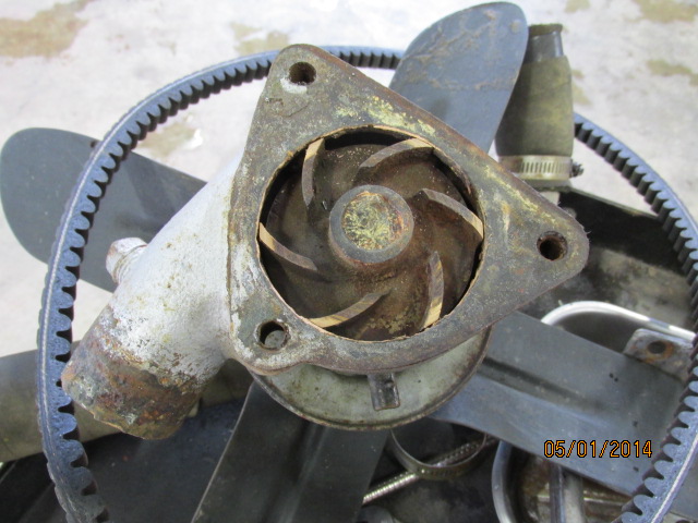

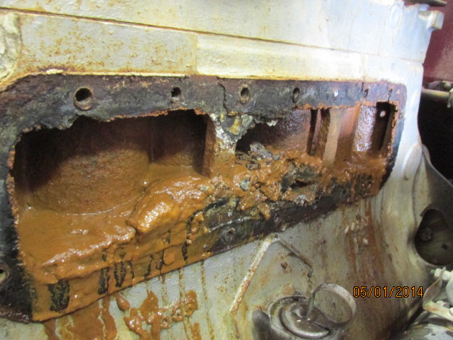

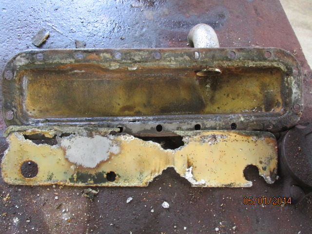

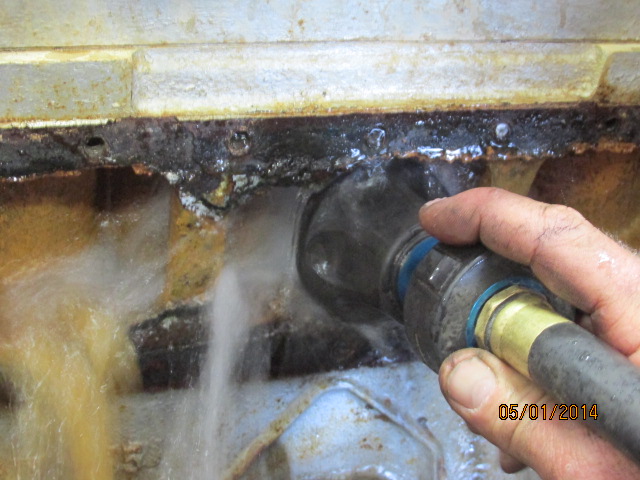

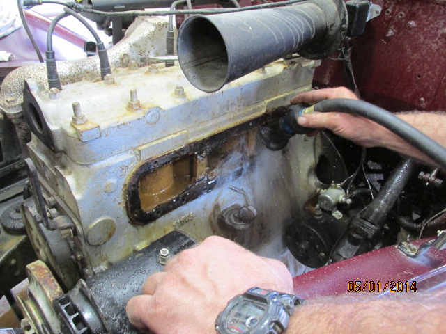

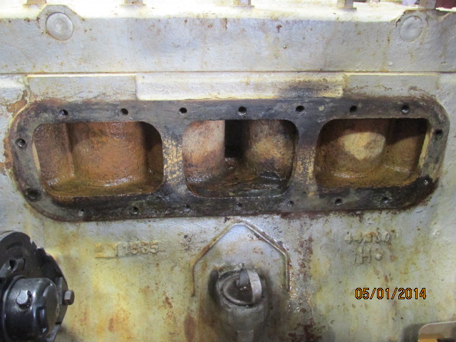

I pulled the radiator to get it cleaned out and checked the water pump. The pump looks to be in good shape for its age and nothing appeared blocked. I then decided to pull, what I am calling, the water inlet housing on the side of the block. What I found was the block was almost half full of sediment, sludge, and gunk. We washed it out as best we could with a garden hose and had to chip loose some of the harder deposit.

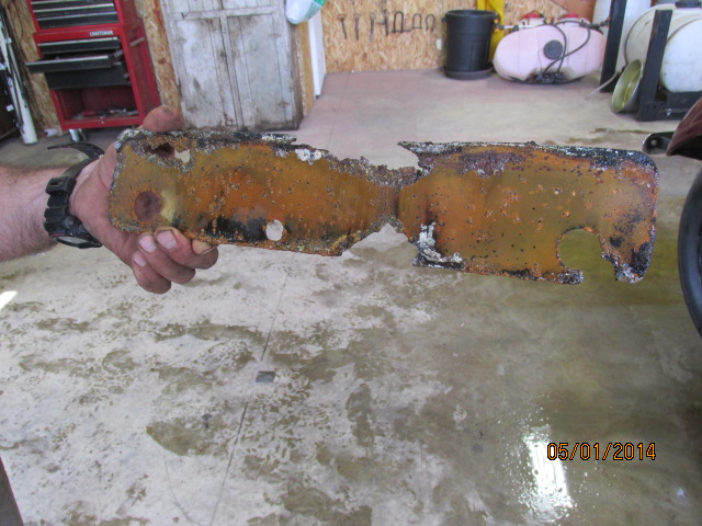

There was some sort of aluminum baffle behind the housing that has some holes to direct water flow. I need to replace the baffle and the inlet housing as they are in very bad shape. Do any of you guys know where I might be able to purchase either of them?

You need to make up a new water jacket plate with the holes as in the original. Make it out of stainless or copper, and sandwich it between the outer jacket, using two gaskets. Also check that the bottom hose is not collapsing.0
I ALWAYS HAVE THE NEW WATER JACKET COPPER PLATED A FEW TIMES AT MY LOCAL CHROME PLATER SO IT DOESN'T CORRODE SO FASTI WOULD MAKE A NEW INSIDE PLATE ( REMEMBER THE NEW PLATE HAS TO HAVE HOLES THAT ARE LARGER AT THE REAR OF THE ENGINE AND SMALLER AT THE FRONT AND SPLIT THE DIFFERENCE IN THE CENTER)I WELD IN THE NEW PLATE SO I WILL ONLY NEED 1 GASKET I WOULD SAND BLAST THE OLD OUTER PART FIRST TO BE SURE IT WAS STILL USEABLE AND SOLID :: GOOD LUCK :-)0

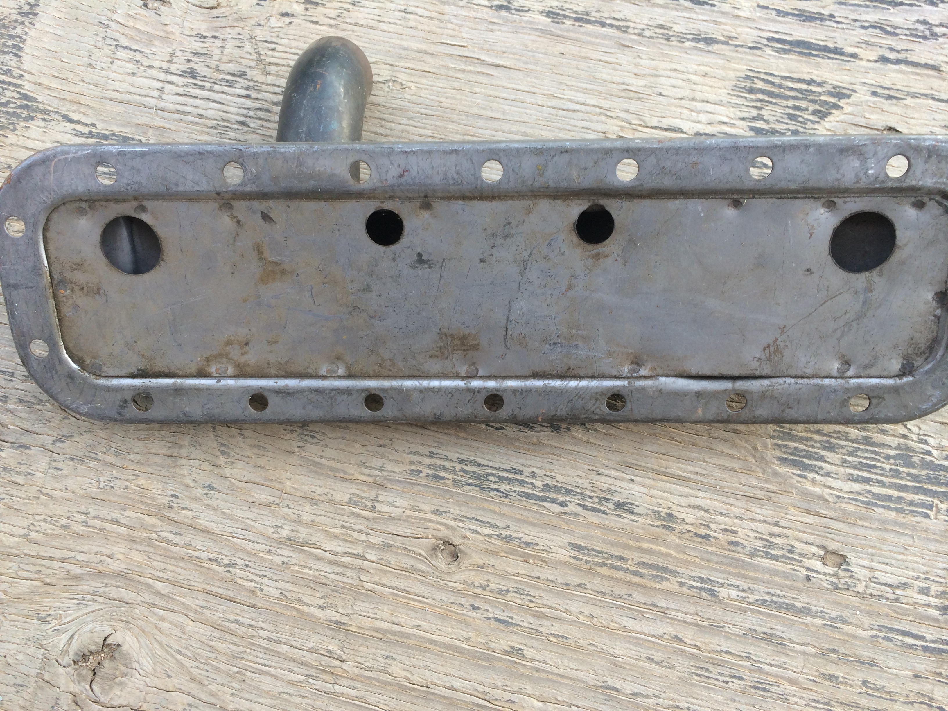

These used to be a common item and replacements were available at your local parts dealer, made by Dorman, I think. And they fit a good number of years of Hudsons. Because there used to be so many of them around, you can still find an occasional one on Ebay, or at a Hudson flea market. You do need to verify whether the later ones will fit your '35, of course. I read somewhere that the 1936 through 1947 were identical, but I'm not sure what the "spread" was with the pre-1935 ones.
The "welded plate" replacement will probably be the quickest and easiest way to solve your problem, assuming (as Paul says) that the outer jacket is not about to rust through in a thousand places. (If that happens, you could write some of the Hudson parts vendors in the WTN and ask if they have a good used one for sale, which you can then use as the basis of your repair.)
Of course, you may want to verify that your engine is indeed from a 1935, and not a later (or earlier) one that was replaced by a previous owner.

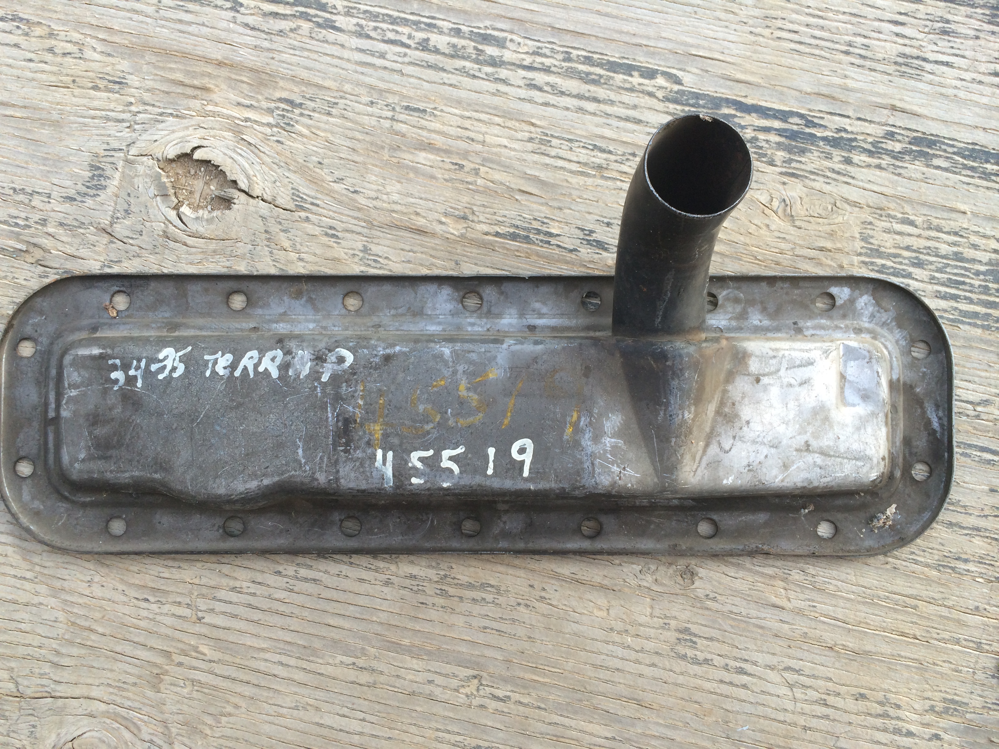

I have a couple of these NOS (or ones made by Dorman). They are really dirty from sitting on shelves for 80 years, but otherwise in new condition. let me know if interested. I also have a couple of good used ones, and some for other models too.
Don
Thank you guys for the help. I really appreciate it. My water jacket is really in bad shape. It has been repaired numerous times and looks like swiss cheese once you start to clean it.
Don, if one of your NOS ones will fit my motor I would be interested in buying one from you instead of trying to repair mine or a used one. You can email me at schleppranch@gmail.com or let me know how to contact you.
I can't find a serial number on my engine. Where did Hudson stamp the number? If the number on the old title is still good, it is 113,783. The serial number on the car is 516,794. From what I have been able to gather here and on the HET website is that my car is a model 51. Thought I would throw that out there so folks know what I am working on.
Looking at the picture of your engine , I can see both the casting number and the casting date.
Both correspond to 1935.
Take a close look.

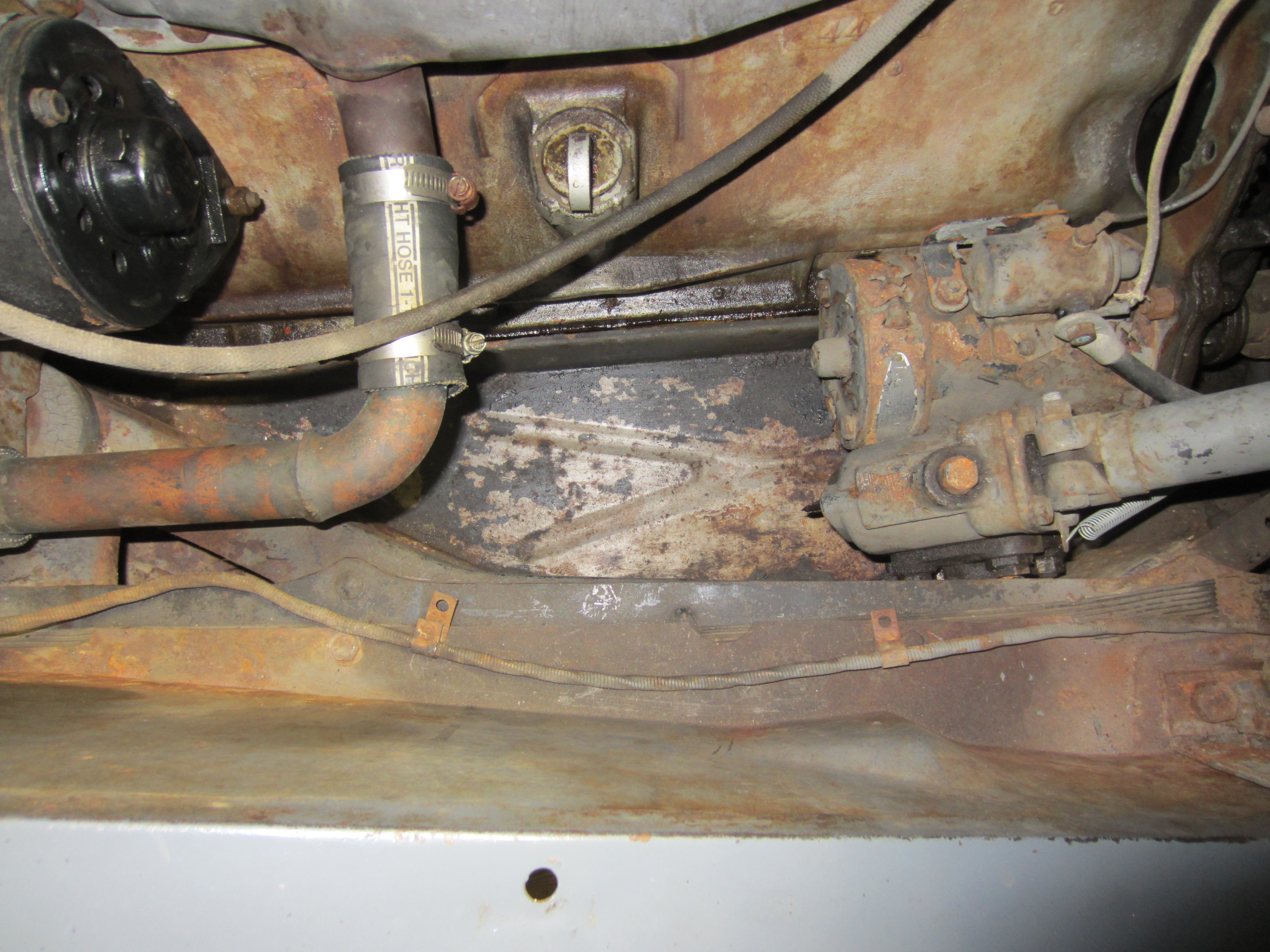

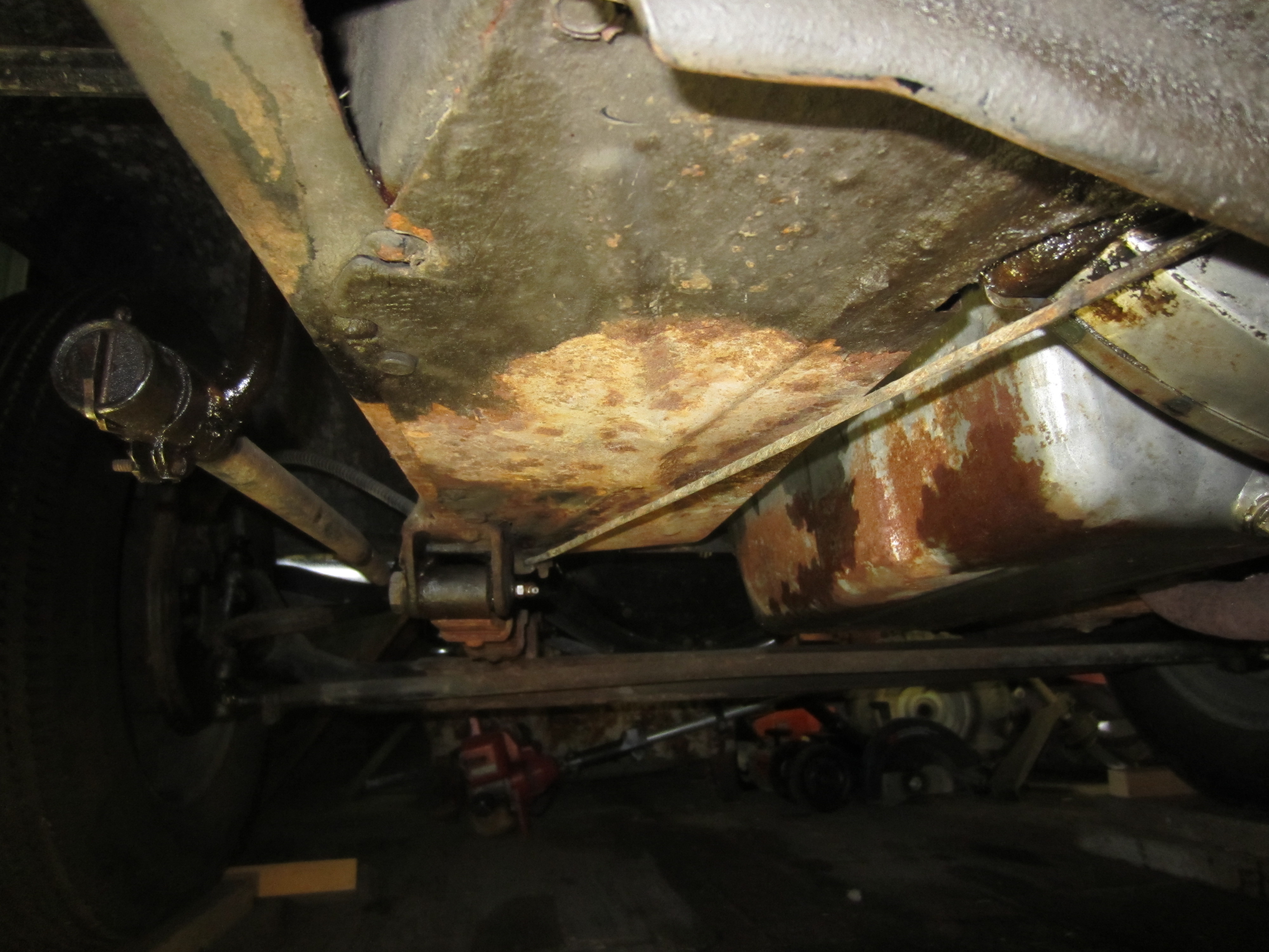

Once you have your water distribution jacket problem cured, there is another overheating component not mentioned here. That is the engine front and side "pans". These sheetmetal parts are attached to the bottom of the frame around the perimeter of the engine compartment. Often called "splash aprons" they function equally importantly to most efficiently take radiator heat back to the toeboard and under and out of the engine bay. Many were lost my mechanics cleaning the oil pan. Many hobbyists think they restrict getting rid of the hot air. Engineers put them there so that the hot air coming off the radiator would not be swirled by air under the front of the car. Lack of these pans can CAUSE overheating.
Oh wow, I have no idea what you are talking about. Do you have a photo or picture of what those are?
Thanks,
Mike
Mike,
The attached pictures are of the side pans on my 35. One looking down front above the other from under the car on the driver side. Same on the passenger side just opposite hand. They fill the opening between the engine and frame.
Tom

Thank you for the photos of the side pans. My car doesn't have either of them. Hopefully someone on the forum can give me an idea on where to get a set. I'm trying to get this overheating issue solved once and for all.

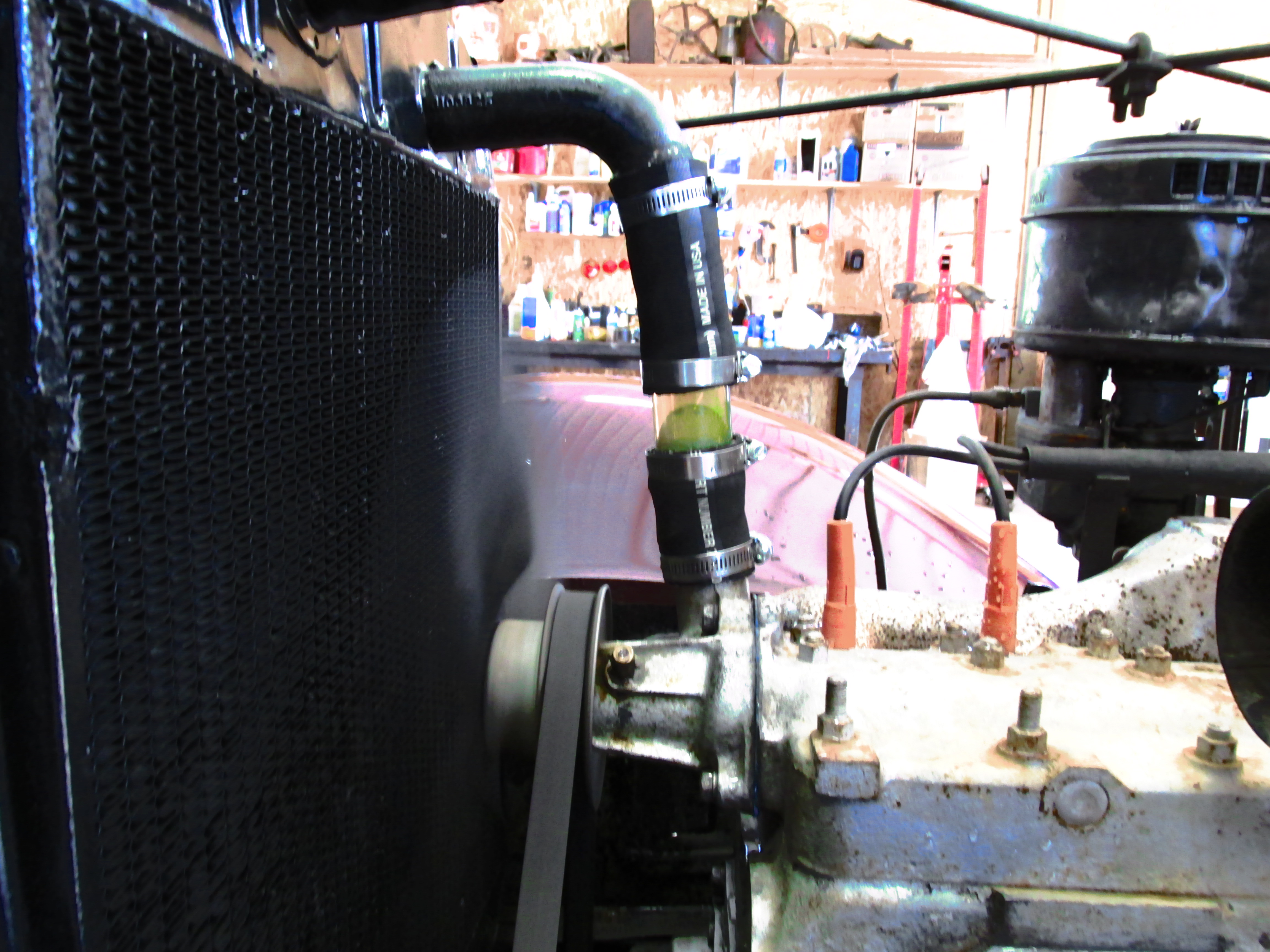

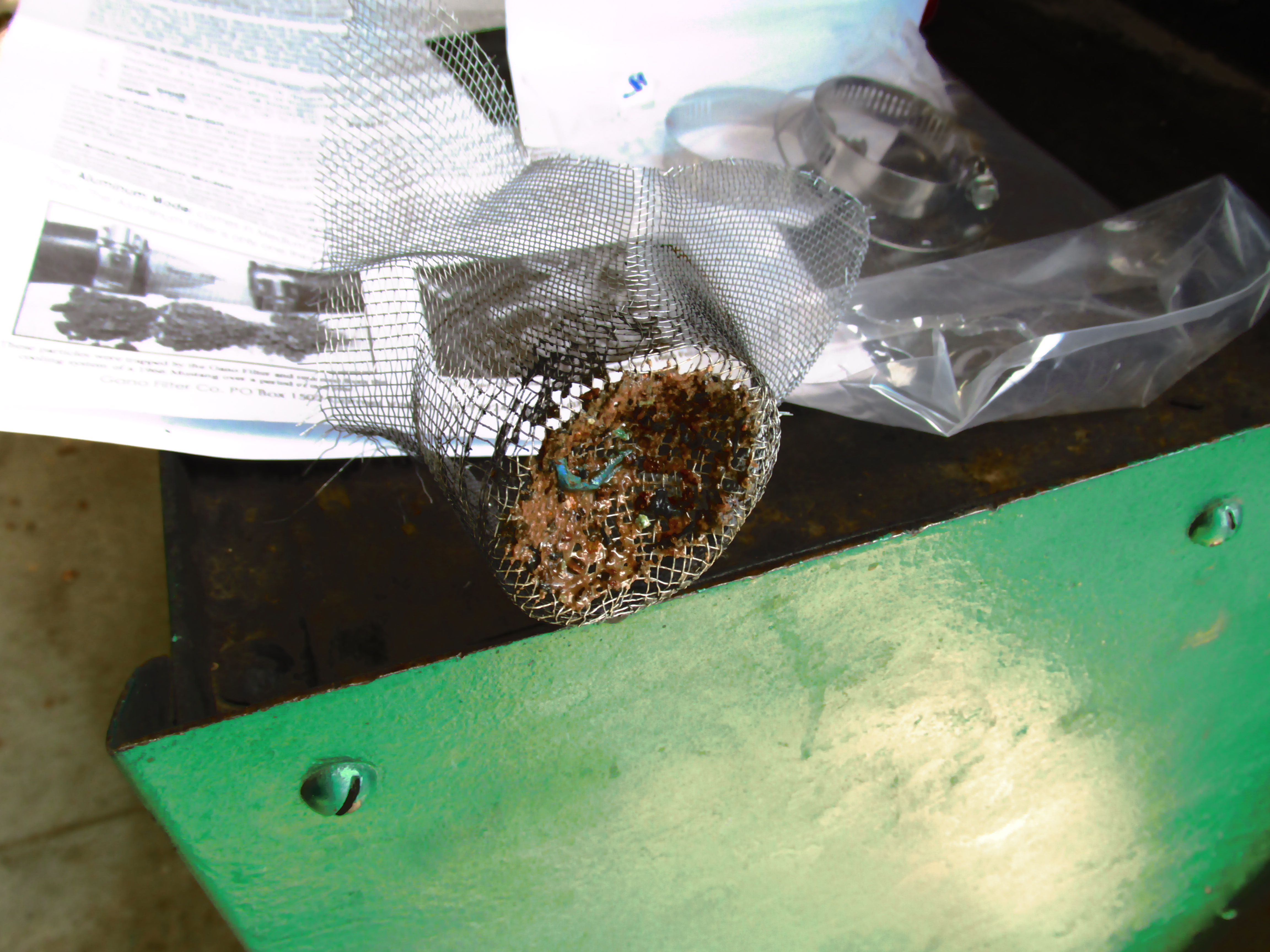

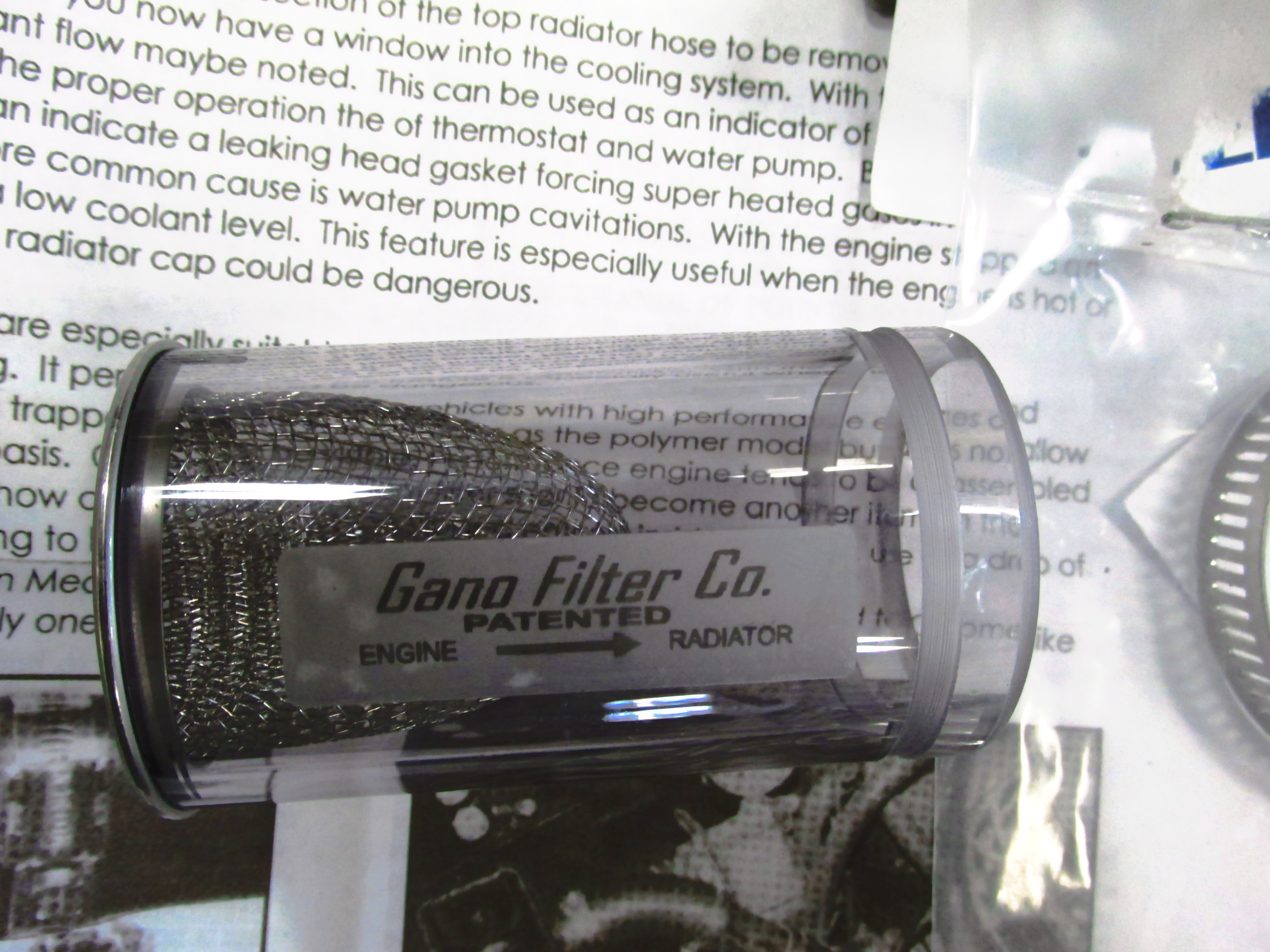

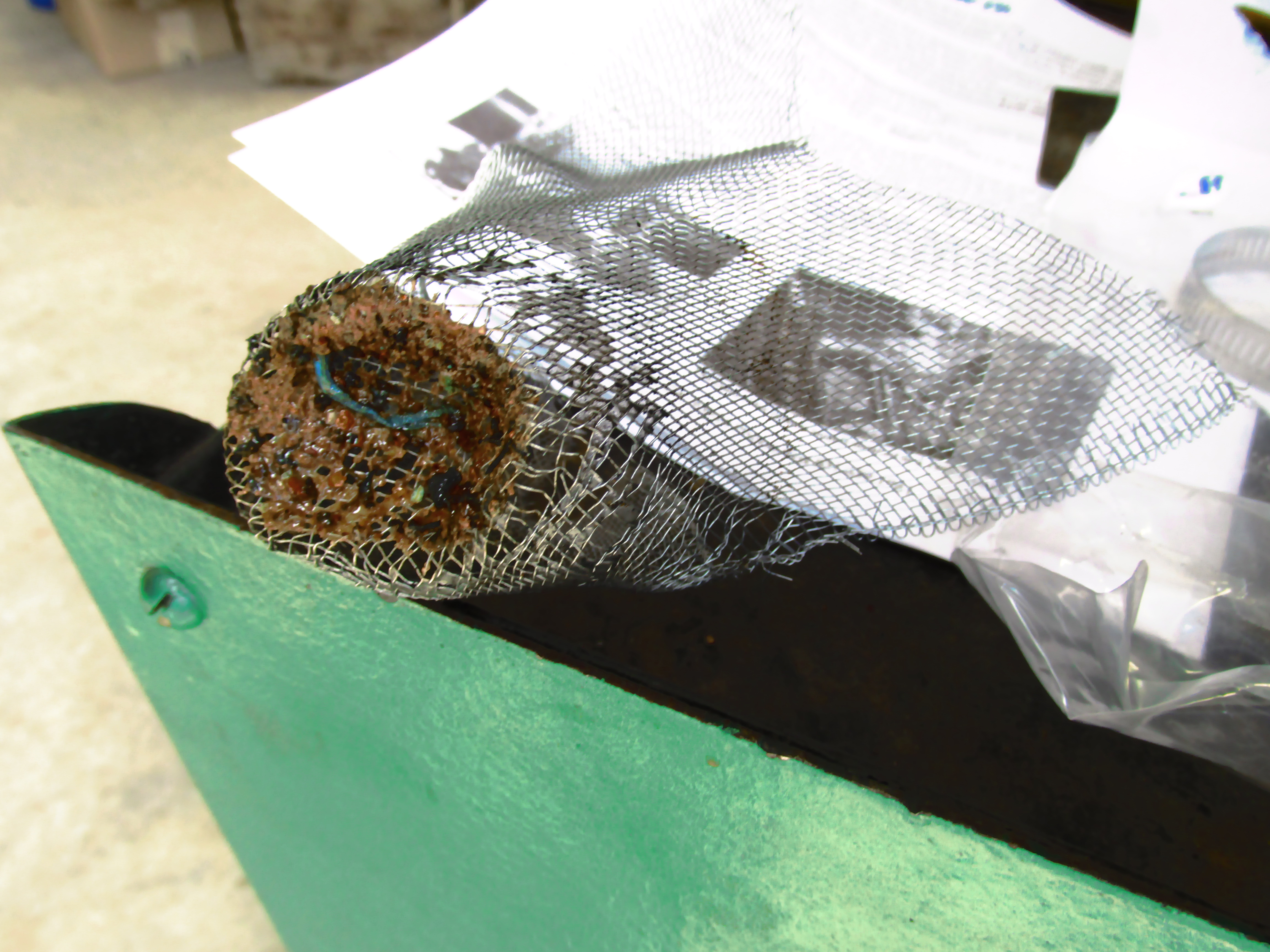

It appears that I have the overheating issue resolved. the radiator was 80% plugged. The new water jacket ( thanks Don, Ski4life65) was a godsend. To make sure that I do not have a repeat of the issue I took the radiator shop guy's recommendation and placed a screen in the inlet side of the radiator (photos 714 and 715) to catch any debris before it got to the radiator. I then installed a " gano inline filter" into the inlet line of the radiator just above the water pump outlet. I had run across these in a farm publication and thought the 35T could use the help. I purchased the clear one so I could monitor when it needs to be cleaned. photo 716 shows the filter installed. Hopefully this will rectify any overheating issues with this motor.
