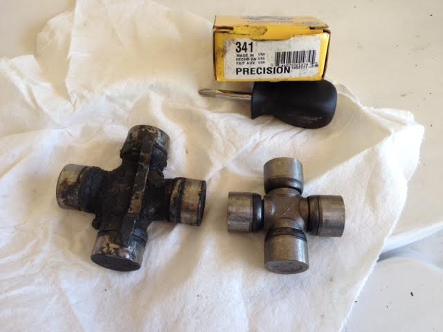

Okay, here's the issue. The u-joint for my '54 Jet is on the left. The u-joint I'm finding at parts stores (part number 341) is on the right. Obviously there is something wrong!! ha ha.
Right, the U-joints are exactly the same as the Senior models, which are exactly the same as '55-'62 Chev, Ford '49-67, etc. and you shuiold be able to just buy them off the shelf. soem numbers: Precision 329/ Wesgo N-2115-R. Spicer 5-200-X. Just take your old joint to NAPA or Pepboys and show them.0
Success!! The Napa part 369 looked to be an exact fit! I've got both of
them on the prop shaft and the shaft back on the car. NO LEAKS from
the rear axle!!
