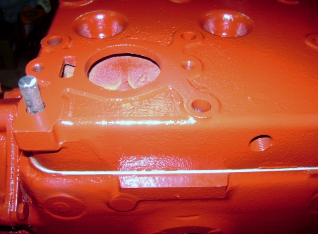

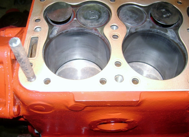

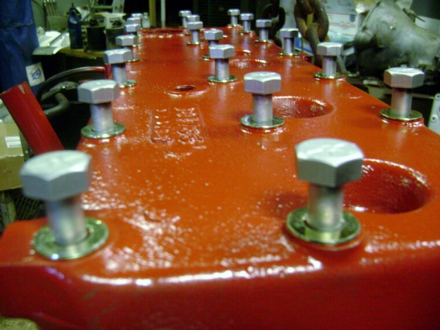

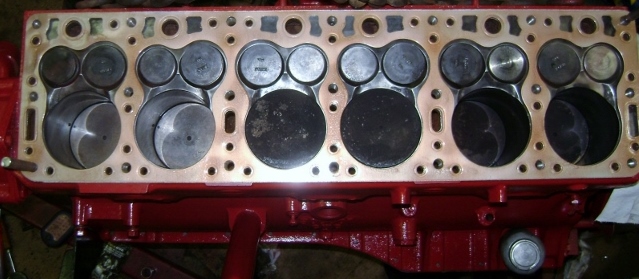

I got the cyl head cleaned up and painted and I shot a little copper coat on the new head gasket. It didn't look like a perma-torque and wasn't marked, so I shot it.
I also cut a couple 7/16 bolt heads off and used them for guide studs for the head.
The 49 engine didn't have washers so I went to Fastenal and bought some. 7/16 grade 8 SAE gold zinc for the bling.
I painted the head bolts silver to match the timing cover and pan bolts.
I torque in 3 sequences or 30/50/70 lb-ft and then repeated 2 more times.

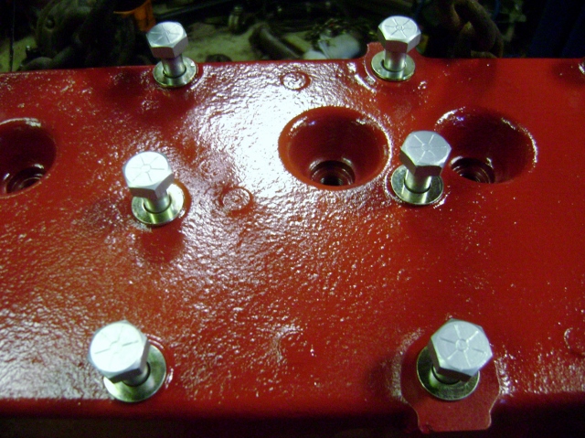

Then I cleaned up the thermostat housing and took the recommendation for this forum and installed a 1.250 freeze plug in the bypass hole.

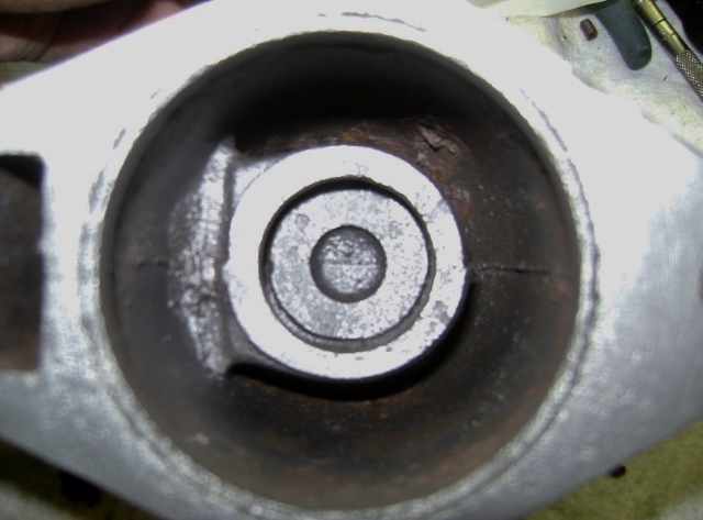

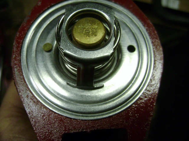

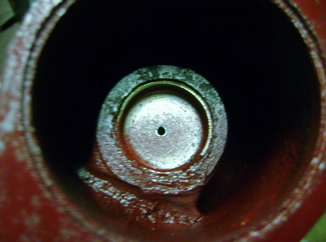

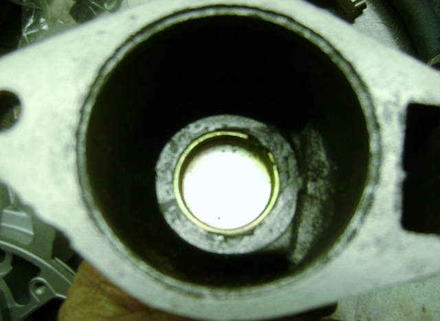

Bill, don't forget to drill a 1/8" hole in the soft plug you installed in the thermostat housing. Bruce
I believe the plug in the bypass hole should have a 1/8" hole drilled in the middle of it for the modification to be efficient according to Walt, who has perfected this modification
FYI
Always Drill a hole in the side of the Thermostat is a good Idea too.....
Thanks for the reminders guys.
Here's what I did.
Thermostat I got. 180*
It had the little bleeder in it but I added an additional bleed hole.
And the bleed hole in the bypass.

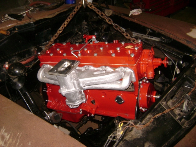

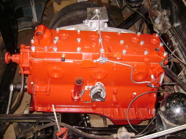

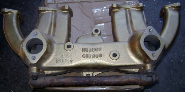

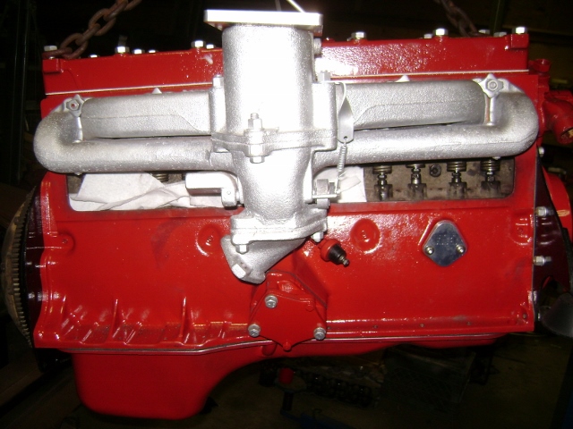

Then I cleaned up some more parts and started bolting them on.

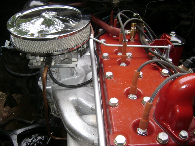

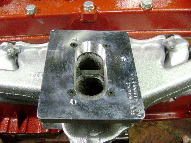

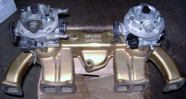

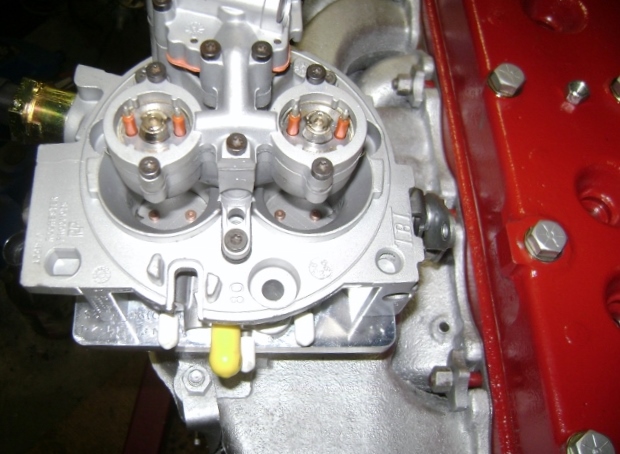

Manifold and TBI adapter.
Throttle body

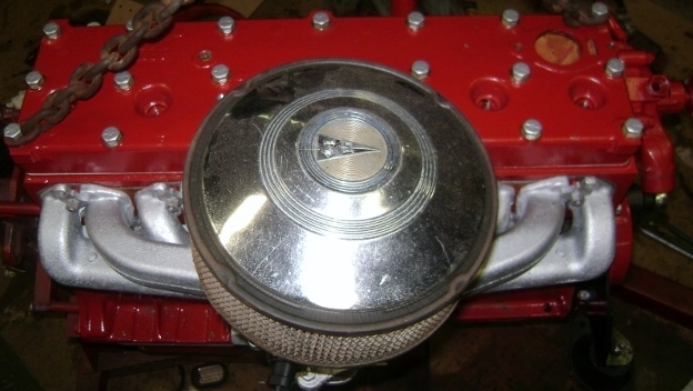

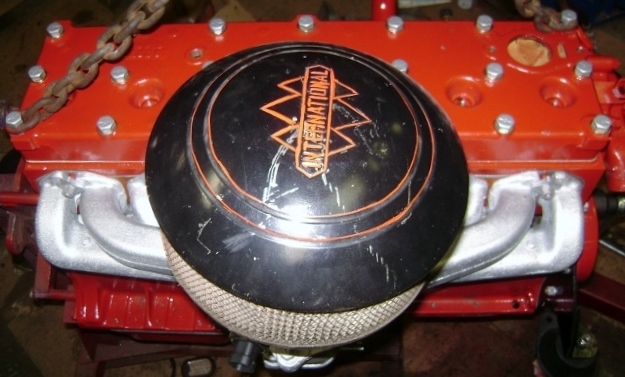

How about a hub cap air cleaner?
Maybe a Hudson cap?
Bill, looks great. Are you selling the adapters yet? What size tbi did you use? I am interested in two of the adapters. I have an idea for a twin turbo twin h hornet.0
Hud,
Don't get too far ahead of me!!
The Twin H is already set up. Once I have this set up running and dialed in with the baseline tune then I will swap manifolds to the twin H and tweak the tune as required.
Turbo may be in my future as well but not until I build my 308.
The twin H can be setup with 2- 1bbl or 2- 2bbl throttle bodies.
Other than the final tuning and the throttle connection, which may be up to the installer to configure, the systems are done.
I don't have pics of the 2-2bbl set up yet. But given the manifold bore I don't know if the 2- 2bbl setup would be of much benefit?
All of the adapters for the 1 and 2bbl versions are back from the CNC shop and in stock.
You can reach me at sales at hamiltonfuelinjection dot com

Bill-Lookin' really great!Just an observation, but a 180-degree thermostat is quite hot for a Hudson engine. Does the EFI require a hotter running engine?0
180* is pretty standard.
IIRC 170 is supposed to be about the lowest for an engine to be efficient.
You could run a cooler stat but if you try to go too cool then the computer will need to be adjusted or it will think your still warming up.
I'll look a little deeper into the Hudson specs.

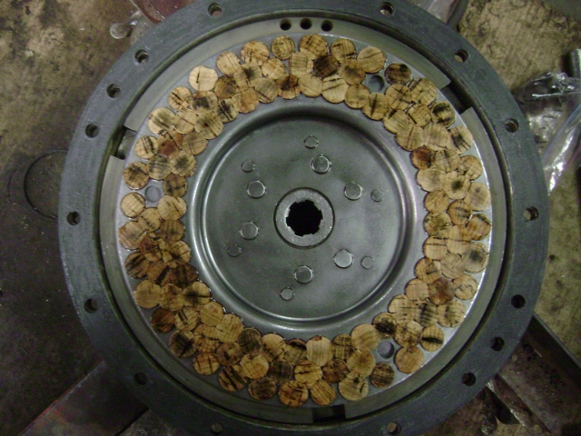

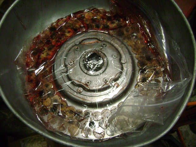

I got the flywheel and clutch installed. I was really getting frustrated trying to find the torque specs for the flywheel.
So I finally just went with my IH 3/8" flywheel spec. Then I find a list in the clutch supplement and it said half of what I just torqued them to.....so more digging and I found a reference to the correct torque. What a roller coaster.
I went ahead and soaked the new disc in type F just cause I could.
Then wiped it off and installed it. Not real sure why the 3 corks are left out of all the new disc?
I also soaked the new throw out bearing leather seal in oil prior to install.

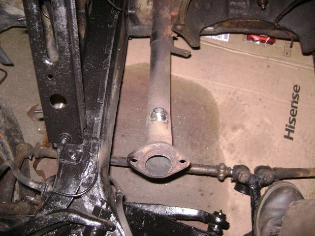

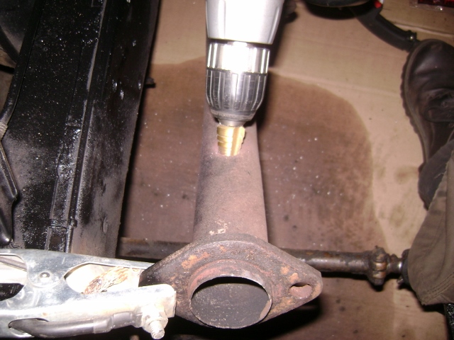

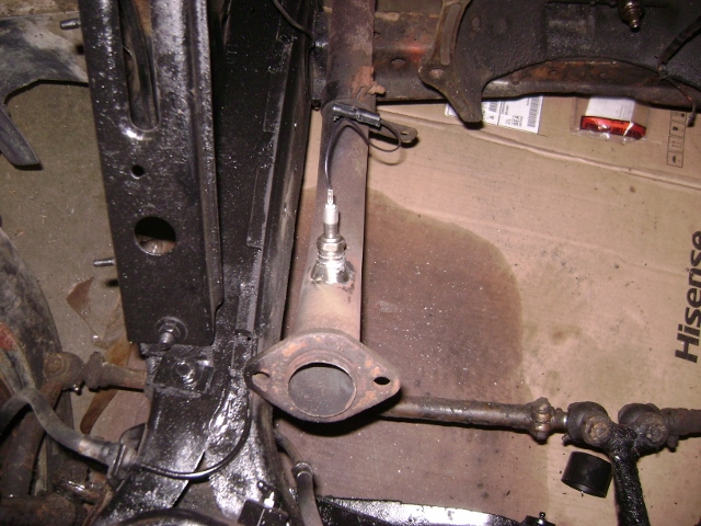

I also added the O2 sensor to the header pipe while the engine was out.
Drill the hole
Weld in the bung
Screw in the O2 sensor.

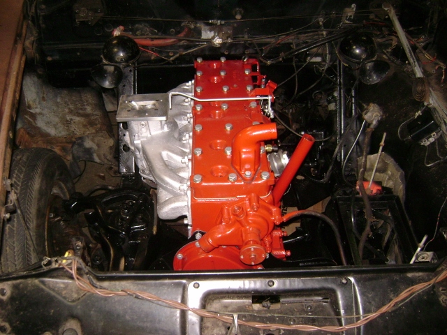

Then dropped the engine in.
Back in it's home!
Dr. Doug told me that the reason for the three corks are left out is for more efficient clutch fluid circulation.0
My initial thought was it was the same as they do in an automatic with the clutches and band drums by having holes that allow excess fluid a path to escape quicker for a better apply. Keeps the friction material from riding on the fluid as it is pressed together.
Then the more I thought about it then more I wondered if there was even any fluid on the clutch plate with no pressurized fluid or really hardly any fluid in the clutch.
6 oz in a clutch that size with centrifugal force slinging the fluid to the outside as it spins, how much fluid is really on the clutch plate with the engine running?0 -
As mentioned, I opened up the manual and this is what it has in the 48-52 cooling section.
Starts to open 150° to 155.
Fully open at 185°.
So the 180* is still within the range but at the top of it.
A 170* would probably be the norm.
Now that the engine is in and running my temp gage is reading just above 1/2.
I'm currently running a 12v neg gnd battery for the engine/EFI and a 12v-6v regulator to run the rest of the car.
So far everything is working including the overdrive.
No other mods have been done.0 -

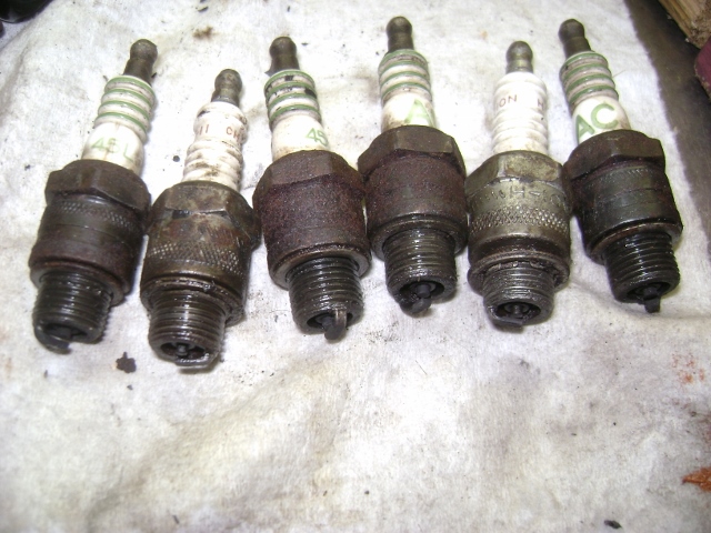

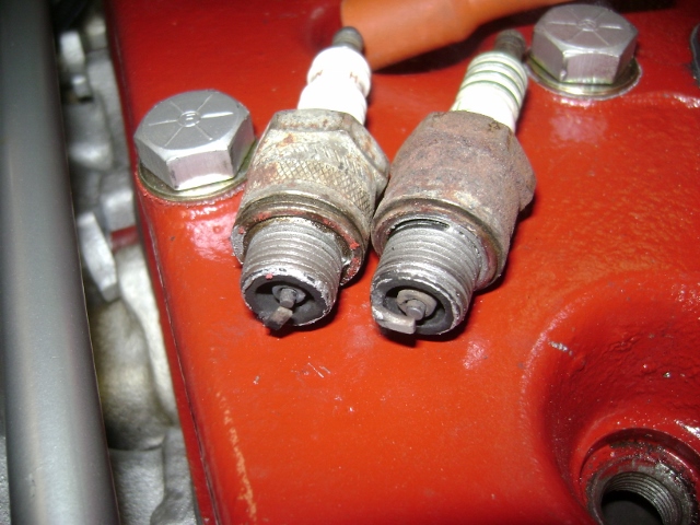

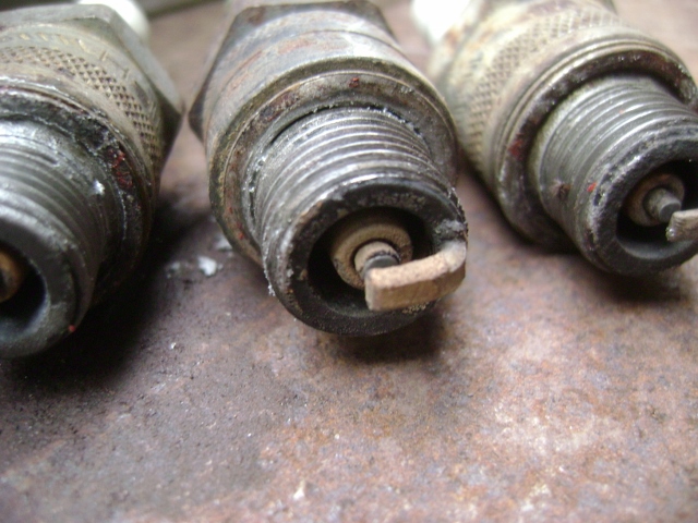

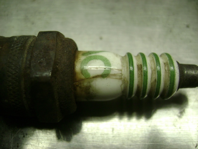

Well I was tracking down a misfire and since I upgraded the distr and plug wires about the only thing left was the old plugs.
I ended up finding a miniature Jacobs ladder on one plug.
I put another used one in it's place but I guess I should spring for a new set.
I will say that having the correct air/fuel mixture and a good ignition makes a big difference in plug life.

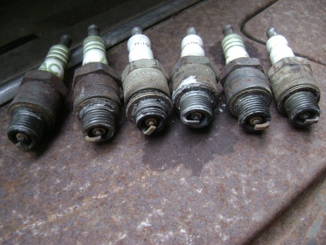

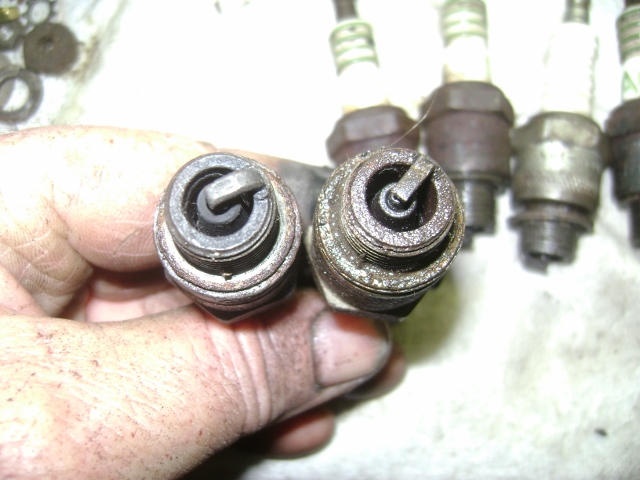

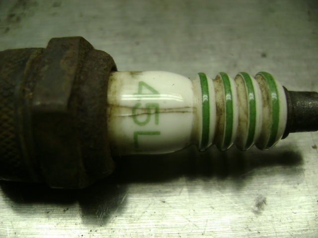

Here's the old plugs I removed from the engine when I got it.
And after a little running on the EFI. You can see the old carbon build up is burning off and they are getting back to a nice ash color.
But I think it's time for a fresh set.

Suggest putting Chrome Acorn caps on those head bolts to match the chrome air filter from a local Truck Store, JC Whitney, or Iowa 80, www.Iowa80.com
I know I should be "committed" for taking on another project with about 20 of them already in the yard!
Racer, thanks for the tip. I was planning something like that on my 308 build when using the ARP studs ad nuts.
I still need another Hudson hub cap to make my Hudson chrome air cleaner.

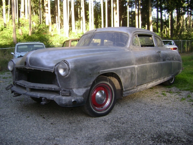

A little update.
Since getting the engine/EFI all working I have been driving it and slowly working out the bugs.
Still need to install my new steering center pin and the new front wheel cylinders. After pulling hard left I fixed the plugged right front brake line and now it pulls hard right. So I got 2 new cylinders to go in.
The old worn out 262 has been running pretty good considering. No smoke and it seems to pull pretty good. So far I have only braved a run up to about 100mph and lifted. I didn't want to have to make an emergency braking and end up in a ditch.

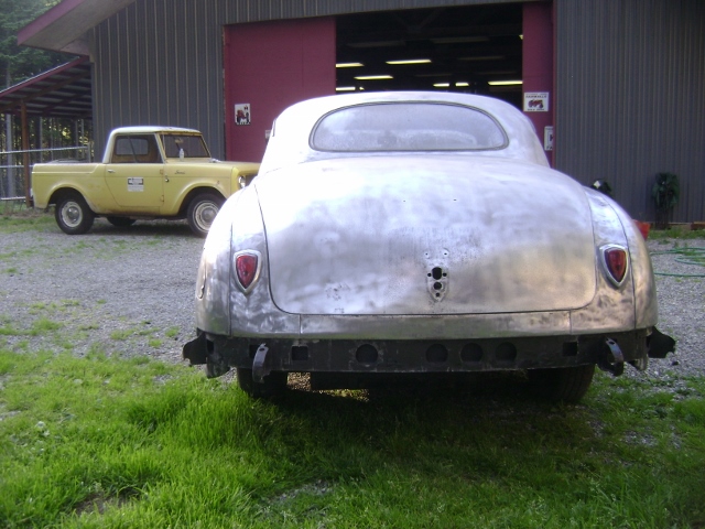

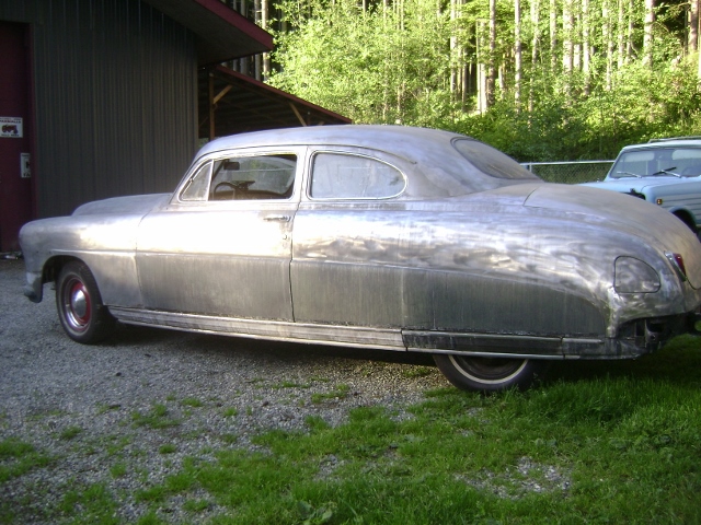

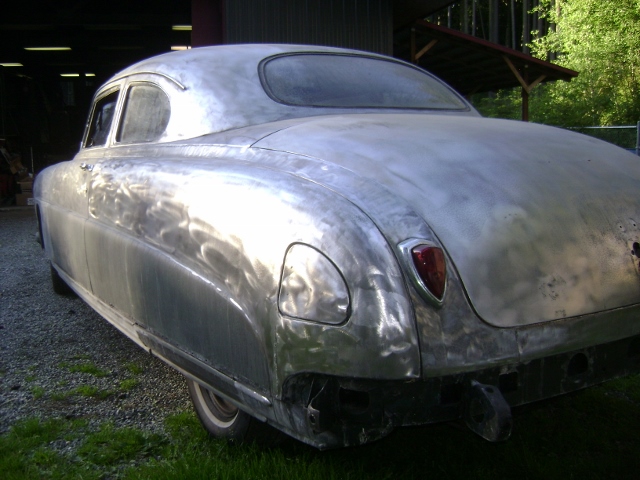

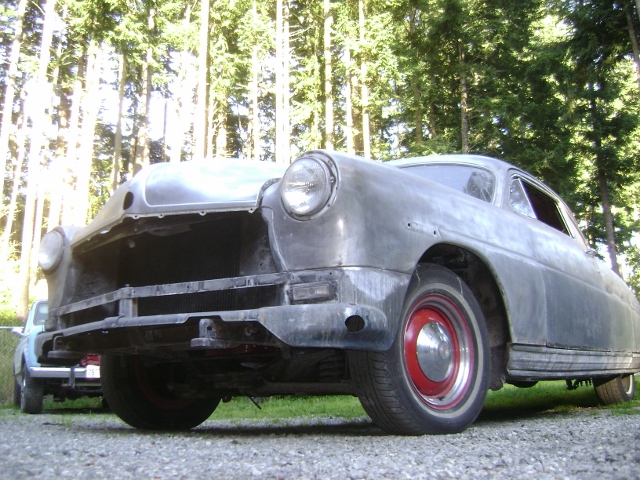

I have also been spending a lot of time sanding and acid etching the body to remove all the surface rust out of the pits in the sheet metal.
Right now the plan is to just leave it bare metal and maybe use some meta protector on it until I can work each panel. Then I'll go with a coat of epoxy primer as a base. Still debating where to go from there.
I removed all the previous owners body filler so I can work all the bad spots.

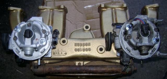

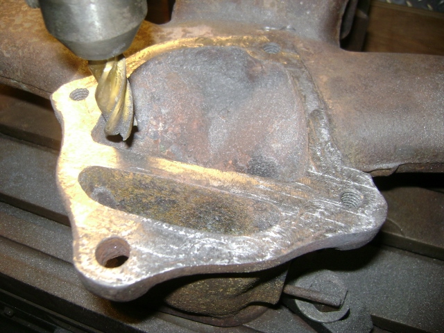

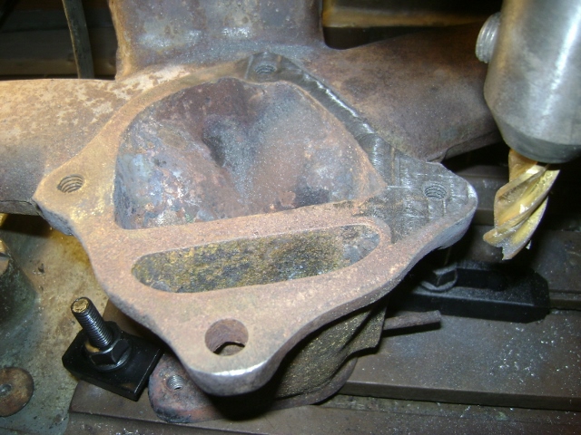

I also started working on my Twin H EFI setup. I separated the manifolds and chucked the exhaust manifold up on my little mill and used an end mill to surface the gasket flange. My plan is to cap it with a gasket and thin sheet meta plate and then bolt the 2 manifolds back together so there is no heat riser going to the intake. Once all this is working then the next phase is to build a dual outlet flange similar to the factory one and install some 1 3/4 or 2" duals under it.
Here's some pics.

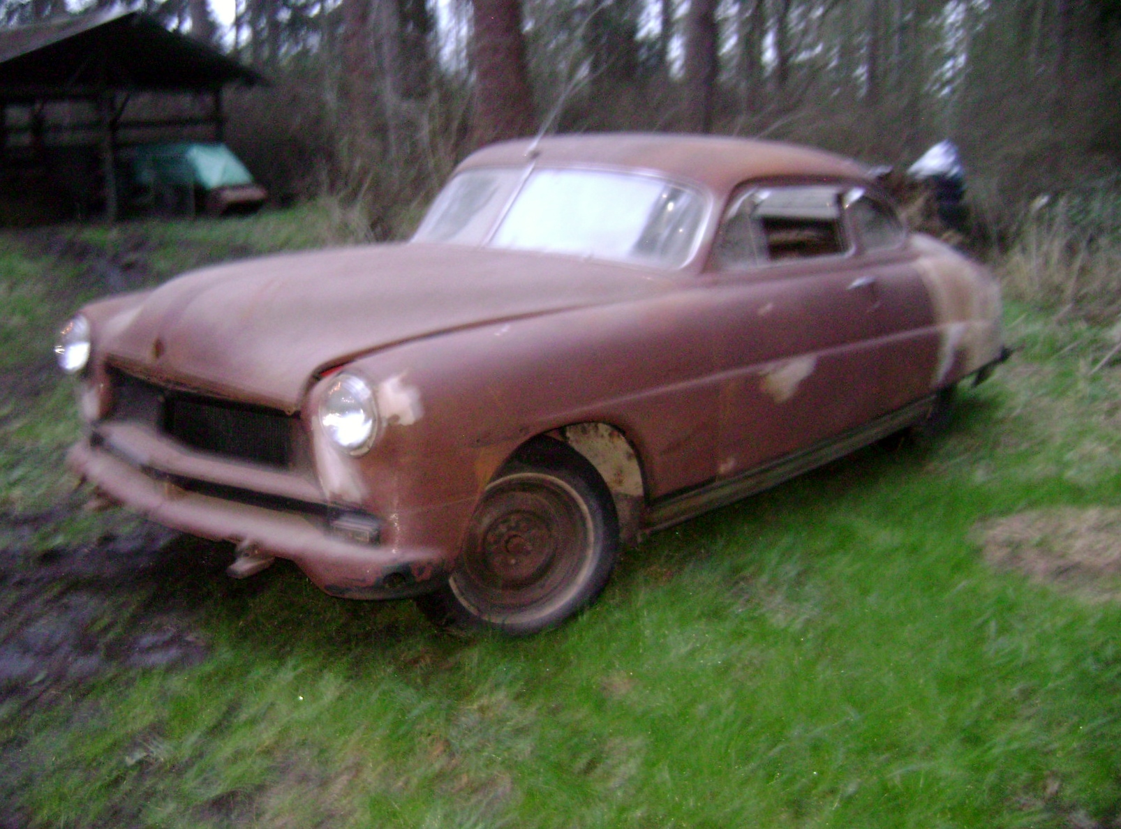

First a before, when we first dragged it out of the shed. Then the current condition.
