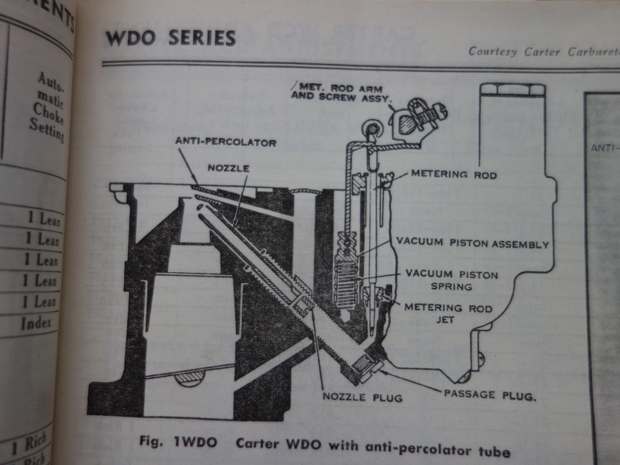

I
just found some info on this in a 55 motors manual. First of all it says the WDO,WCD, and WGD carter carbs are very similar to each other; Then ,where it is talking
about WDO carbs, it says in part:
"Prior to 1939 these carburetors used valve type anti-percolators. During
1939 , also some models were equipped with an anti-percolator in the form of a
tube, Fig 1 WDO.Here
hopefully will be a pic of Fig1 WDO I will try to upload to this thread:
Then a little further in the Carter Carb section of this Motors manual,when talking about the WCD carb it says in part "The anti-percolator valves are not used. A special series of vent passages in the high speed circuit act as the anti-percolator without the need for mechanical valves.This info does help some but I still don't see how it works. lolRob0 -

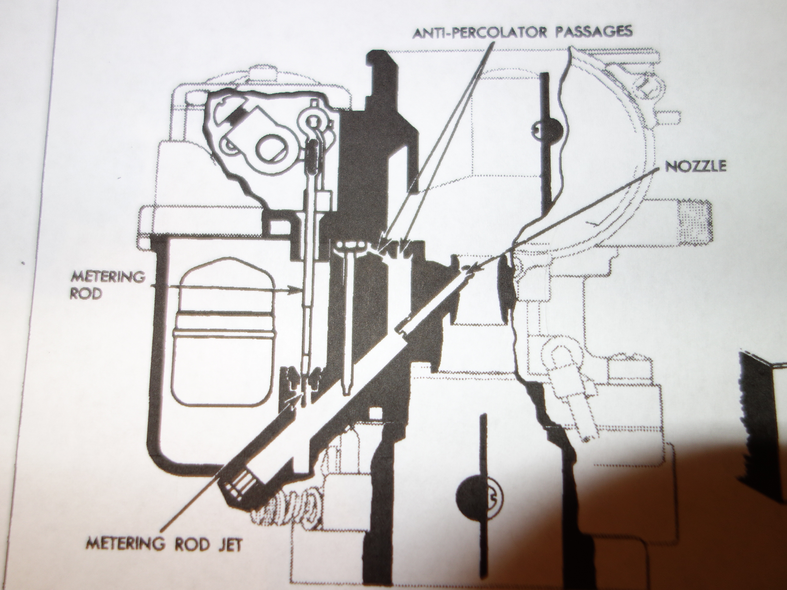

Thanks for your ideas Hudson Grandpa, no I don't have my gas line from the fuel pump to carb insulated; I may have to try that.I think I have located the anti-percolater well that is referred on the WGD carb spec. page in the Hudson manual.I think it is actually two wells with small holes venting them to atmosphere. They are located about 1/2 to 3/4 inch before the end of the each main jet . The small holes stick straight up and you can clearly see them when you open the choke plate wide open and look down into the carb. The spec sheet says they are drill size #66 and sure enough when I put a #66 drill into the holes it just fit. A #65 bit was too large to fit so I am pretty sure this is the holes they are talking about. I wish I could find a drawing that shows the internals of the WGD carb but I'm not sure one exists.Here is a pic looking down into the throat of a WGD carb. The two wells are at the bottom side of the opening in the pic. One on each side of the accelerator pump jets. ( I was trying to modify the picture showing the parts identified with arrows but I wasn't successful. I was trying to use Microsoft word to do it but I couldn't attach the completed Word document)
By George, I think you've got it !!
Thanks for the post, having the same issue and Walt pointed me to the anti-percolation idea. I found this link for the inside of the WGD, choose the 6b download page 4.www.pontiacsafari.com/55/shopmanual0
Thanks befishers1, it's great to finally see a an internal view sketch of what the anti-percolating circuit on a WGD carb actually looks like. I think I will try to take a pic of the sketch and post it here to help with the continuity of this thread.Since I last posted to this thread I have installed the 3 port fuel filter with the 3rd port going back to the gas tank. At first this seemed to cause more problems . Now when I took the car out onto the freeway and accelerated hard the engine would cut out. It was like the new bypass line going back to the tank was taking so much fuel that the mechanical fuel pump couldn't supply both it and the carburetor.I ended up doing 2 more things and so far it seems to be working with no flooding problems with the hot engine and no cutting out on acceleration.This is what I did:1. I took a 5/8 inch long piece of 1/4" diameter steel rod. I then drilled a 3/32 inch through hole in the center of the end of the rod. I used this as a restriction in the line going back to the fuel tank from the 3rd port of the fuel filter. Since the 3 port fuel filter is installed with short lengths of rubber fuel line and hose clamps I just inserted the restrictor in the the middle of the short rubber fuel line that connects the 3rd port of the filter to the fuel line that goes back to the fuel tank. This restrictor reduces the amount of flow going back to the tank.2. I had learned from guys on this forum that sometimes you need to have a bypass check valve installed around the Carter Electric Rotary Vane fuel pump. This check valve is used to reduce the restriction that is created when the electric fuel pump isn't in use. I was still having trouble so I added this check valve.I found a great check valve on ebay. It takes very little pressure to open it and it can handle a good volume of flow. I used the 8mm size for 5/16" fuel line. Here is the link to it on Ebay http://www.ebay.com/itm/390801413623?_trksid=p2059210.m2749.l2649&ssPageName=STRK:MEBIDX:ITThere is also something that I forgot to mention that I should probably have mentioned much earlier in this thread : Back when I was checking the size of the anti-peroclating ports with the #66 sized drill bit I found that one of the anti-percolating ports was at least partially plugged . It was probably old gasoline residue that had built up over the many years. I also think that when someone boils out one of these carbs during a rebuild it probably makes these antipercolating ports even more plugged. This could be a significant part of what is going with these wgd carburetors.I have driven the Hudson a few times this summer on pretty warm days with no problems.RobI0
