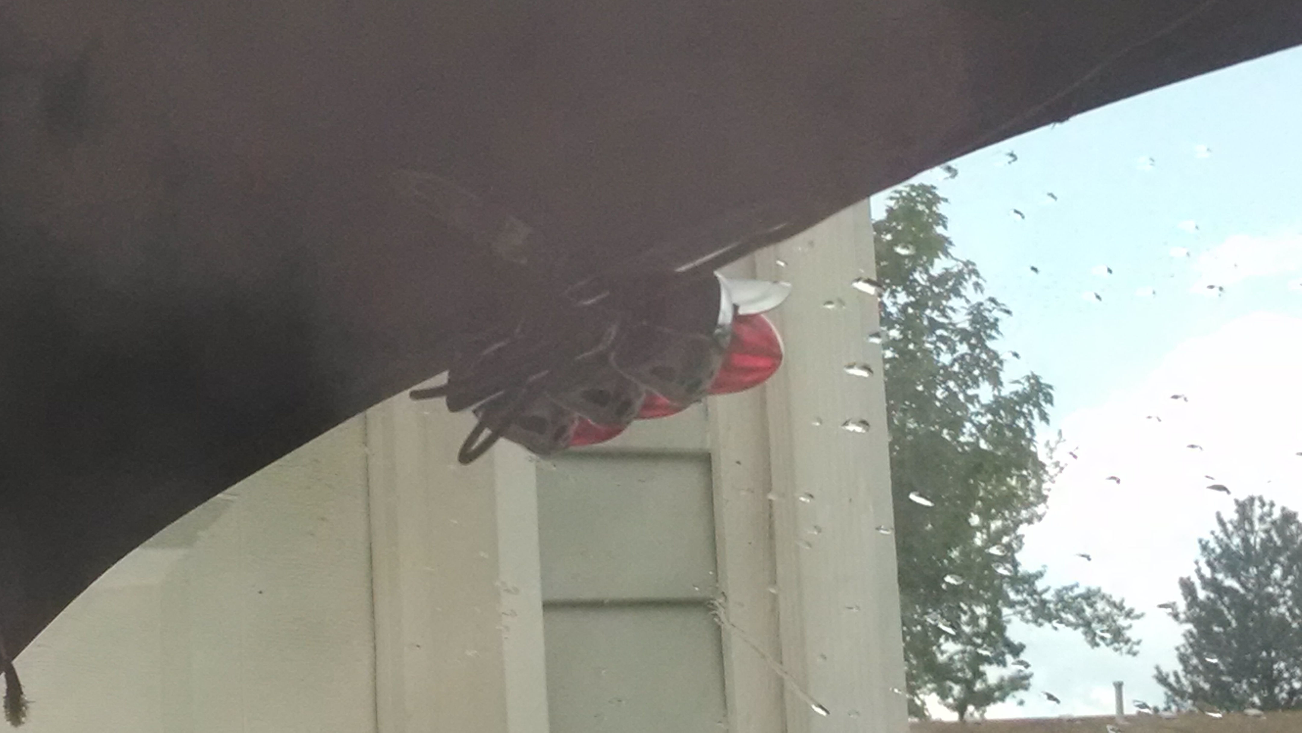

Here's mine: 3 'bee-hive' lights
#30109 from taillightking.com
Sorry for the poor pictures.0 -

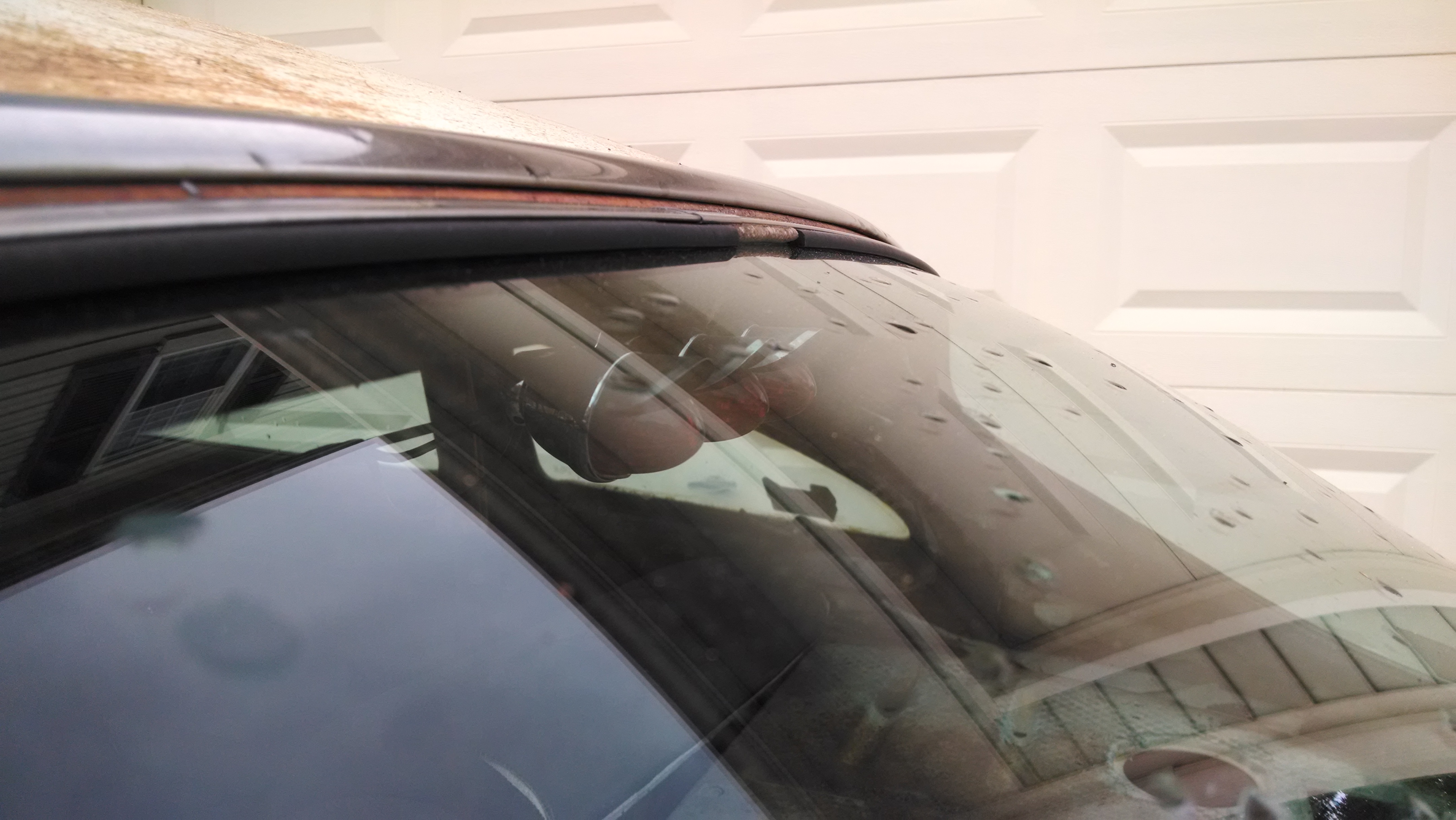

Works great and wilth a little imagination you can put them in without cutting any holes

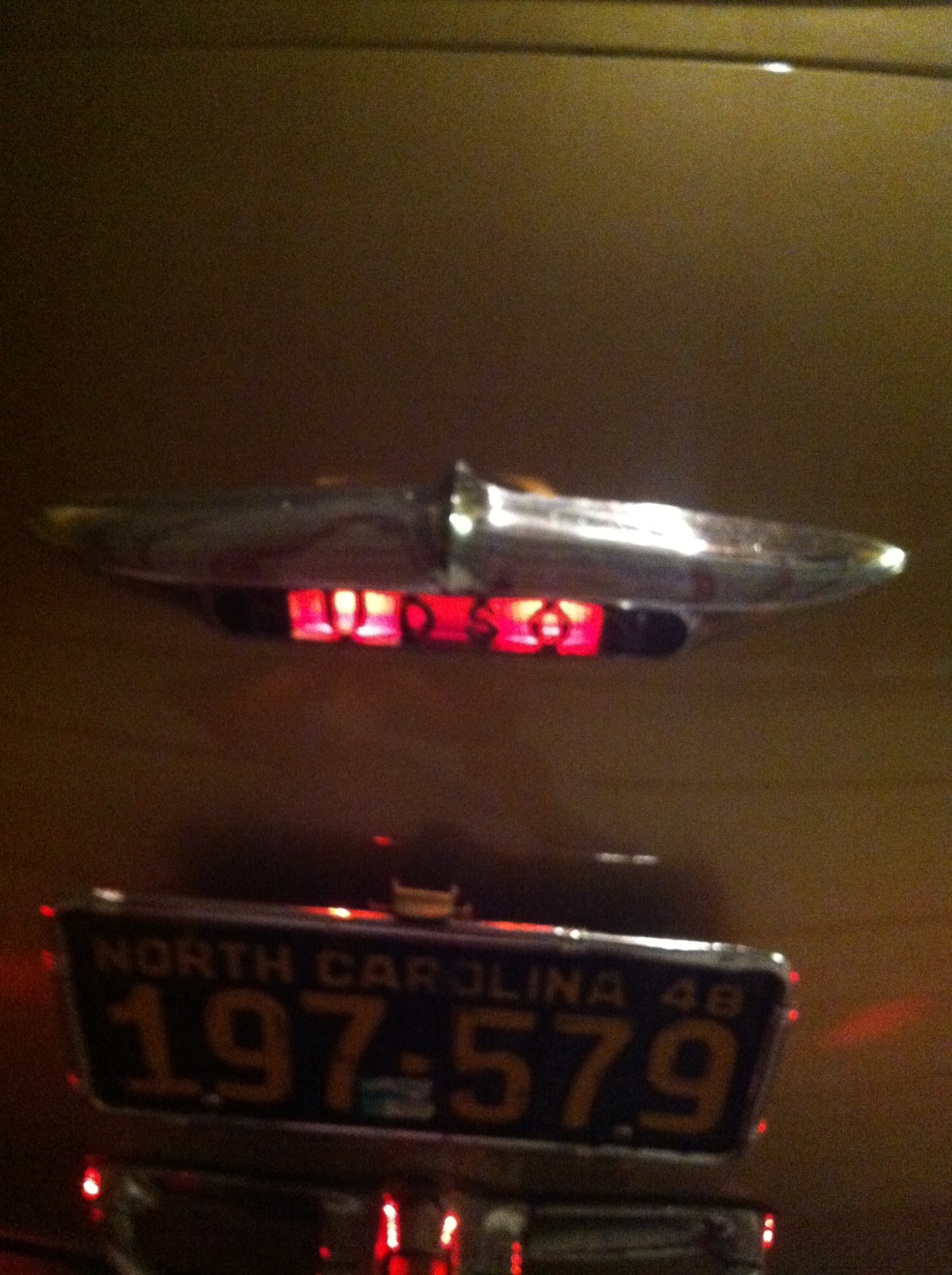

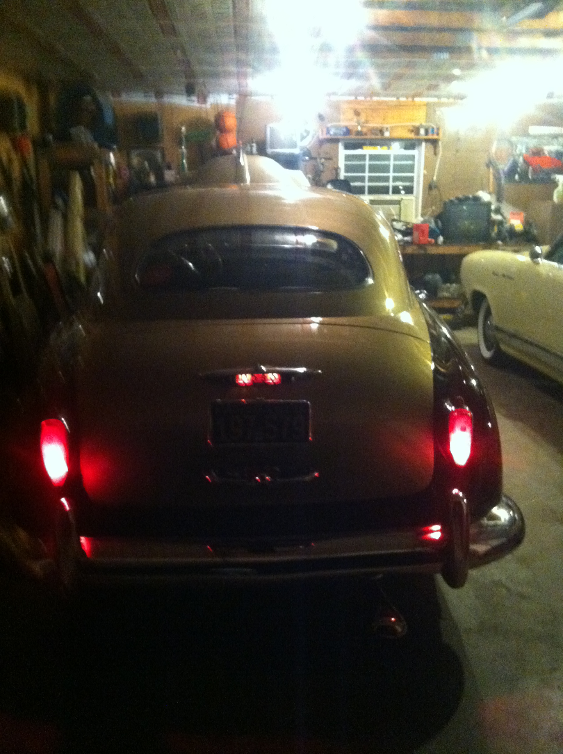

I made a third brake light using the trunk emblem. I cut out the spaces between the letters and put a red lens and some bulbs behind it that were attached to the brake lights.0
Post a pic Jason. Sounds neat.0
Okay Dave,Here are some pics of the homemade 3rd brake light.0
Jason, That is one great idea. I just might have to check out my 54 and see how it would work for me... Thanks!0
I thought this up about ten years ago. What's really neat is that in the daytime, it looks just like a regular trunk emblem.0
