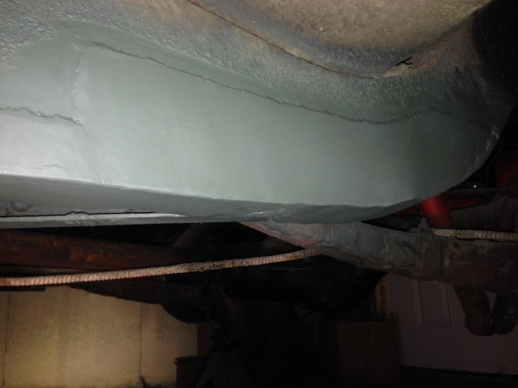

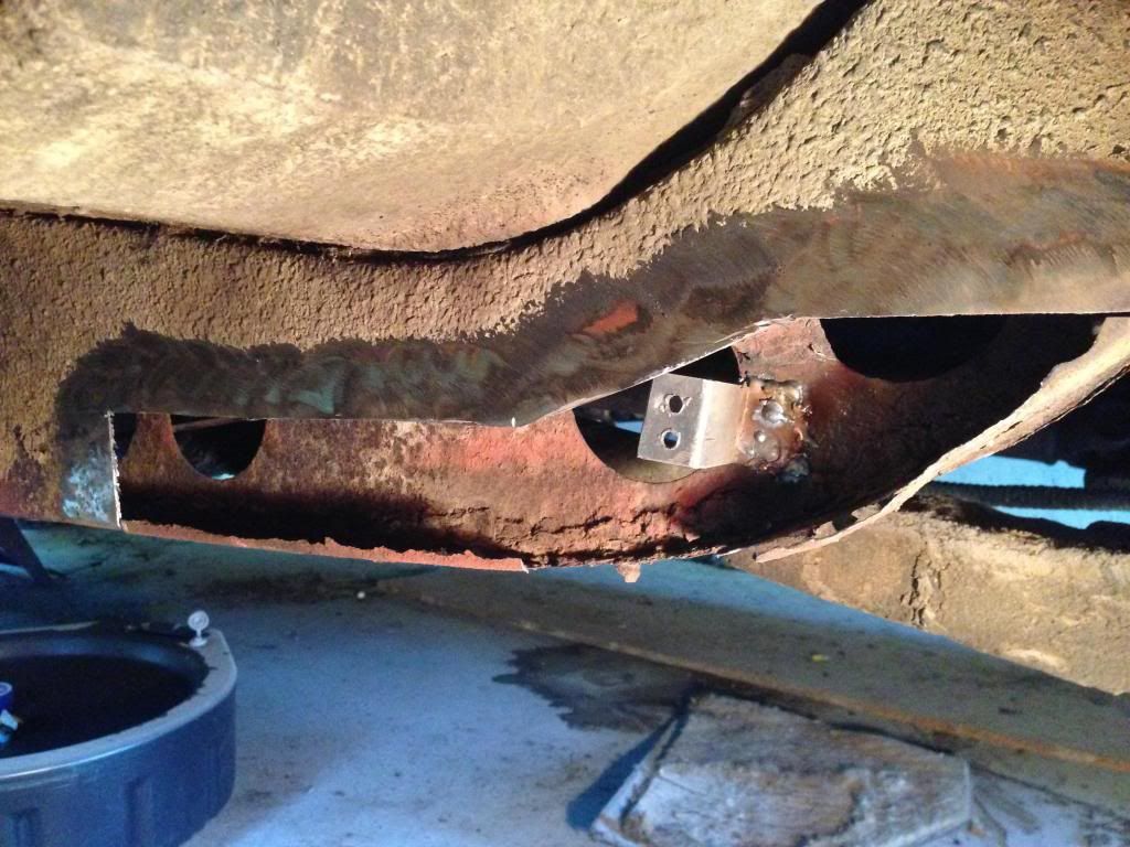

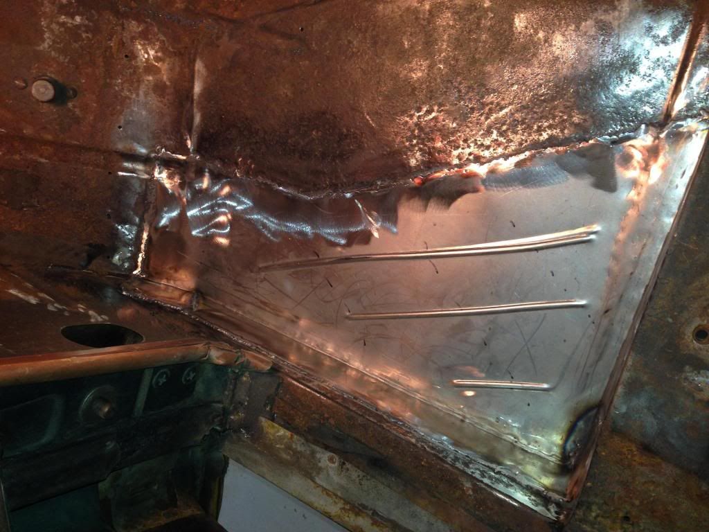

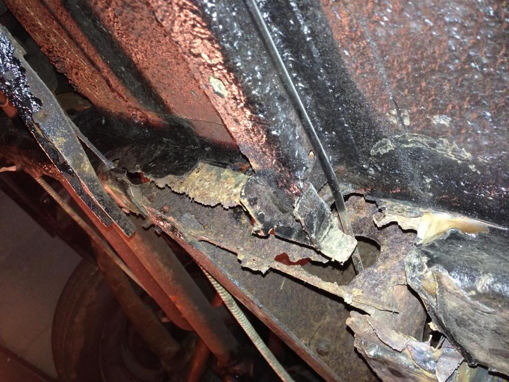

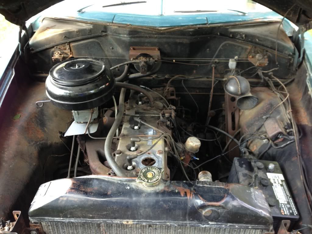

But when you dig down a little, it becomes clear she's not exactly new. What you may not be able to see is the front-most water neck mounting hole is broken off the front of the head.
Also, there was just a SMALL amount of frame repair needed...
Luckily I came armed with a MIG welder! :evil:
So this is where she sits today:

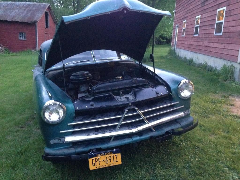

It came with spares of just about everything, as well as most of the documentation you could ever want (including the 1950 original bill of sale!). Right now Bluega is running, but not without issues...
While the stuck clutch did come free, the pedal is VERY near the top of the range to engage, and the clutch slips easily when changing to 2nd. As of yet I can't get it to slip once engaged, and I haven't yet had a chance to try the adjuster. Is the high engagement point normal, or should I be preparing to pull the transmission?
The driver's front shock mounting plate is not only gone, but part of the a-arm mount for it is gone. Fear not, a fix is in the works, I simply need to wait until I have access to our lift (the Buick is currently immobile on it).
Most of the chrome isn't on because it will be getting painted. Unfortunately no body shops have time to do so before the Great Race, so it will be rattlecans. At least they will be matched to the original Oriental Green thanks to Tower.
Finally, the most worrying, there is a shaking experienced when turning left, that permeates the whole car. When turning right, smooth, and when traveling forward, a very light shuddering (light enough I had to concentrate to notice it). I suspect this has something to do with the thumping when the car misfires at idle (the carb is running exceedingly rich). The tires are new and balanced, and the steering is tight. Right now our working theory is a slightly tight brake drum on the driver's side, or worn/missing transmission mount. Better ideas?
A minor annoyance, with a brand-new exhaust... There's still a leak. It's either in the header or the heat riser, but I'm having trouble pinpointing where, which is surprising considering how loud it is. Do the heat riser flaps often have this leak issue?

The frame rust is typical of a Hudson that's probably been left outside, or driven on salty roads, at some point in its life. Once the problem is fixed (and you seem to have thrown yourself fearlessly into that) it may never return again. So long as you garage the car on a nice concrete floor.

Real Nice job on the Frame repair. Thats a common problem with Hudson's that have sat a period of time..

The shudder you feel turning left may be something loose in the front end, perhaps a couple suspension mount bolts are not tight allowing slight shifting on turn, Suggest look closer and/or put onto a front end machine.
For Carb richness, check if the Air Cleaner is clean. I would use a Paper Element then try adjusting the mixture screws. If need any Carb Parts contact Daytona Carb (In Fl) to overnight them, or bolt on any modern V8 carb that will fit.
The Exh Damper should be free and swivel. Sometimes the flange elbow below the manifold will crack and leak or the flange gasket isnt tight. Rarely a Manifold gasket will leak or an 'ear' may be cracked, but shouldnt stop your competing.
When assemble The thermosat housing after stud repair suggest putting a 1" CUP Type soft plug in the inside Top of the goose neck to plug the original internal ByPass, then drill a small hole in the center of the plug and in the side of a modern Ford V8 Thermostat # 3043320Delco or Equilivant.
