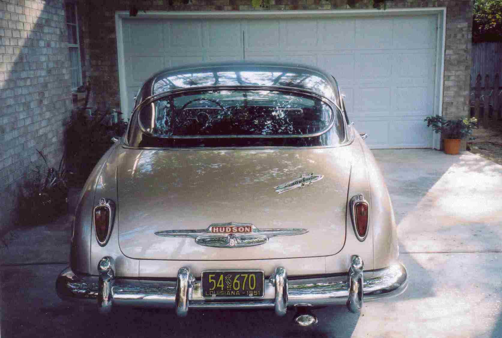

My Avatar shows the proper bumper, if it's large enough to make it out. Previous owner of my '51 decided it would look good with the stainlss trim around the cabin from a '52 was added- course the '52 dimensions on the rear quarter are not the same as those on a 51, and... Walt-LA0 -
