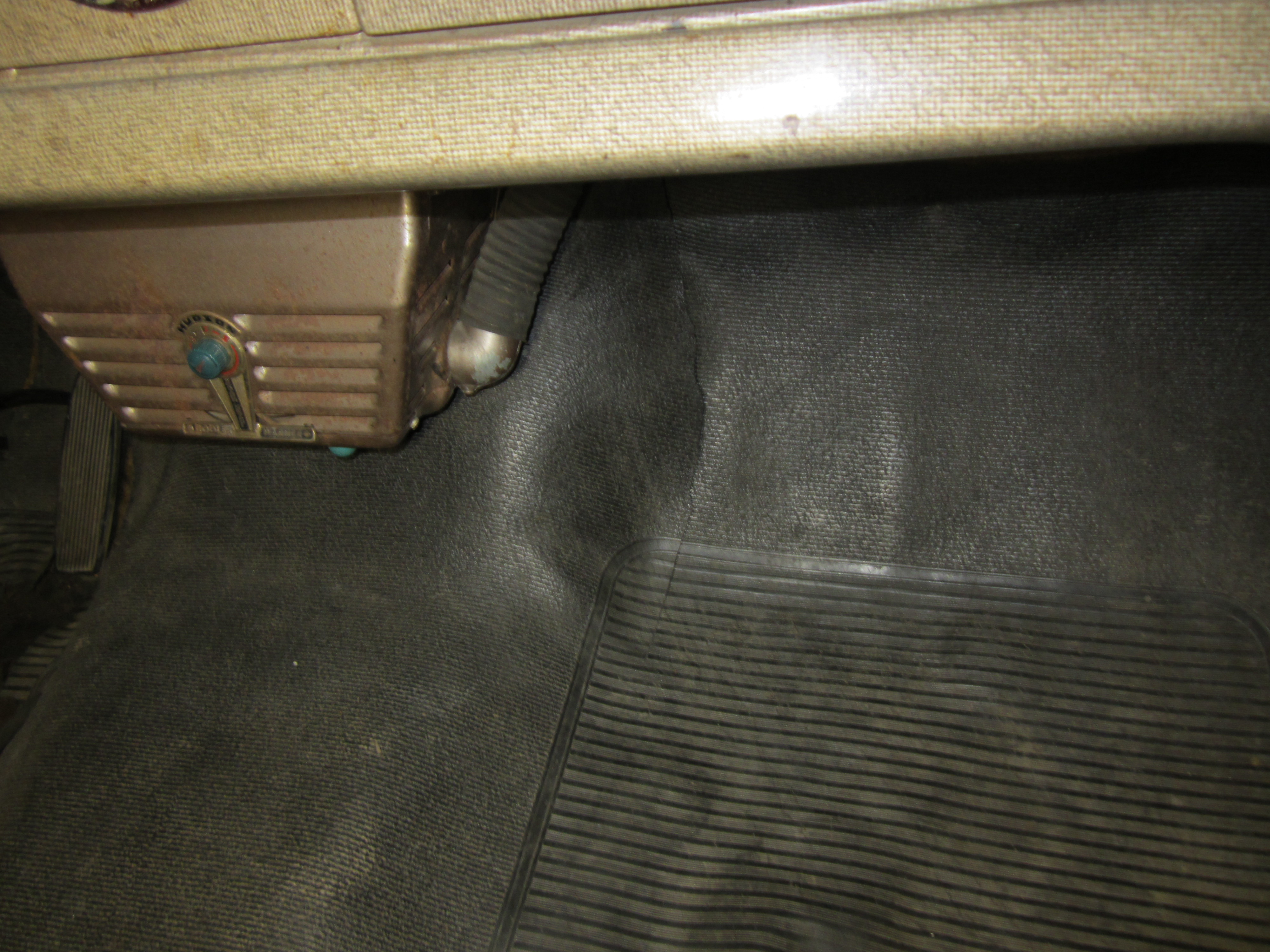

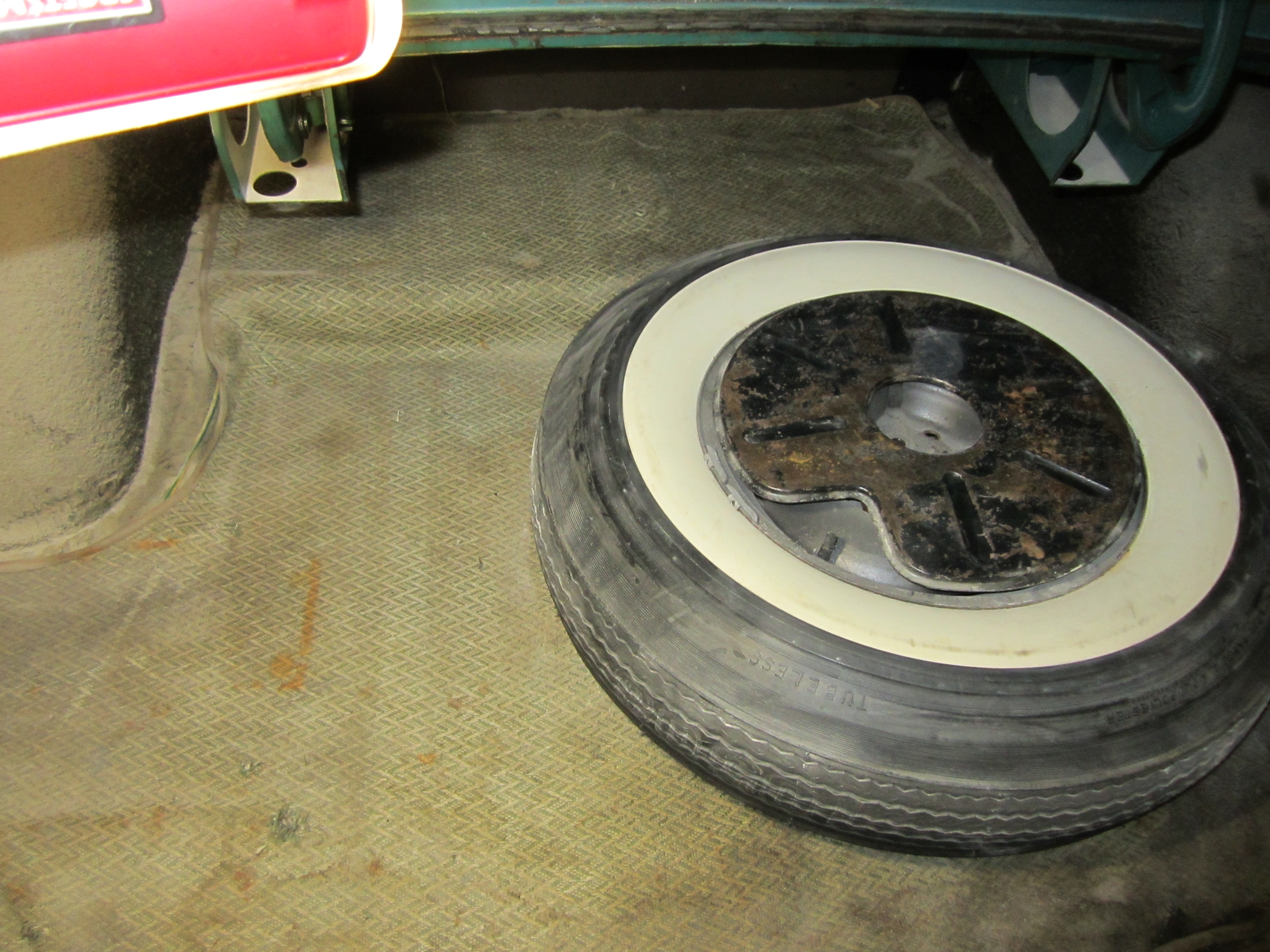

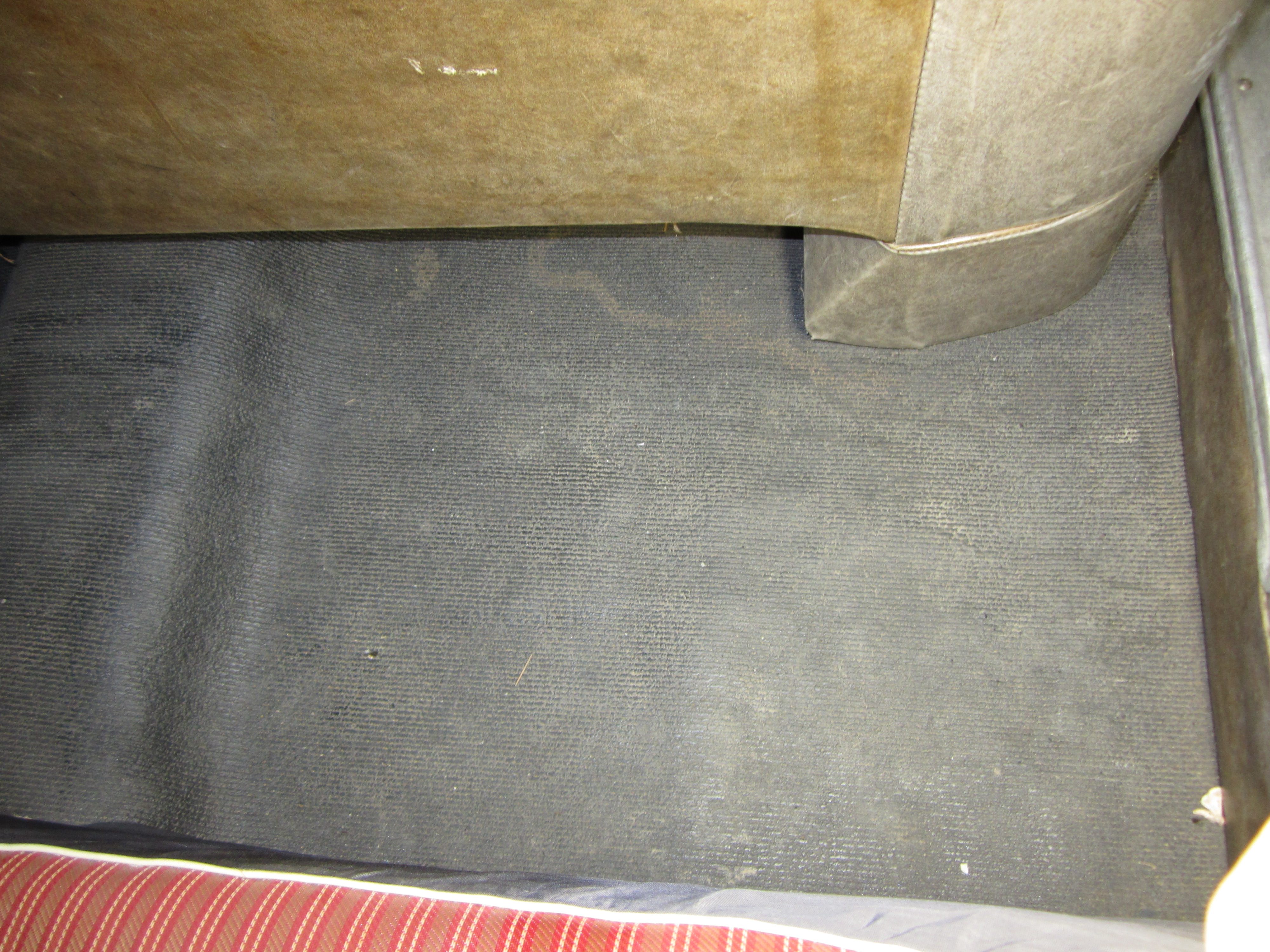

Here's what I have in my 1950 Pacemaker Deluxe Brougham (50A). I believe it to be the original and will understand if someone says it is not. There are red seat covers over the original upholstery so don't let that throw you off.John Forkner0
John,
I'm guessing that what you have is original. Interesting that the pattern in the rubber is more like broken lines than pebbles.
The trunk mat looks like what my father described. Seeing the picture also triggered my own memory of a dirty, oily version of the same thing in the trunk of my car back in the early 70's when it was still running.
Thanks for pictures - now to find something like it.
John's is greatly different than my 49 and little doubt both are original. Another change for what reason?0

The quoted statement above is correct. The rear floor came with a carpet covering standard. If you desired a rubber covering that was to be had. The four different original Pacemakers I owned all came with carpet on the rear floor.My 50 Pacemaker Deluxe has rubber, but non original style in front and back. However, I do believe that the cars from the factory actually had carpet in the rear seat floor area, while the front was the heavy duty rubber mat. If someone has an untouched car out there, perhaps they could fill this in. It may be that standard pacemaker was rubber mat front and back, while the Deluxe had carpet in the back.0 -

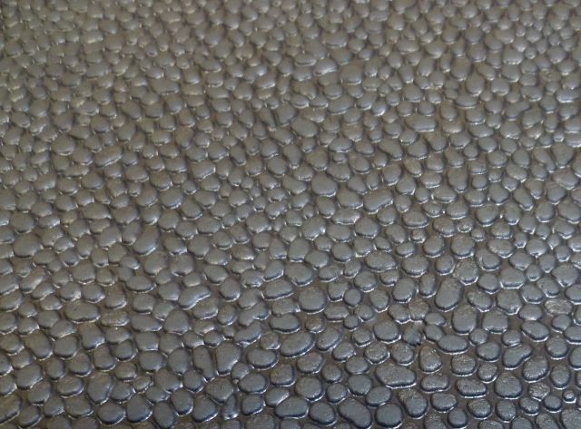

While the discussion morphs to other areas, I thought I would add the following as an opportunity for the original poster to find a "reasonably close" replacement for the floor mat. Using Google search I entered ...pebble finish rubber mat... the attached picture is one of the results of the search. While located in England, the material is probably available here in the US. Making a floor mat from this material would be pretty easy if one were to use the "center hump section of the front floor" and heat to CREATE the facsimile mat.

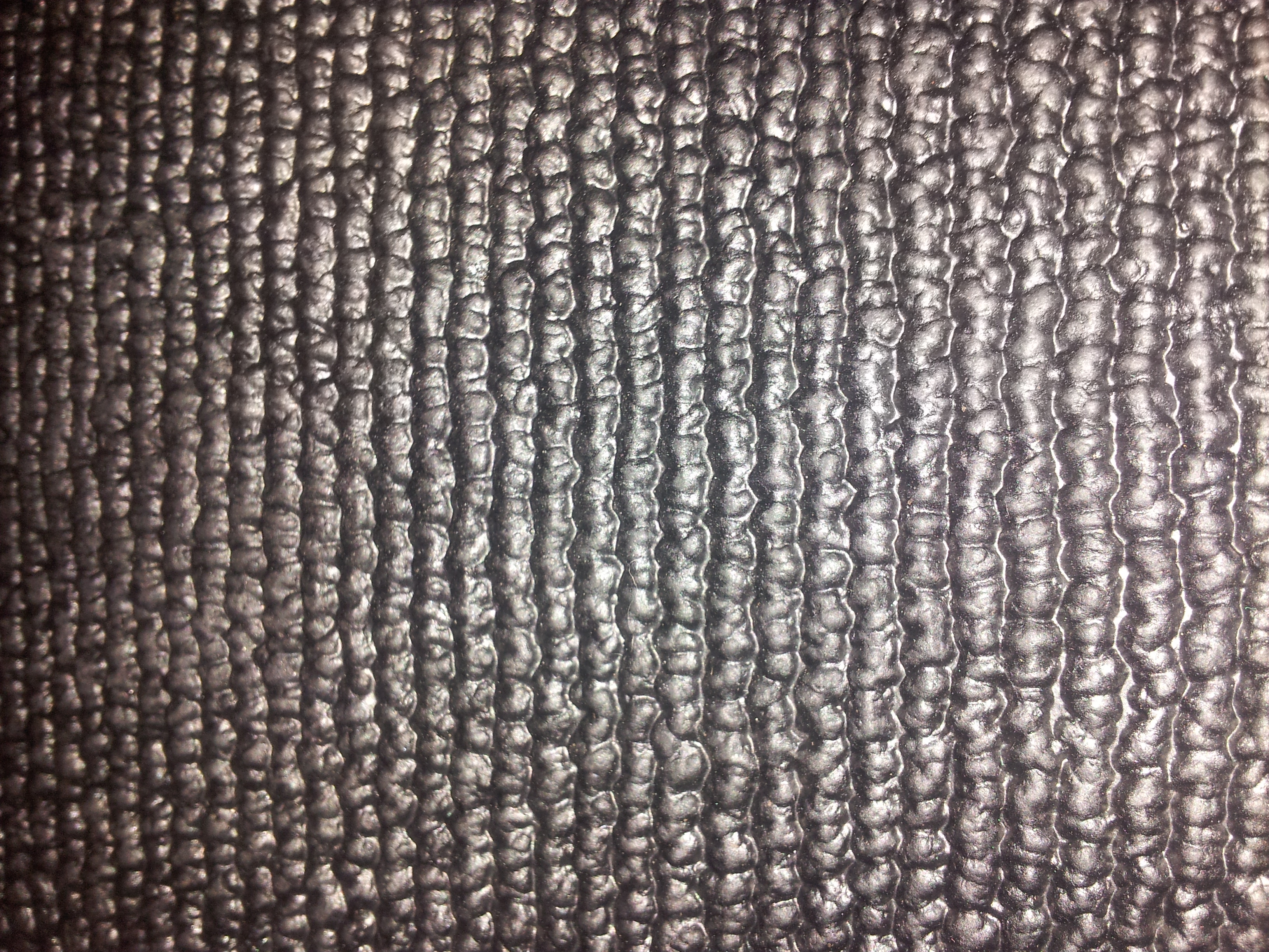

I just got this sample from http://www.restorationspecialties.com. It's called Carpet Tex/Pebble Grain and it looks to me like a reasonable match to the originals that John posted, having the same broken line look rather than a random pebble.
Now, I just need to figure out a way to add the lined areas...
