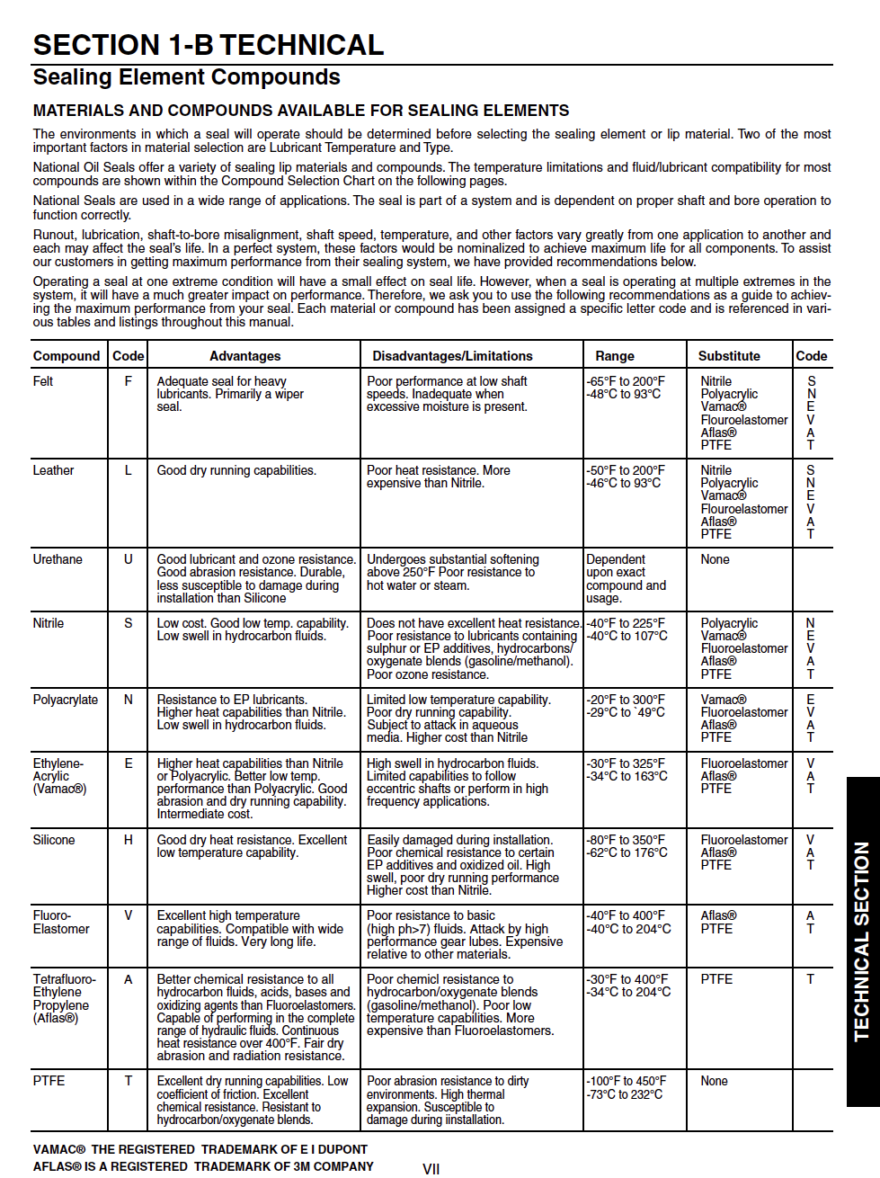

You can replace the old leather seal with a modern seal that uses nitrile instead of leather. National # 50151S. The S suffix indicates nitrile. About 8 bucks at O'reillys, cheaper on ebay.

Thanks Ken!I want to double check the National p/n with you though, because someone else told me it uses a National 340356.Michael0
Thanks Ken, for the clarification!0
