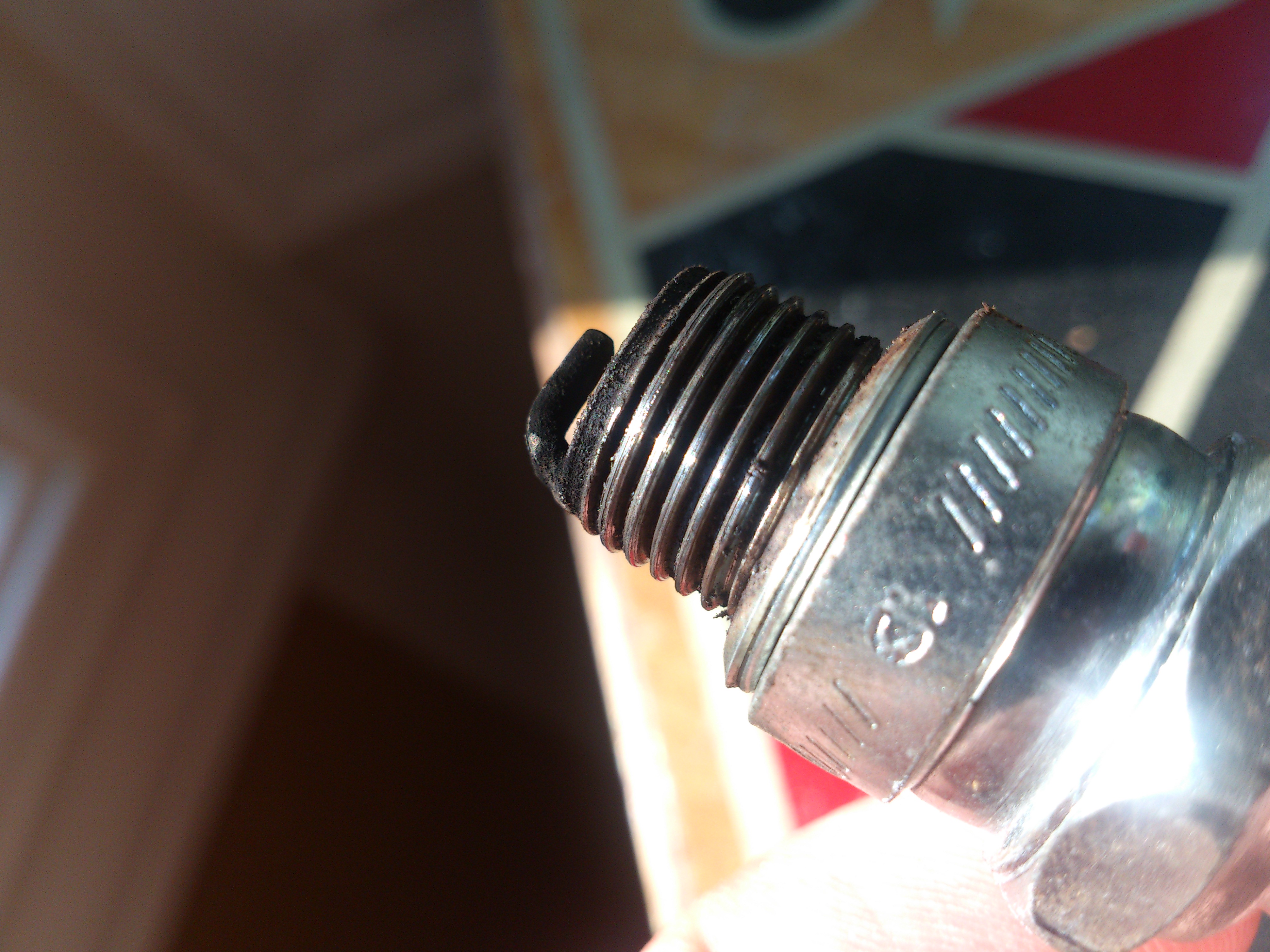

Russell,Its magnetic so iron. Here is a picture of the slightly buggered threads of spark plug. (I know its huge)Thanks againRay
The grease and string is a good idea. A second person holding a vacuum cleaner will also suck out a lot of muck. Barry0
