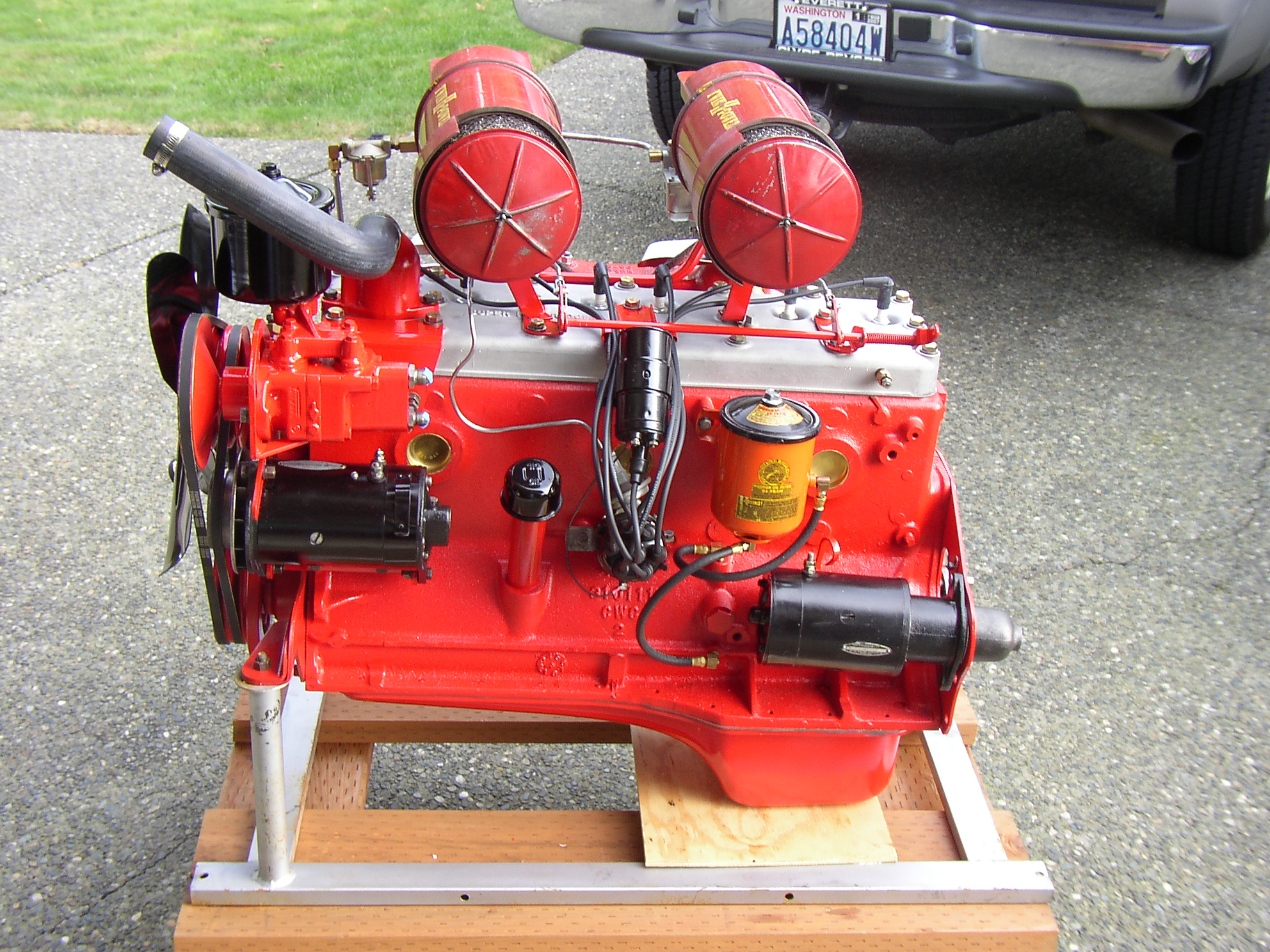

1951 hornet 308 and it had the filter on it already but I forgot how to plumb it after the engine got rebuilt0
I remember it as "Higher fitting on the can to the higher fitting on the block. Bottom fitting on the can to the bottom fitting on the block." As shown in pic above.
